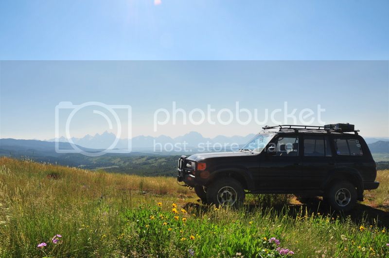

I dont have any good pictures. Just pictures of paces i have been. But it will give you a idea of how she sits.
This one is JUST 861/862. No spacers
