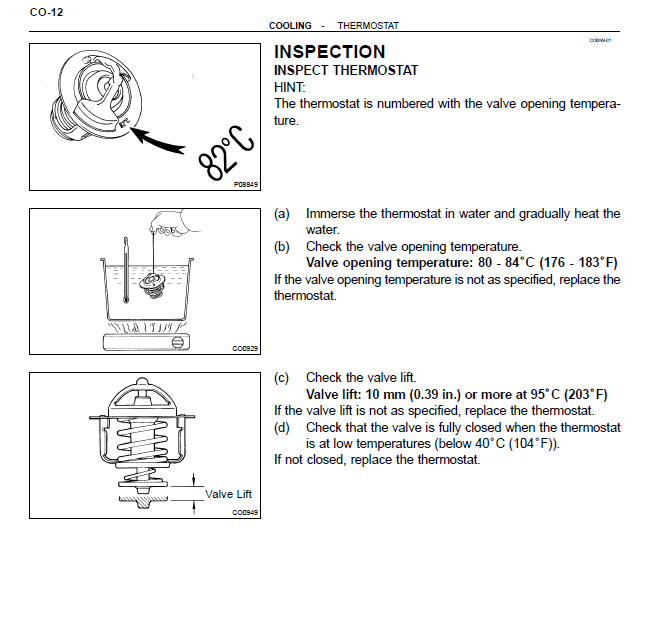

I just tested two thermostat in boiling water. One in a 07LC 172k miles opened 9mm, the other from my 01LC 168K miles opened only 8.5MM. My eyes and thermometer where not good enough to get a good "start" to open test result. I replaced both thermostat, which was a 5 minute job, probably worlds easiest vehicle to do. Neither engine ran hot, based on instrument panel cluster temp gauge. Both they were original thermostats' from factory. But I could certainly see if thermostat Not opening properly engine could run hot!

Thermostats had different parts numbers and price. 01 was ~$19, the 07 was ~$31. They look Identical and both 82C.
