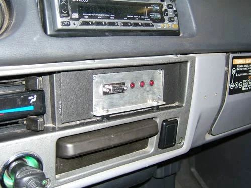

The LED lights mount into the ends of the metal box. They have little clips that hold them to the ends.

The FETs at the ends definitely need an Al case as a heat-sink. Some components generate a lot of heat, especially if you screw something up. Get a nice case, you need some bling on that stubby 60. :flipoff2:

I got a AL case from Frys. I just have to cut the holes in it for the plugs/lights and the bolts for the FET's..

If you were asking me, FETS are pretty easy to fry. They need proper heatsinking.
Be sure you use heat sink compound when you mount them to the case.
Got it, I found some ceamic?? Heat sink compound that is not glue. SUppose I git the right stuff?
The boys at Frys are not the greatest at helping..
I'm not familiar with that name. There are usually little tubes like the antisize compound comes in right near the CPU heat sinks. They are kind of like small ketchup packages. You don't need much, a layer as thick as a doubled piece of paper is fine.
