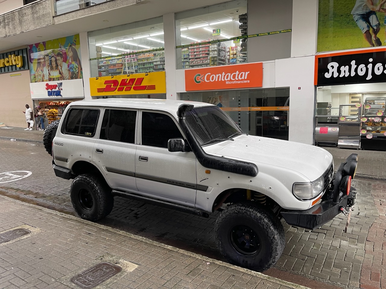

Just bought an 80-series in Colombia with a 4.5 gasoline engine. I plan to swap engine to diesel, with the main objective of maximum fuel efficiency, so I’ll go with whatever engine will give the best mpg.
So far options are an imported 1KZ and an imported 1HD-FT. The price is also a consideration as in Colombia the 1HD costs 3.5x the cost of the 1KZ. I want an efficient engine that doesn’t put out a lot of smoke.
This is all uncharted territory for me so any advise is welcome.
