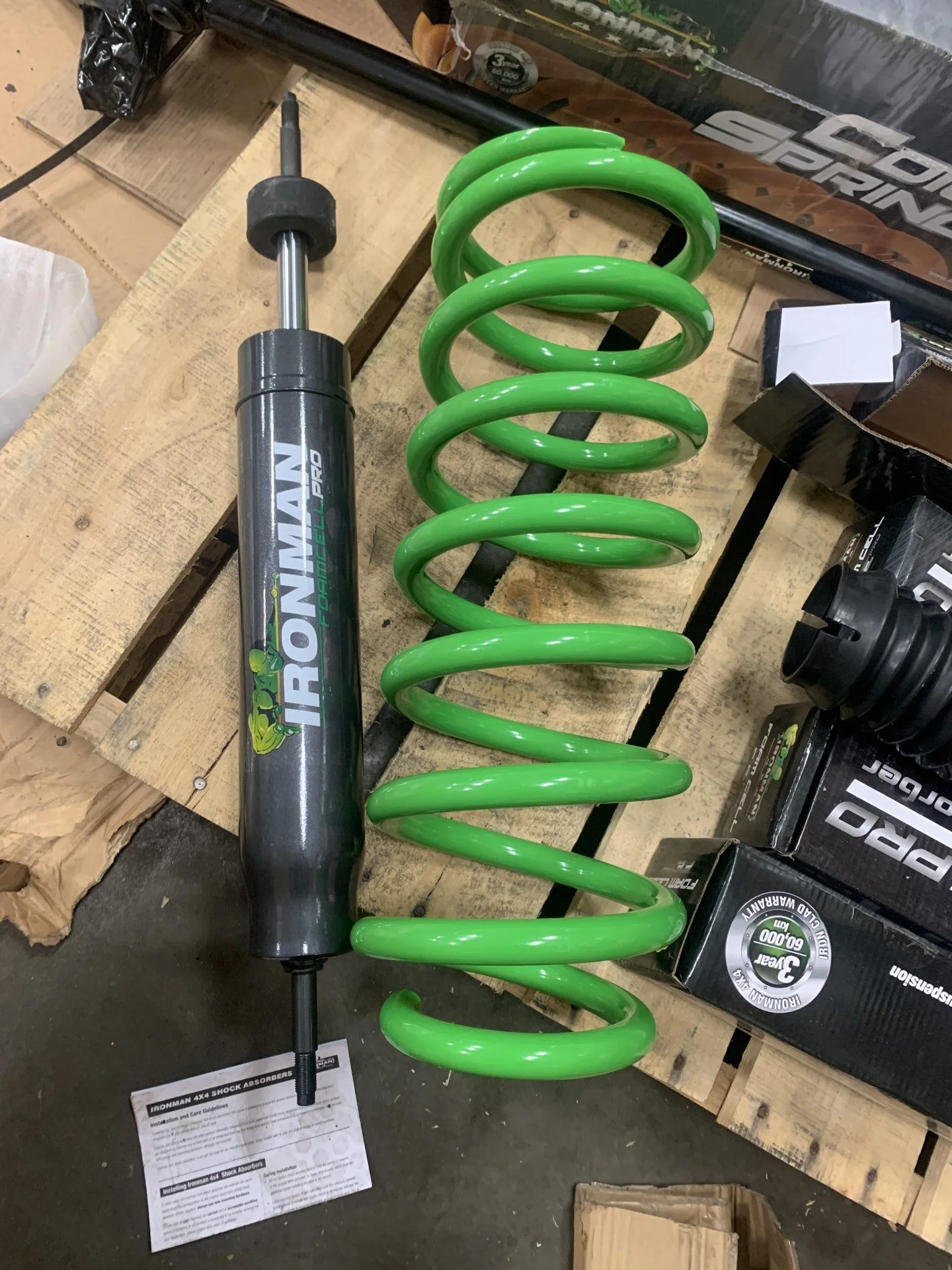

I received the kit along with all of the inventory that we ordered, and the first thing I noticed was the lime green springs. I did expect it, but can’t say it didn’t hurt my eyes. I personally hate lime green anything so that was the first thing to go. Personally I dislike their logo, colors, and look of most of their products.
Their foam cell pro lines look better than the more entry level kits, but still not “pretty”.

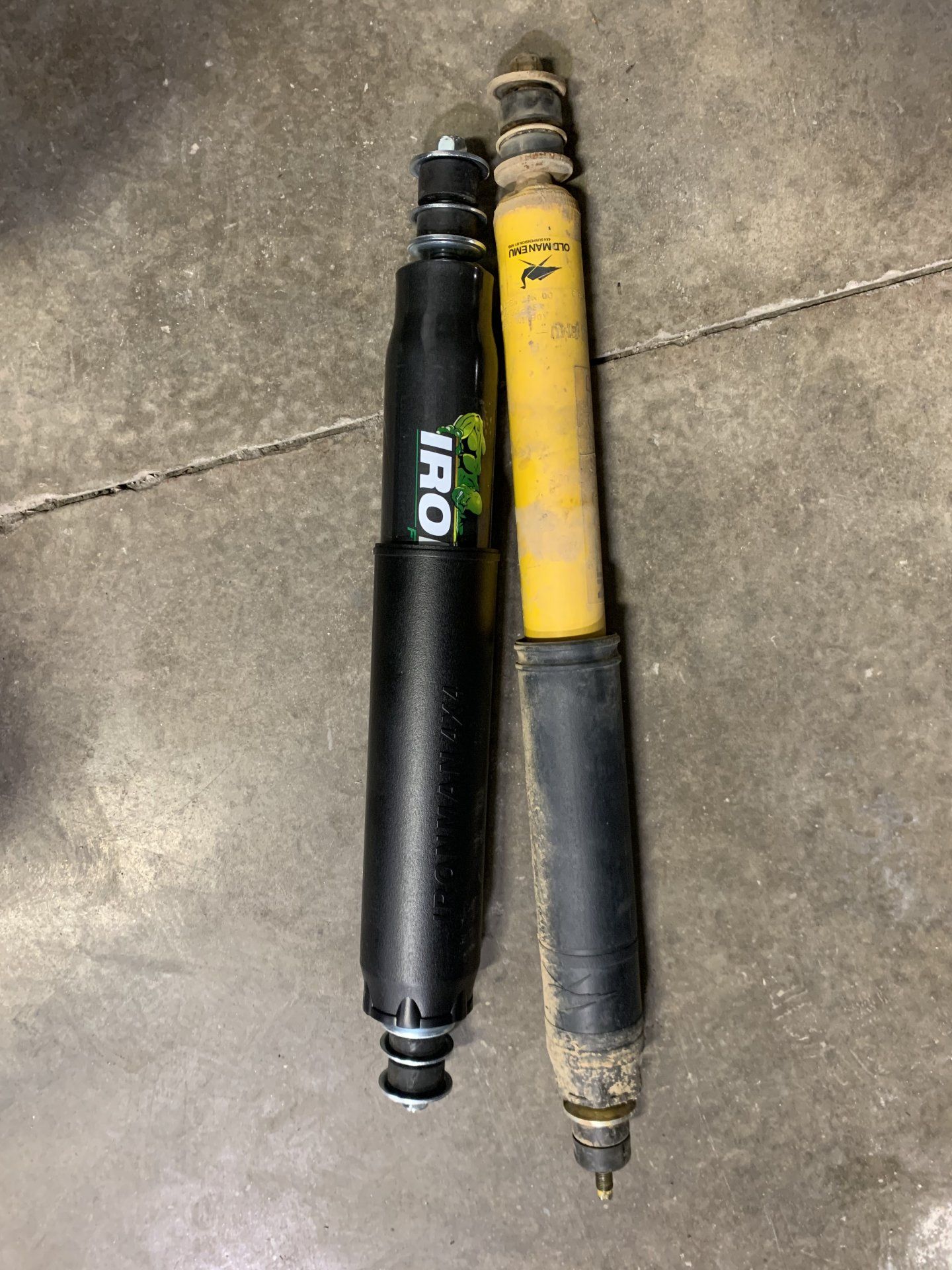

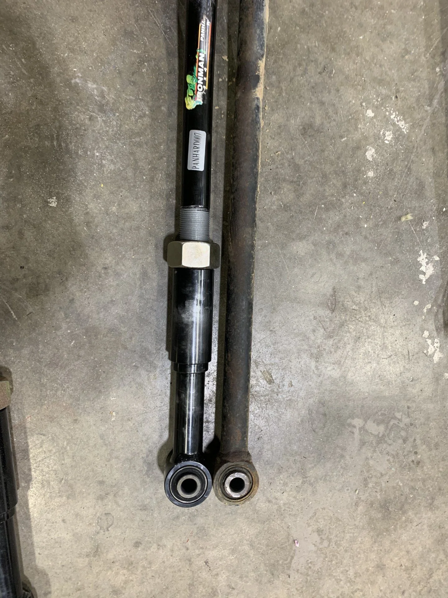

Other than the dislike of colors/ logos, I noticed just how large the shocks are. They are massive. The pan hard bar and track bars are very beefy. The threaded portion feels great, no sticky spots in the threads, and the powder coating looks pretty darn good as well.

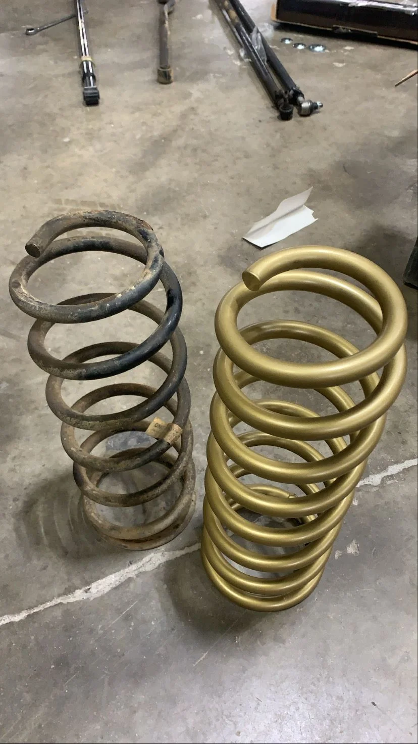

But that gave me time to get the springs powder coated to a different color.
That’s much better in my opinion.

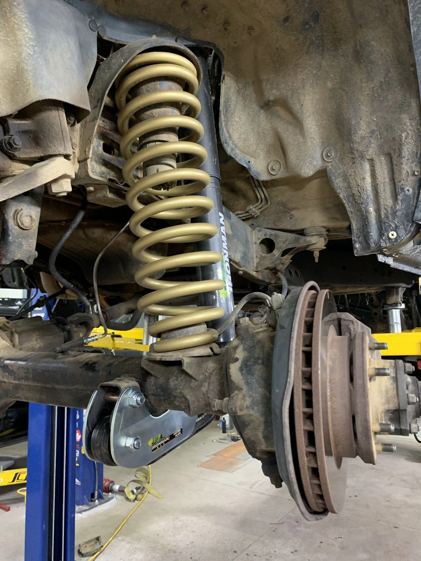

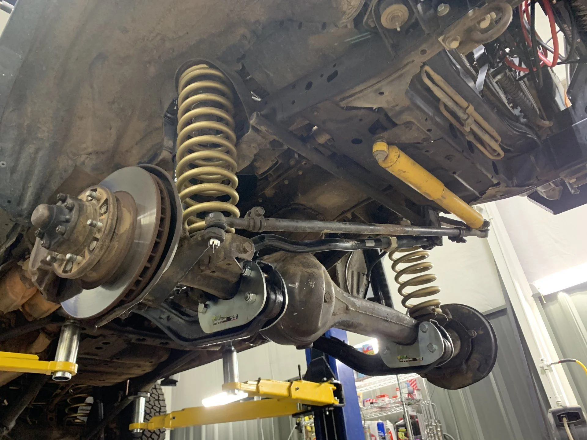

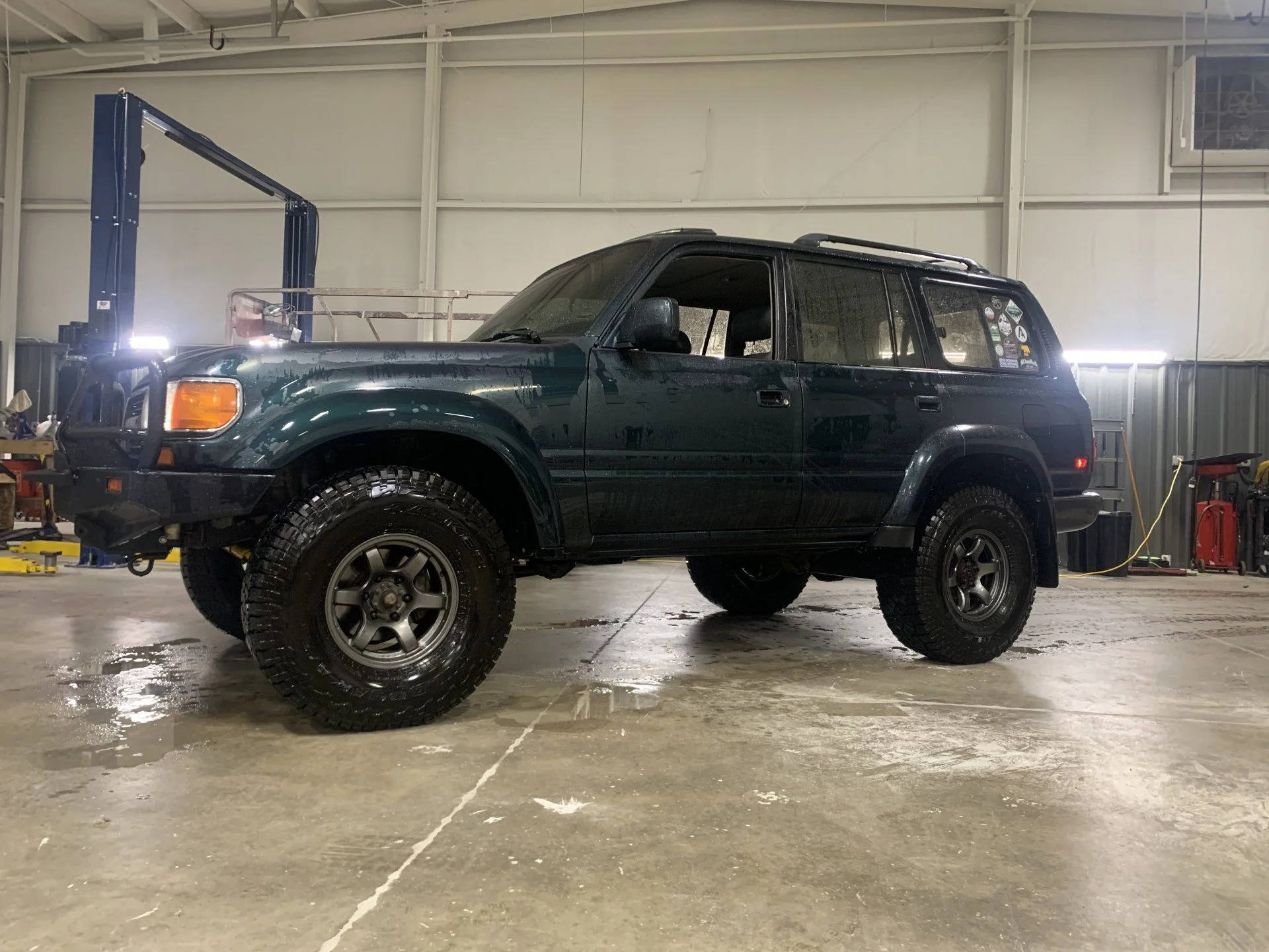

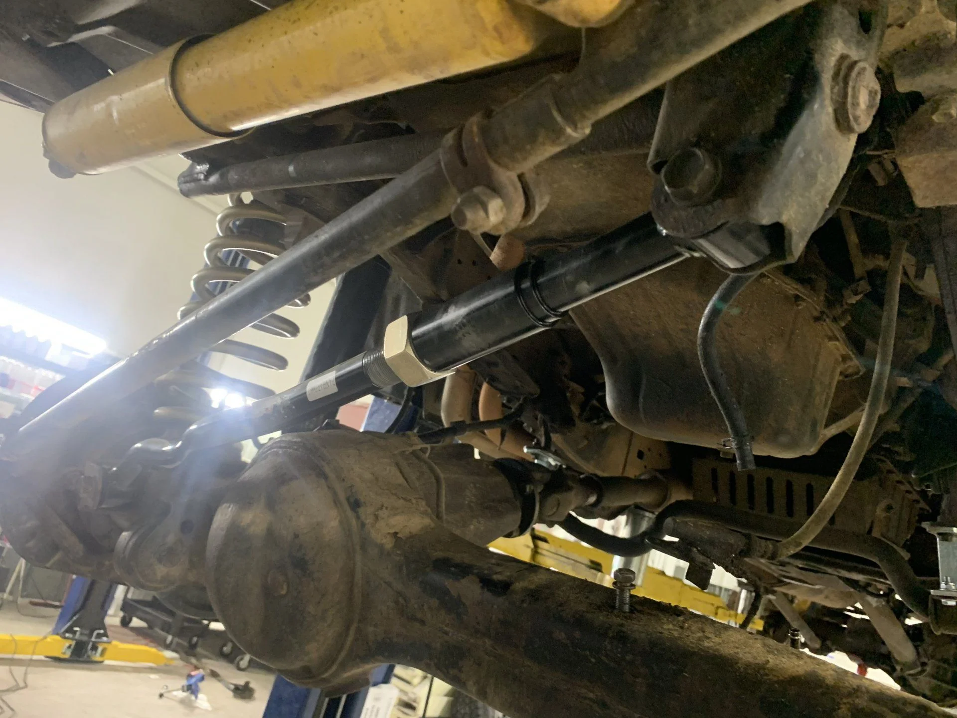

Now here’s some pictures of the install. I took of a OME 2.5 850-860 lift set up.

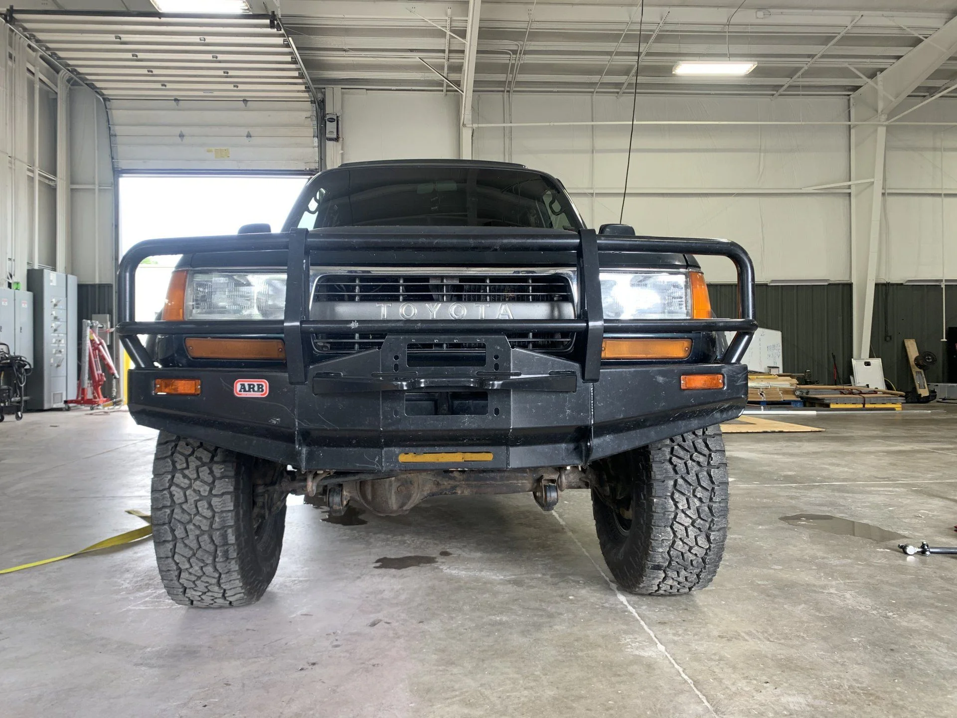

before picture of the OME 2.5 with 315/75/16 Falkens.
Front
More in the next comment. New to posting on ih8mud.

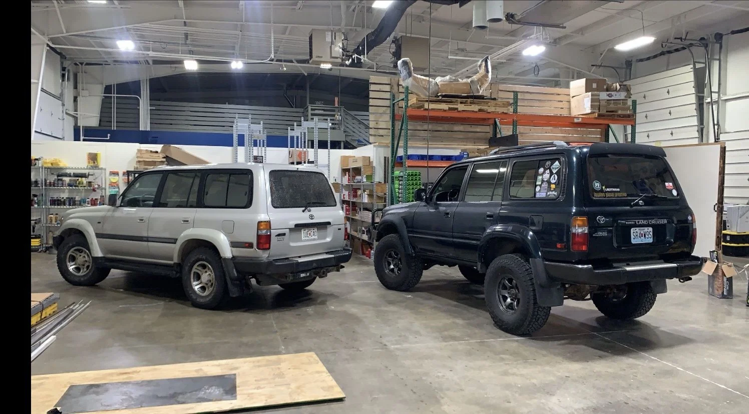

After the install is all said and done I didn’t think it really got much taller. I backed it off the lift, and stood back to look at it and then it really showed it’s height increase.

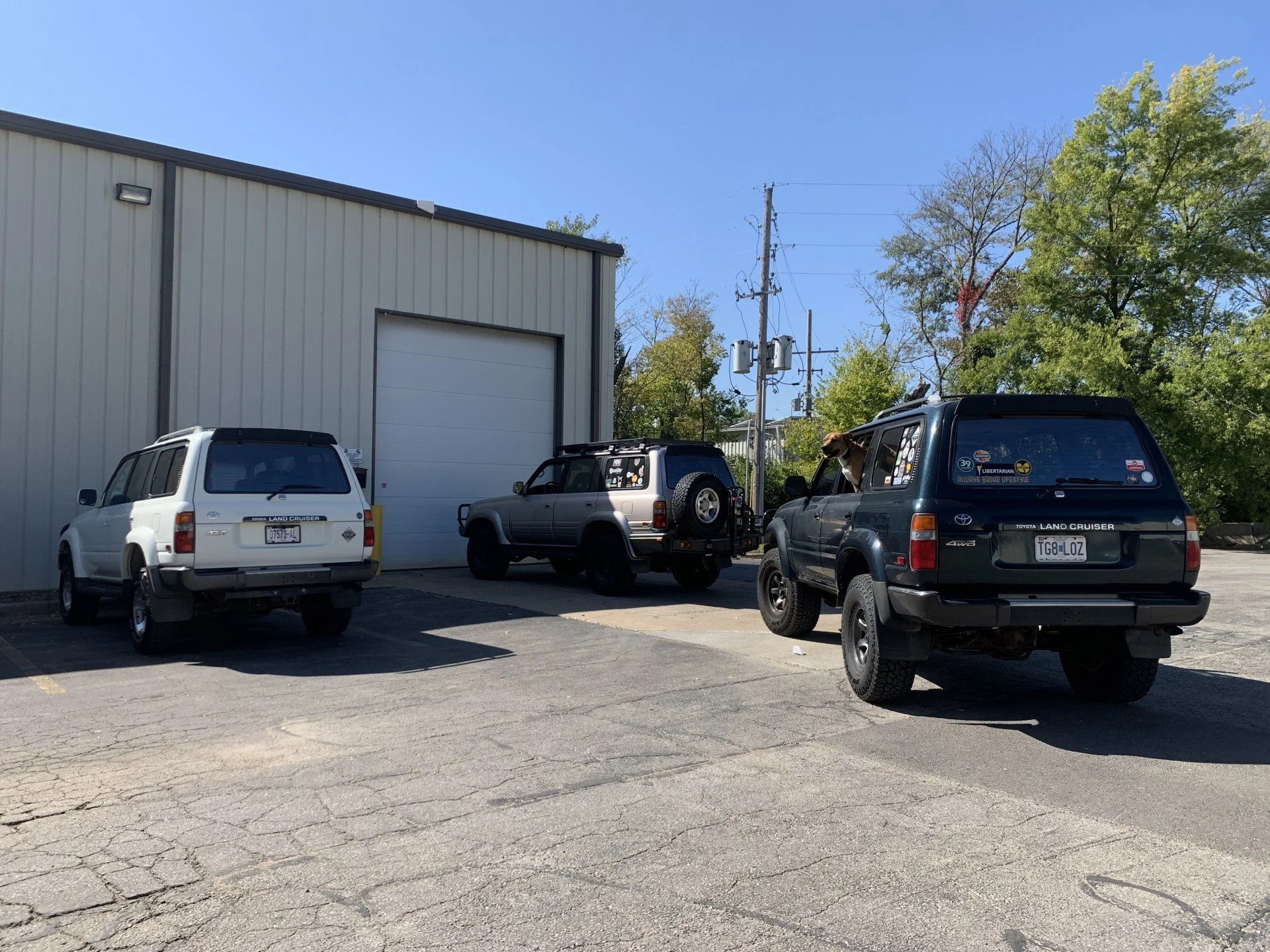

And one picture of a bone stock 97 collectors edition sitting on 285s my co worker just picked up.

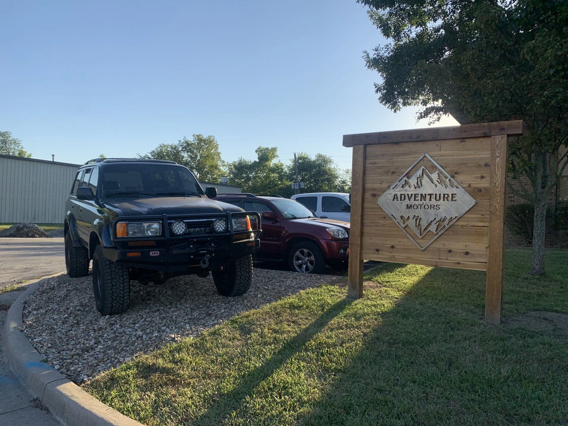

As for the 7” pods, I’m actually pretty impressed with the quality. Metal housing, with a good dark metallic grey powder coating, and a good weight to them. Their wiring harness is pretty trash honestly, and I didn’t even want to install it so I found another harness and used that instead. Other than the harness I actually really like the lights.

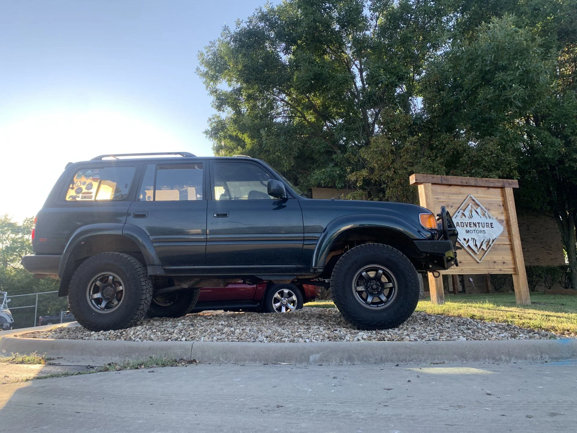

Here’s a picture of the finished product:
I installed all of this a week ago today, and finally have had some time to get some daily driving miles on it. It rides way better than the OME. The height is pretty stinkin tall, but it feels very stable, and doesn’t feel like it rolls too hard in the corners. The braking also feels very good. The nose barely dips under heavy braking, it’s an almost weird feeling. Slam on the brakes and you still stop hard, but your rig stays almost completely level.
The smaller bumps, like potholes, still give a little bit of a shock, but still a little softer than OME. When you hit big bumps, or bouncy roads it really rides much better. I found a small “jump” near our shop, and really wanted to see how it handled it. First time over the “jump”and we were blown away. The landing felt awesome. Now I’m only talking like 5-6” of air, but still, it’s a 5000lb suv. It was a very soft, almost cushy landing, and I couldn’t help but go back and take it a little faster. I couldn’t be happier with the quality of the ride this kit offers. I haven’t got it out to the Ozarks yet, but will be there next month, and I will be Really getting to test how it handles that. But I wanted to write this because I only found a couple pictures, or reviews, or opinions on this kit, and if you are interested, or have questions I’d be glad to give you an honest take.

Kenny, Thanks for the info. LX in the third picture looks like mine. Do you know how much lift the LX in your picture has? My avatar picture is out of date. I have added sliders and rear swing out. Looking at the Dobinson 3.5" lift also.
That one has the Dobinson 2.5” with OME heavys in the rear. It’s the smoothest riding cruiser I’ve ever driven.

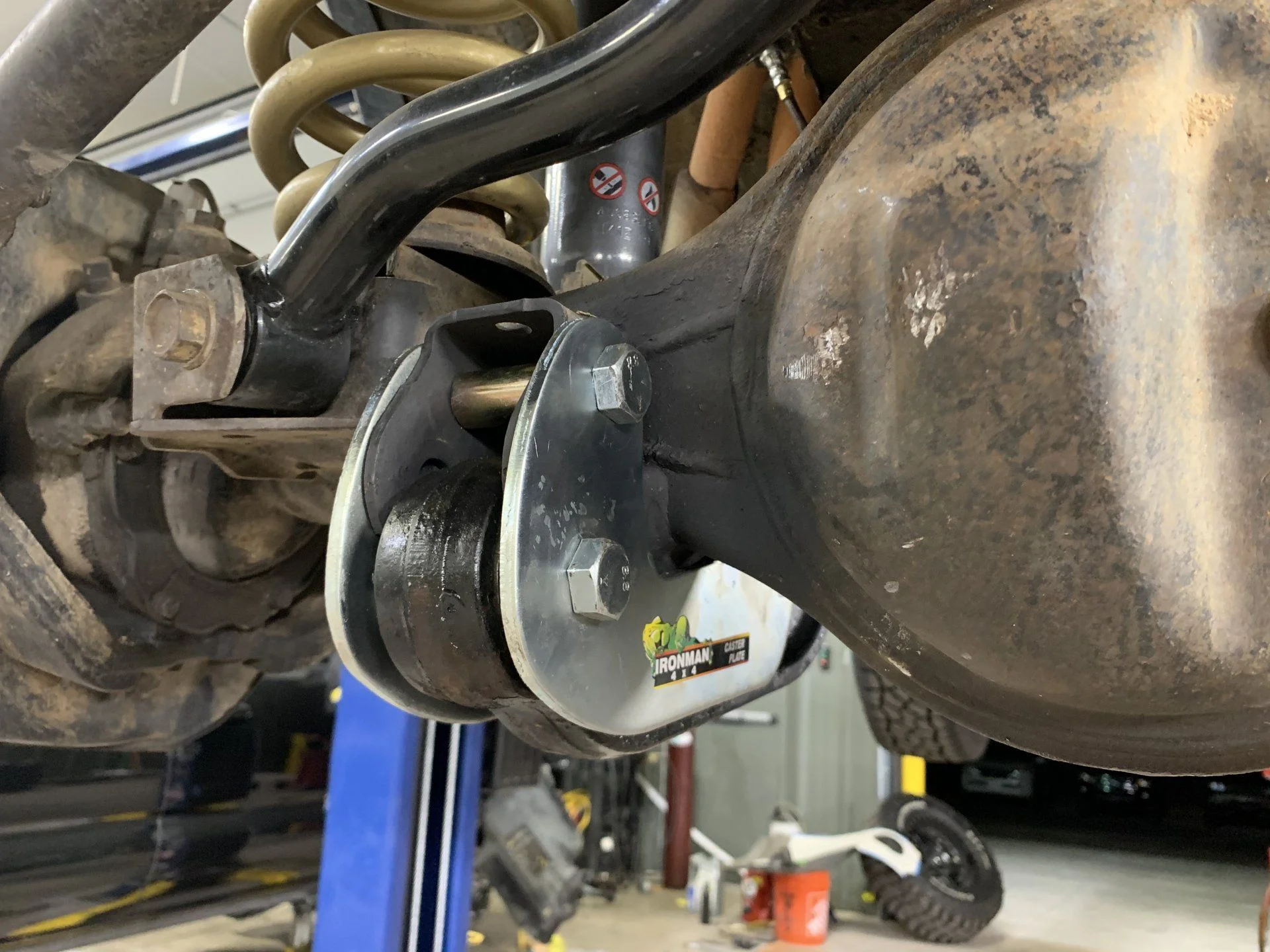

Installed the Ironman 4x4 5 degree caster plates, with new OE Toyota control arm bushings, new stainless brake lines, and 555 tie rod ends with a new tie rod. Took about 3.5 hours, everything went really smoothly. Hopefully aligning it tomorrow. Now my list of things to get done is. Diff breathers, oil change, and my DC front driveshaft should be on the way. Is anyone else going to Rendezvous in the Ozarks?

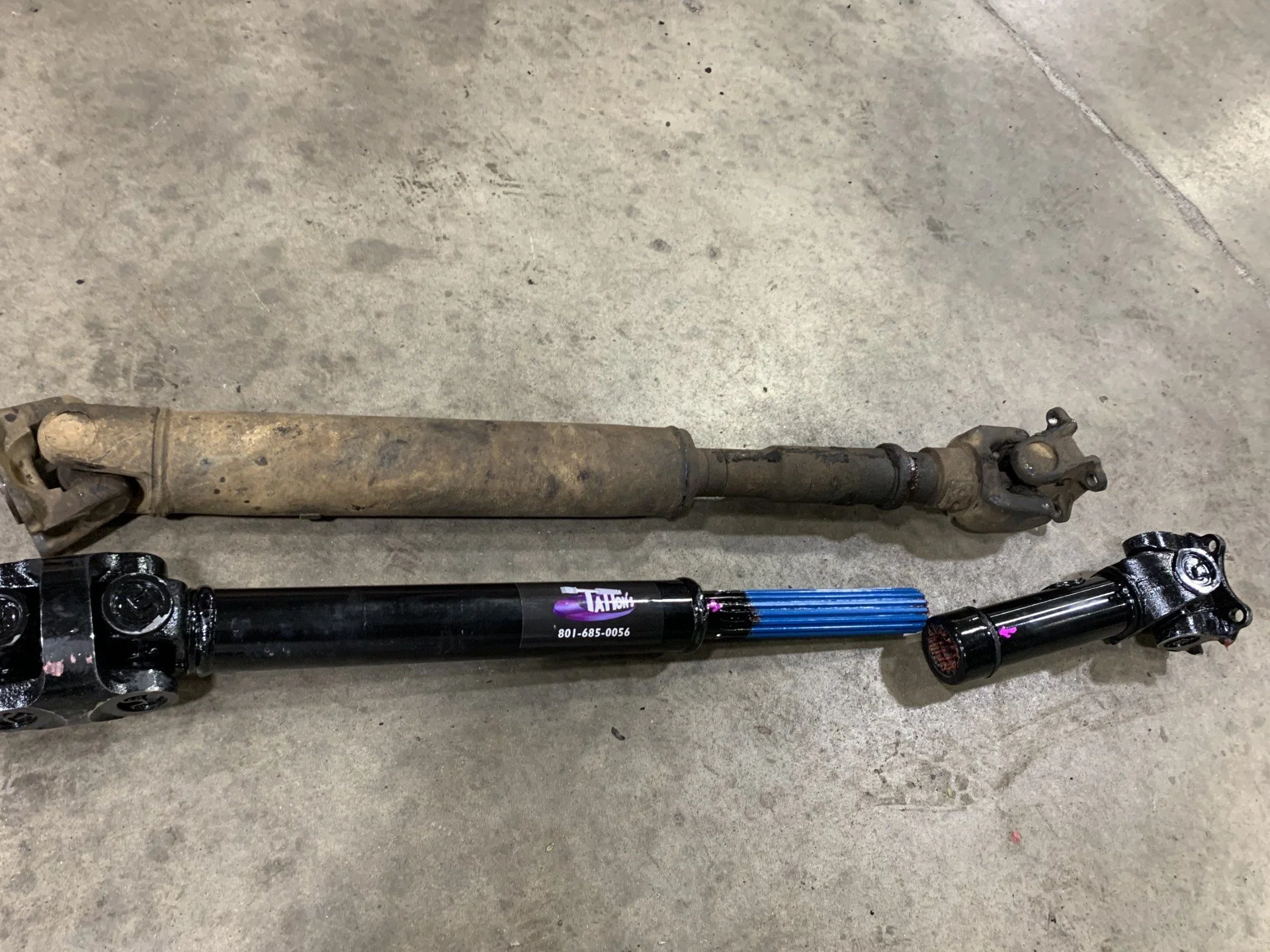

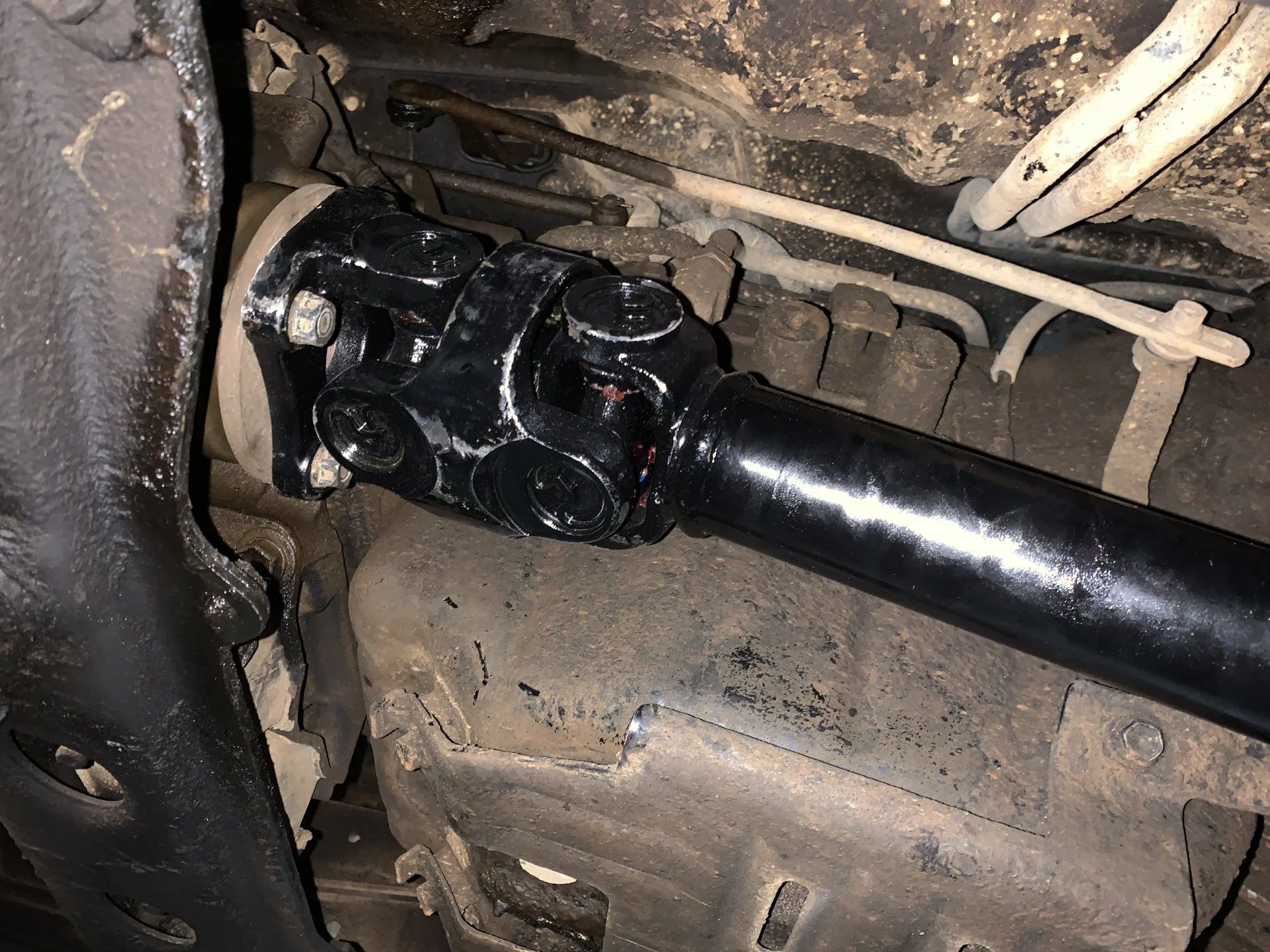

Got the DC driveshaft installed tonight. Still have the noise that to me sounds like driveline. Swapped rear driveshafts with a co workers, and same noise on both mine and his. He’s on the Dobinsons 2.5” so not making a lot of sense to me why we have the same exact noise. I joints are good, I just rebuilt his T case, but again same noise. Any ideas?
But now my list is down to diff breathers, bleeding the brakes again, and picking up a sleeping platform for me and my wife to use while camping this fall/winter.
