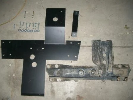

Iron Pig Off Road Skid Plate install

Stock transmission cross member and transfer case skid plate = 16lbs.
IPOR skid plate = 54lbs.
Ground clearance with OME 2.5 Heavy and 305-70-16 MTRs (~33in tires)
Stock transmission cross member and skid plate = ~15 inches
IPOR skid plate = ~16.5 inches (the portion of new plate under the transfer does drop to about equal to stock)

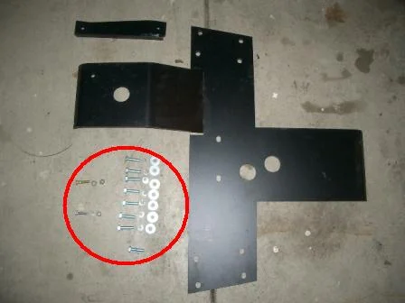

No additional hardware necessary – everything was included

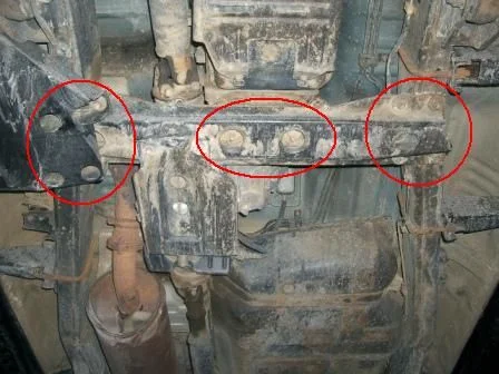

Step two
BE CAREFUL!!!
Unbolt the two transmission mount nuts (17mm deep socket).
Loosen cross member bolts (14mm socket) 4 each side, 8 total.
Do not remove cross member bolts at this time!

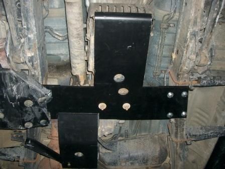

Step four
BE CAREFUL!!!
With transmission properly supported remove cross member bolts.
Warning, the transmission will no longer be completely secure during and after this step!

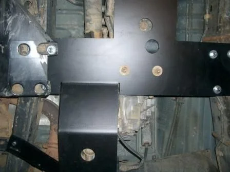

Step five
BE CAREFUL!!!
Remove old cross member and skid plate and replace with IPOR skid plate.
The sliders should be drooped enough to allow you to slide the new plate in.
Step six
BE CAREFUL!!!
With provided hardware, bolt new plate to frame (17mm socket) 4 each side, 8 total. Remember not to tighten the bolts until all are in place. This is the part where you can use the [Ball peen Hammer] to align the holes. You will also need to leave the slider off until you have all bolts in place.
Reinstall the two transmission mount nuts (17mm deep socket).
Tighten all the bolts.
Step seven if you have sliders, otherwise skip and move on to step eight.
BE CAREFUL!!!
After all the bolts are in place, and the transmission still supported as described in step one, you should remove the skid plate bolts on the Passenger side (US model).
Lift sliders (with a catalytic converter skid plate) up and reinstall bolts to frame (17mm socket).
Reinstall slider U-bolts to frame (3/4” wrench, 3/4" socket) and tighten.
Step eight
BE CAREFUL!!!
Install provided skid plate bracket/arm to existing capture nut on frame (13mm socket) with new hardware.
Install provided hardware to bolt skid plate bracket/arm to skid plate (14mm socket, 14 wrench).

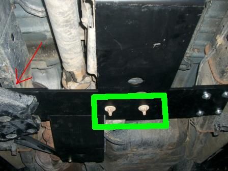

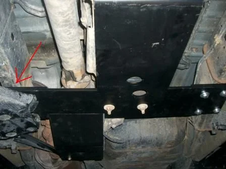

okay. done. great write up. installed mine last night. the skidplate weighs a TON. it was so easy with two people. if that falls on your head you are in deep s***.
also, side note...
these bolts should be trimmed. they are now exposed and they werent by the factory cross member. they will indeed get mangled.

Congrats, and thanks. Yeah, I went back and trimmed off the bolt up to the start of the threads. In addition, I have been meaning to post a recommended step in the installation.
If you have a stock trans skid plate (I believe on the A440F only), then you should remove it prior to installing the IPOR plate.
I had issues with it barely touching under load, and it would send a vibration throughout the entire rig. Removed it and all is quiet.

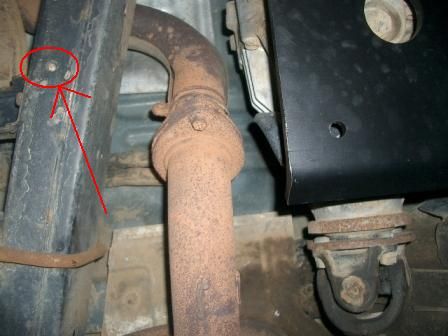

because of the way my exhaust is routed over the frame i cant get the supporting leg installed for the transfer case "tail" that hangs off the back... is the best step to drill and tap the frame so there is a better location for it?
I'm guessing that you have a custom exhaust set up, which is good. Can that arm can reach the frame flat at another angle? If so, then yes your best bet is to drill and tap another hole. This may give you a better size bolt to use, the existing frame hole size would be nice if it was a little larger.
