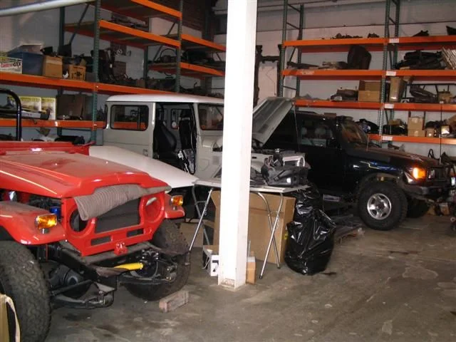

and the fun stuff. there was lots to look at in the shop, but yet another so many parts and so few dollars scenario. it was a long haul from central NC but a beautiful drive as far as foliage goes, next time hopefully a day of driving will yeild a weekend of wheeling!

just so you know the type of things they are up to, theres a pig gettin 80 axles, another goin w/ the 2UZ-FE s/c, some resto projects, a SAS taco, and the pig on thelift is getting full drivetrain from a 'burb ( dana 60/70, 350, tranny etc) and the staff was busy but cool enought to let us poke around and provide some 80's minded input.

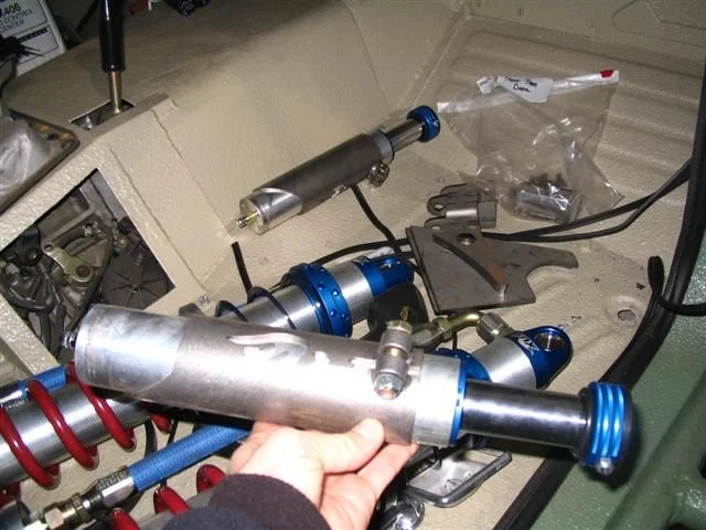

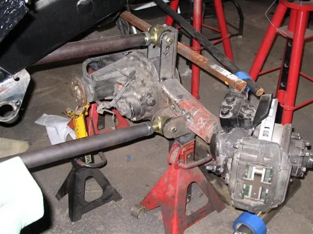

Hey my pig is famous. That is my green and white 55. It is getting 80 axles, a supercharged 2UZFE, Lexus LX470 transmission and FZJ80 Transfer Case. Lance and Cam are good people, and they are very lenient allowing me to do what ever I want with the truck. In that picture, I am working on the 3 link, since the leafs don't work with the steering on the 80 axles. Lance really does have some great ideas. So if you have any projects hit him up.

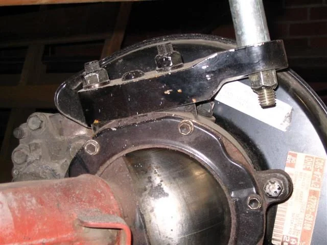

I was looking at that. Who makes the high steer knuckle arms? Also, nice shocks and bumpstops. You are doing it up right. Very nice.......if you don't mind i snapped a few pics for ideas. :idea:

Cool. The high steer knuckles were done by OTT industries in Canada. The arms turned out great, but they aren't making them any longer. Besides the wait was over 6 months. I am going to work on the 55 all day tomorrow so I should have the 3 link finished and flexed out. I need to come up with some way to mount the shocks and bumpstops, but that is another days project.
