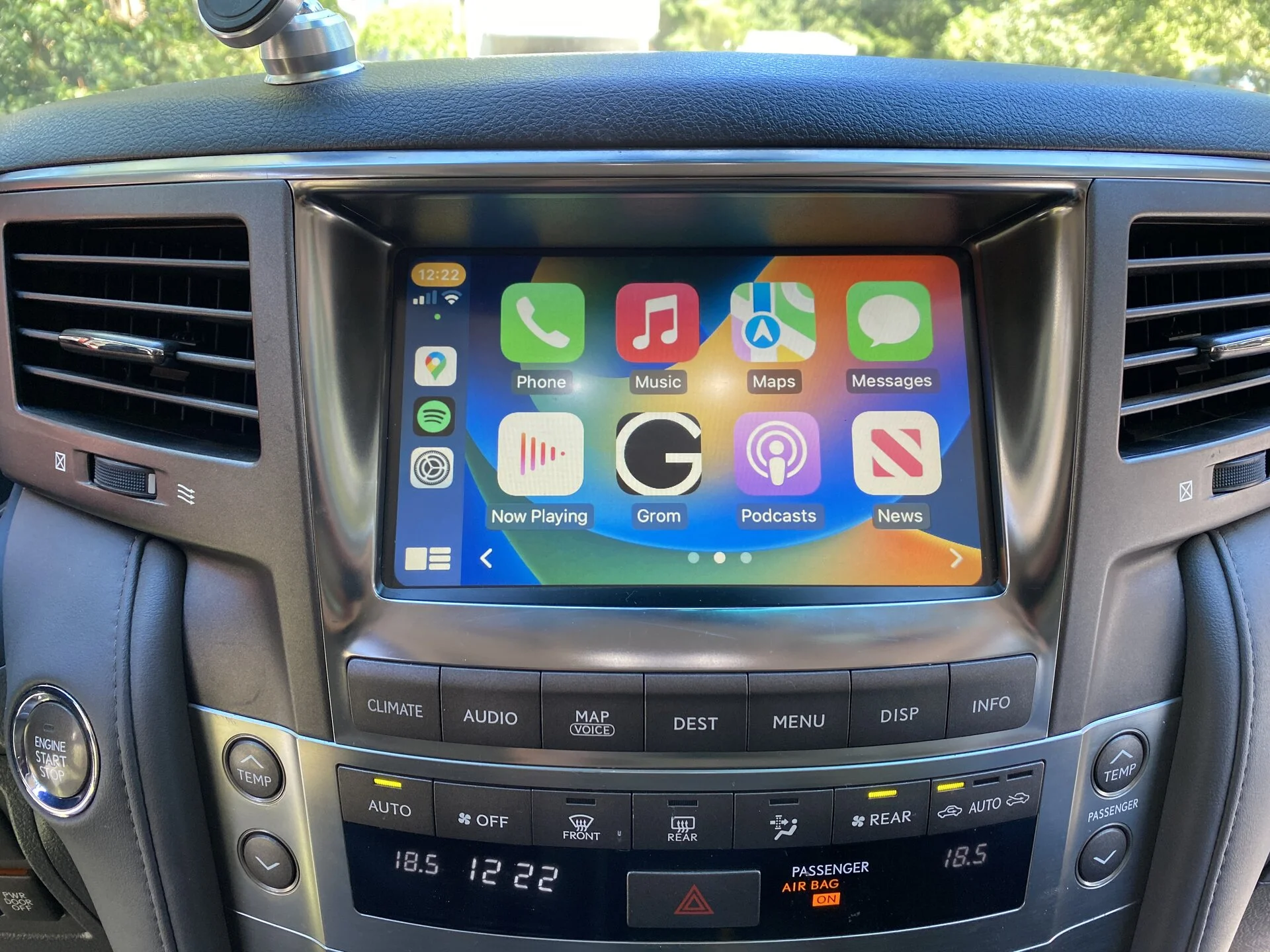

I love my grom vline, it's been rock solid and totally improved user experience of driving a truck with 2008-era tech. As others pointed out, glance-ability is super important to keep you out of the ditch. I wouldn't personally consider a hard mounted ipad as a replacement.

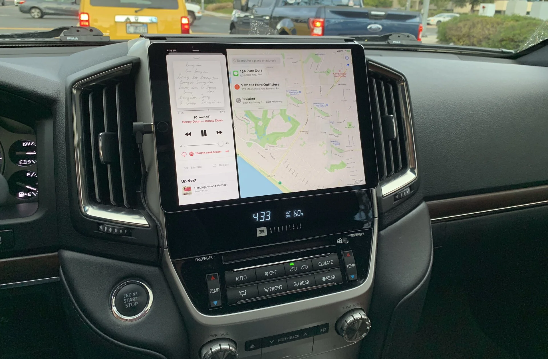

I used the iPad Pro with cellular over the screen with magnetic case and magnetic charging. Splitscreen with maps and musing plus layover iMessage, WiFi calling, etc. I did this for a few years and while the capabilities were the best, 3 things made me shift. First in summer days the iPad would get too hot and go to sleep. 2nd, magnetic usb c chargers tend to fade and had to replace several times, eventually the item was discontinued. Lastly, backing up and making use of the camera while off-roading was also an Inconvenience having to flip over the iPad to view the stock screen, same with adjusting settings like a/c…
I would also pick beatsonic to integrate, but I was never sold on that option because I still would like to for example have the truck on 4Lo with the cameras on and view the trail on X at the same time…

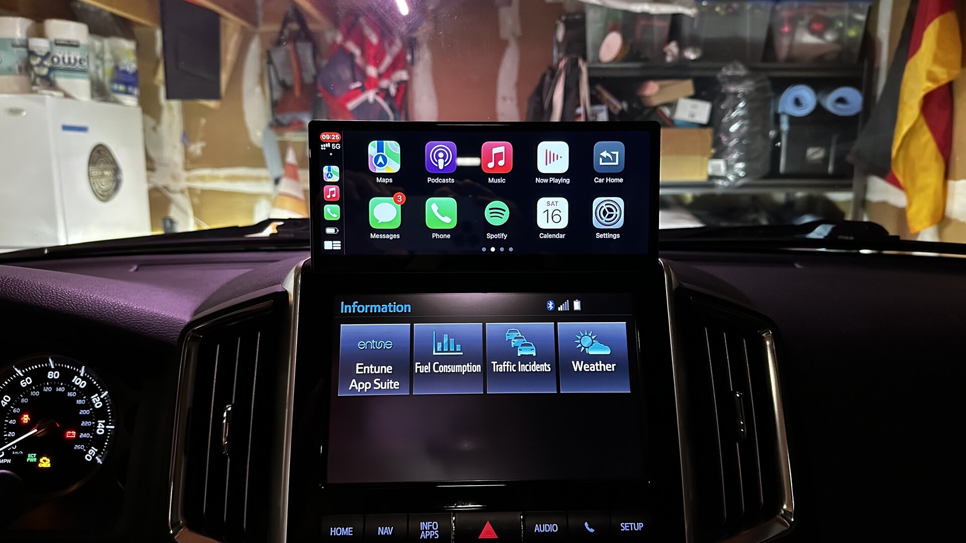

inspired by the LX600 dual screen I went with the Roadtop unit and never looked back…
here is my old iPad setup

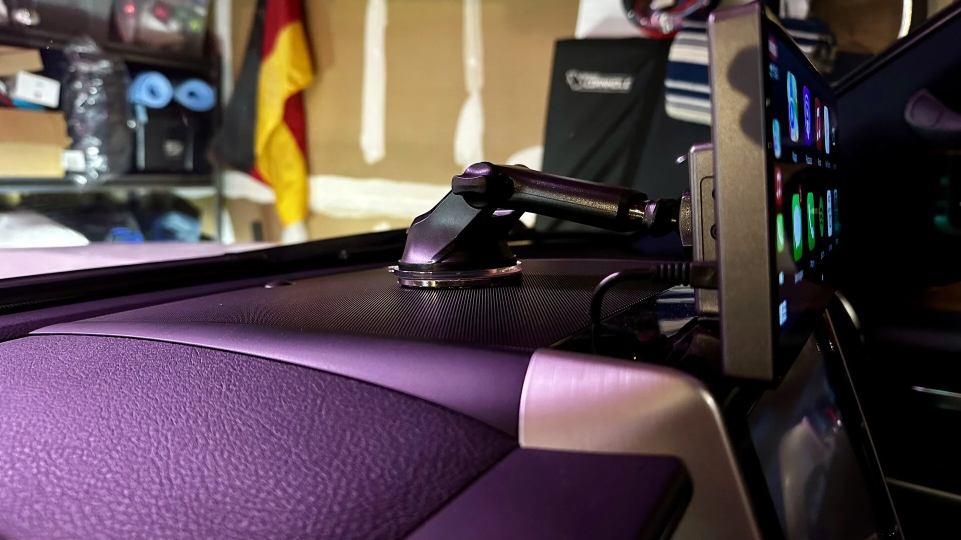

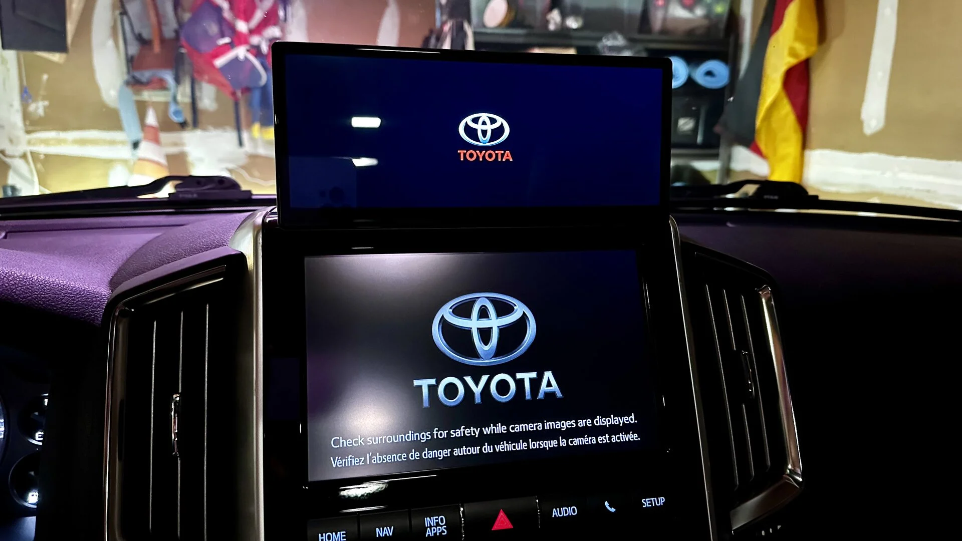

here is Roadtop… I’m on 2nd gen now… routed the cable through the speaker grill and had it connected to a switch…
8.9” but 8.8” works just fine… 8.9” has a faster processor, fanless smaller bezels and better screen and no speaker. There is a full thread about these…
I had the switch installed by an auto sound place, $80. The switch is next to the camera switch… I routed the cable myself, it’s pretty easy following any YouTube on how to breakdown the pieces.
The important setup element is to connect the phone to the Land Cruiser and to the RT, do t connect the RT to the LC… the only defect you may find is that some times the sound does not come to the LC, just pause and play with the LC switch and the music will play normally… phone call work flawlesly this way because it’s handled by the Land Cruiser but you get to also control the from CarPlay.
