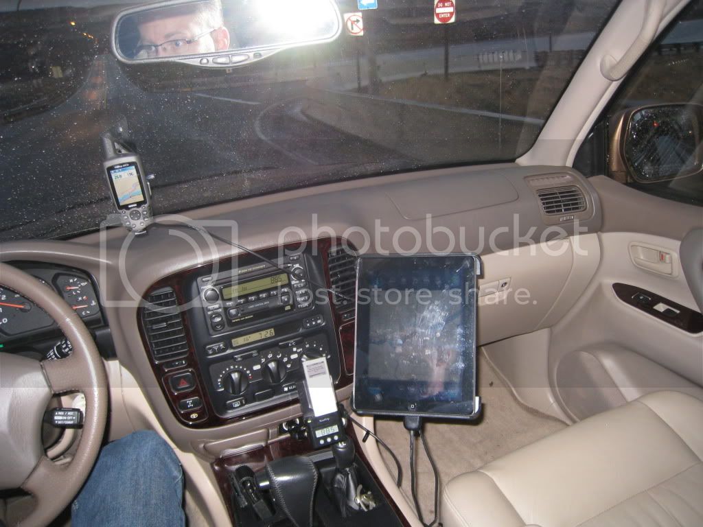

Like a lot of people, I have been looking for the perfect Ipad holder. I may not have it quite yet (needs to be tested), but I am close. I may need to add a support on the underside of the console.

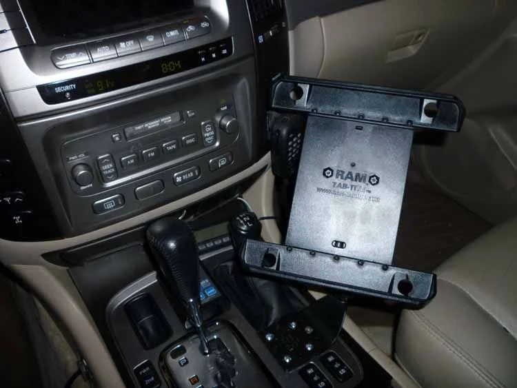

I was familiar with RAM Mounts and PRO-CLIP and after researching between the two went for the RAM Tab Tite

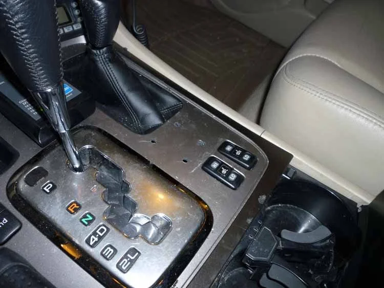

The best place I saw to mount it was the center console, but the setup with the round base and 4" shaft jsut wouldn't work. So I went through their components and put together what I thought would work
I went for the angled bracket with the ball to the far right

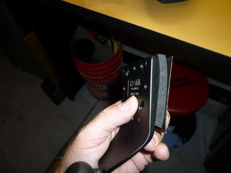

I bought a black beer coozie and cut it to fit the bottom of the bracket. Figured that would help conform to the center console and then I drilled the holes after getting it where I wanted
I also went for the extended arm (6")

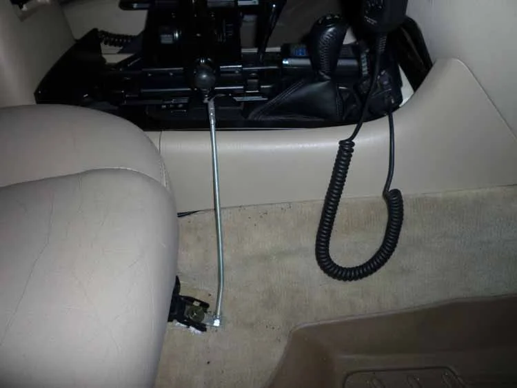

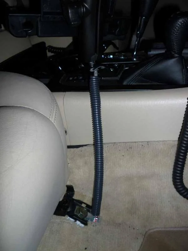

Because there isnt a lot of support in that part of the center console, I wanted to add a support arm
I went to the hardware store and got a 1/4" threaded pole
Made a bracket to bolt to the seat bolt, bent the bar and cut to fit
I at first was going to attach it to the RAM Mount with a bracket, but thought I would try JB Weld first as it could look cleaner
Then put some black insulation on the outside
I'll clean it up a bit more, but the placement is perfect
Easy access and does not get in the way of anything or the passenger. In fact, it can be swivled so the passenger can use it easily.
All thats left is to test it on a trail
I may still work on adding some more support. I'll have to play with it a for a while

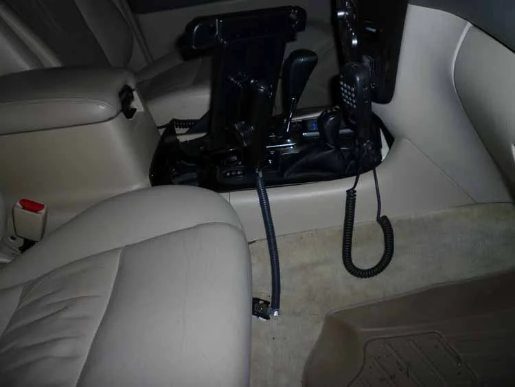

I suppose I could have. The only vibration I have noticed is above the ball in to the tablet holder, meaning the mount is stable.
I forgot to provide an update to this. The mount worked perfectly and barely moved during our 5 day expedition through White Rim, Elephant Hill (at night) through Beef Basin and then up to the Doll House and out crossing the dirty devil.
We had a break down and I was towing someone out and back to civilization, when we hit pavement, my passenger (nakman) swiveled the ipad around so he could surf the internet. It wasn't in his way at any time.
Like mentioned above, the only thing I would do differently is take the main bracket and look at mounting it on the side of the console rather than the top, making sure the ball is at the same point height wise. They way I did it worked fine too, so not a big deal.

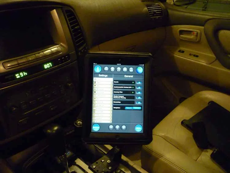

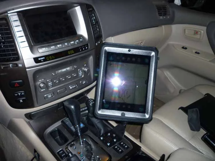

I need to go out and take some more pics.[/STRIKE] It's actually a combo of ProFit and RAM. The ram mount attaches to the ProFit bracket and can swing over almost to the center. It can also pivot to the right in case I have a rider/navigator.
The one downside is that it's slightly bouncy. Not objectionably so and it doesn't affect one's ability to either read the map or touch the controls. It's just not rock solid.
Edit: Pics
Mounting detail:
Moved to the center. Note that I have the 3" arm. RAM also has a 6" arm that would move it closer to the driver. Not really needed IMO. You can see how close it is to the shifter. Easily at fingertip reach.
Adjusted for pax/navigator
