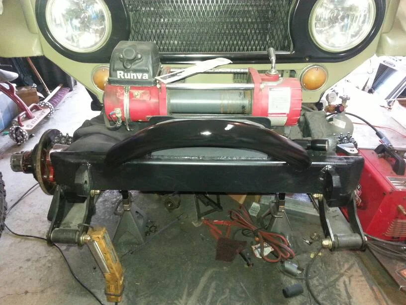

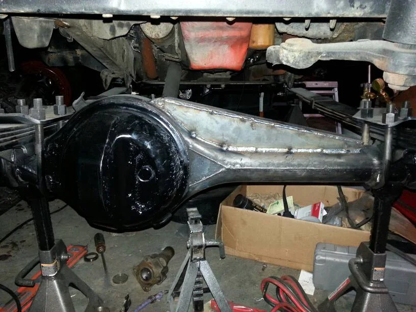

I was able to weld up the front and rear trusses along with the rear antiwrap mount (RockTactics integrated into the truss).
I didn't have the opportunity to pretty the up as I killed my grinder, but I'm providing a pic anyhow.
I also fabbed up a quick front armor piece for the ring gear using the front of an axle housing and some 2x1/4 scrap.

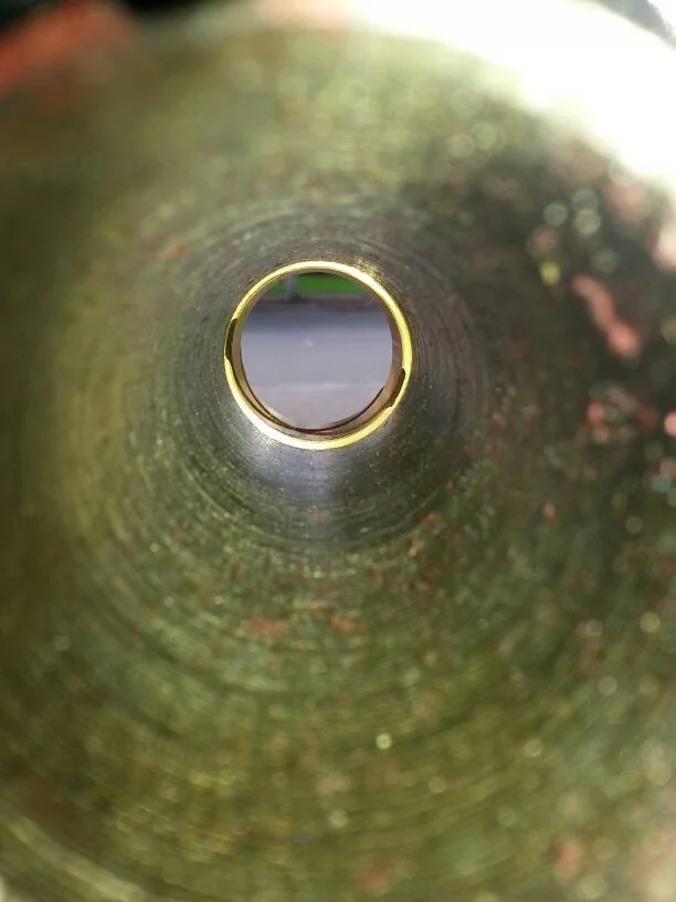

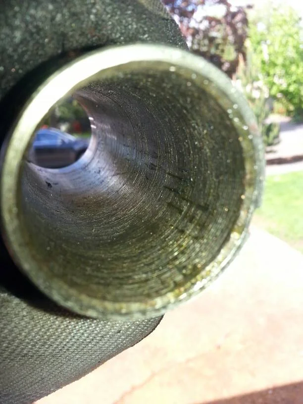

So I got to playing with the front DS knuckle, because I didn't like the feel of things when I put it together last night. I ended up messing with the shims to get a better alignment and knuckle feel, but nothing worked. I then noticed that the birf stub was not centered in the spindle. I proceeded to take the spindle off and found the spindle bushing to be seriously worn and some wear in the spindle itself. I don't have the extra $$ to be getting new spindles at the moment, but plan to replace the bushing tomorrow if Toyota has it in stock. Part #90999-70067 for those interested.
Here's what the interior of a spindle looks like after being run on a worn bushing. Obviously some foreign material must have gotten into the spindle as well to cause the grooving. Also there's a pic with the new bushing installed.
In case a person has never done the bushing replacement before, know that you often have to remove some material off of the bushing to get the axle to fit. I just used a drill and a small sandpaper hone to remove material to get the axle to fit snugly.
