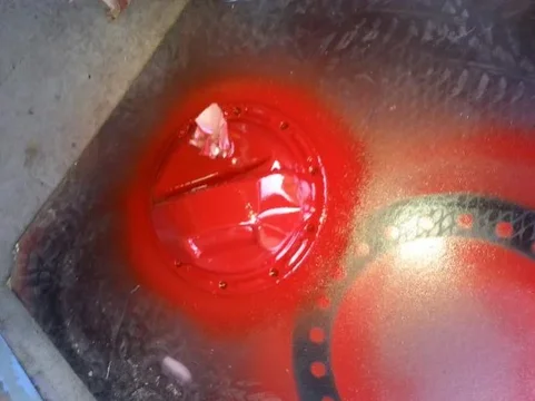

Did some rear diff armor today and also put together one of the rock rings. Both look good.
Thanks to Death Grip Offroad for cutting this stuff out for me.
The color is "fiesta" red and a heck of a lot brighter in a photo than to the eyes.
