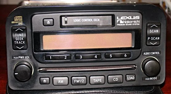

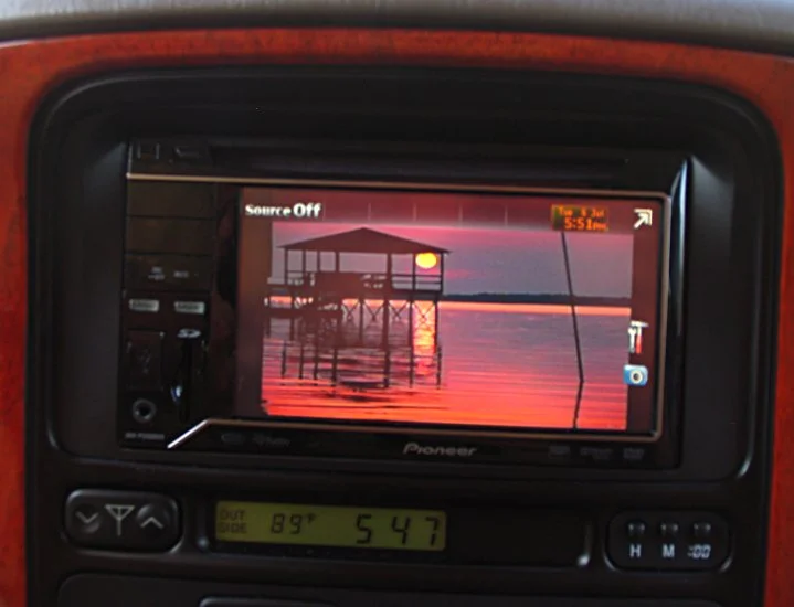

Well, I read the stories of the terrible Nakamichi stereo (actually this is made by Fujitsu)....and figured I wanted to add Sirius and NAV later anyhow...and miss being able to play my mp3s on USB Thumb Drive through front USB port as well....so bought a Pioneer AVH3200DVD and hooked it up to the stock system.
First I searched for installation options...which were replace and rewire everything...or do it piecemeal...or just change head unit. Still there was some disagreement on how well it would work...but someone I have gone to for info and has always been a straight shooter assured me it could be done.
So off I go to a local shop to see what they would charge as I am not even remotely confused with being an electrical or stereo guy though I have installed a few including on my FJ60. First shop say, "You got to lose the factory amp and we will have to rewire everything...and you will lose sub unless you buy an amp from us or your head unit has 5 ports!" I tell him he is wrong and he is adamant it wont work.
Shop 2....same story but offers me a great deal on new speakers, amps, head unit, installed and out the door for $1800....hahahahahha NO THANKS!
Call 3rd shop...they say, never done a Lexus but if everyone else says it cant be done...then we will find a way to make it work, and work right! Told them I had pinouts and some info on how it was done...they were appreciative...and looked it over and said...it will take an hour or hour n half.
So the next day they took out the Nakamich (which is for sale if anyone wants it to keep their stock look and not cut into harness)...uses 22pin connector that NOBODY ELSE IN WORLD uses and they have never used since this series of radios...so there is NO WIRING HARNESS and no fit kit...complete custom install including trim. Make me an offer on the Nakamichi and it is YOURS!!!!
so the tech gets in there and cuts the connector...reviews the pin-outs...starts crimping and connecting and making everything line up. 30 minutes later he starts with radio fitment.....45 minutes total it is installed and working great.
I check it....USB, good. DVD, good. CD, good. Radio, good. Subwoofer, good. Equalizer with multiple settings including presets as well as option for auto analyze with microphone.
Only thing is they said it would take over an hour longer to custom fit some abs plastic to fill in gaps and trim it out....as he likes them to fit snug. Then another guy says, I FOUND THIS FIT KIT with a vendor we use...looks like only one out there but is expensive. So I decide to give it a try as it would cost another hours labor at minimum maybe longer.....
So ordered it and today it was finished with trim kit.
Trim kit was not a simple install...required grinding ears/nubs off mount brackets so you can mount it on holes further back therefore pulling face of radio out further as it needs pressure behind trim kit to hold it flush against back side of dash panel...but the look is very OEM and clean in my opinion. 15 minute install with figuring out how to make it solid and fitting and then refitting...but well worth it in my opinion.
