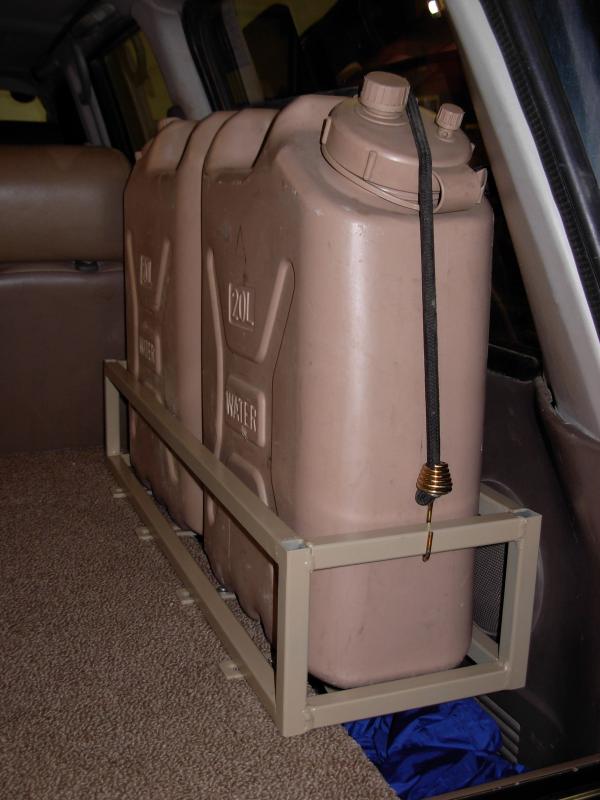

Water Can Holder
Trying to keep the center of gravity lower, so I built a small rack for the cargo area to hold 2 water cans and move them off the roof. I secured it to the 3rd row seat and seat belt mounting holes and onto the top of the drawer box.
I will use cargo straps to secure the full cans, just used the bungee to hold the empties in temporarily...:)
Cheers.

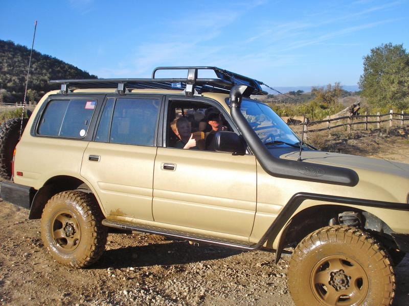

How much space is there between your ARB rack and the roof of the truck? I am getting an 80 and have a rack from my FJC, but I am not sure if I will have to remove the OEM rack before putting on the touring rack. A picture would be great.
ARB Touring rack
I have approx 1 1/2 " between cross rails and roof and 1 1/4" from bracket to roof where factory rack sits.
The brackets are adjustable for height and look like you could raise at least an inch or 1 1/2" higher.

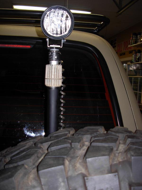

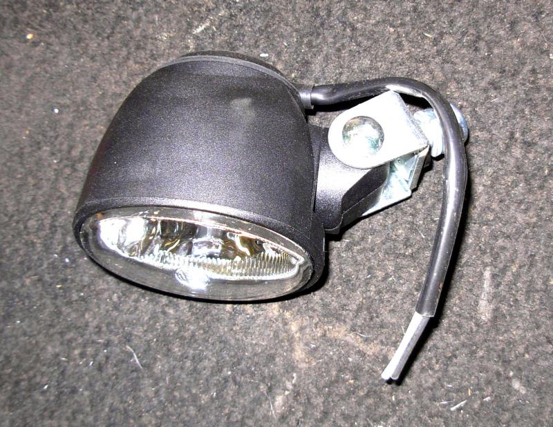

I ordered some Hella Module 70 halogen work lamps after seeing them at the 4wheel parts show. I wanted some good light for a backup light and utility lighting and LEDs are still too expensive for me. These were $30 each.
Hella Part 996176491 - 70mm Halogen Work Lamp
I mounted the backup lamp underneath the can carrier on the ARB rear bumper (despite pic, it is protected by edge of carrier). For a utility light I used a painter's pole and replaced the fiberglass outer pole with steel, epoxied the lock mechanism to the new pole and fabbed a bracket to attach to rear of spare tire carrier. I cut the roller threads off and threaded the light bracket onto the top. Switch is inside the cargo area.
I remembered something similar on Mud but could not relocate the photos, so thanks to whoever originally came up with this idea.
Cheers,
Greg
