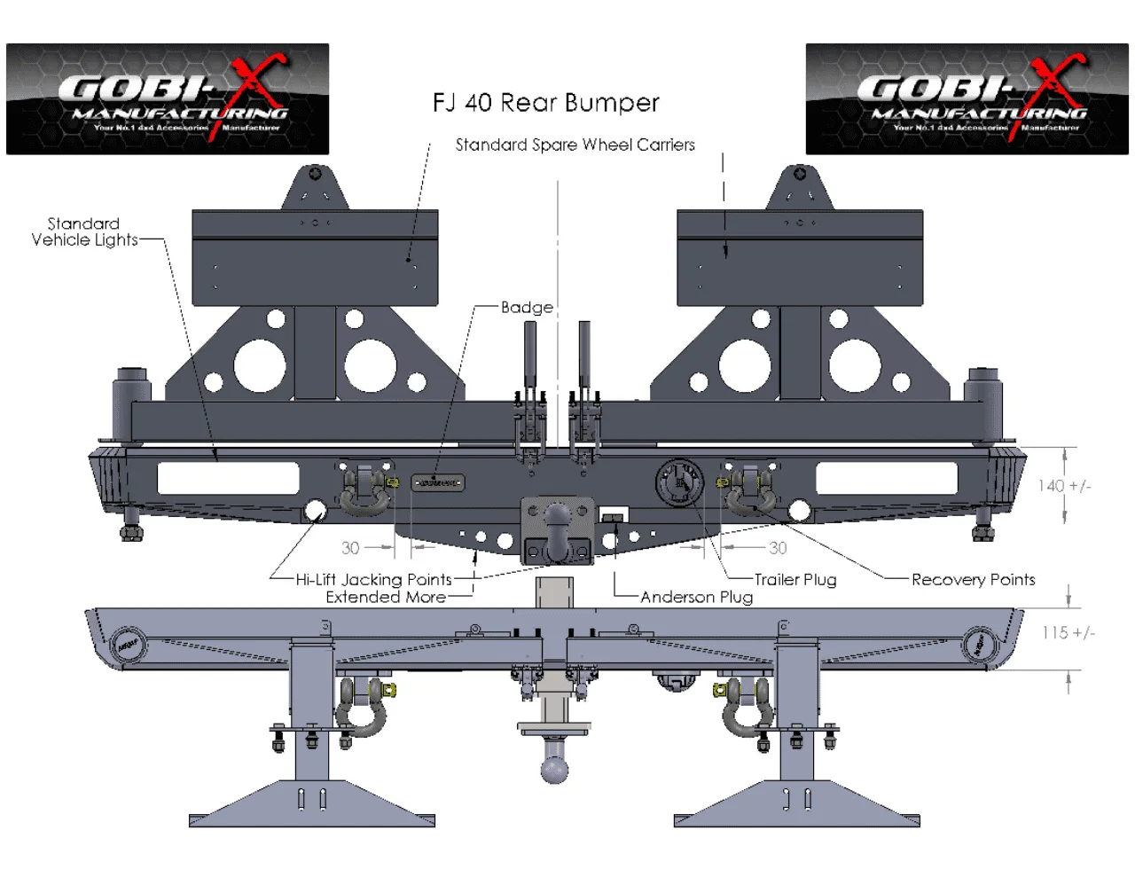

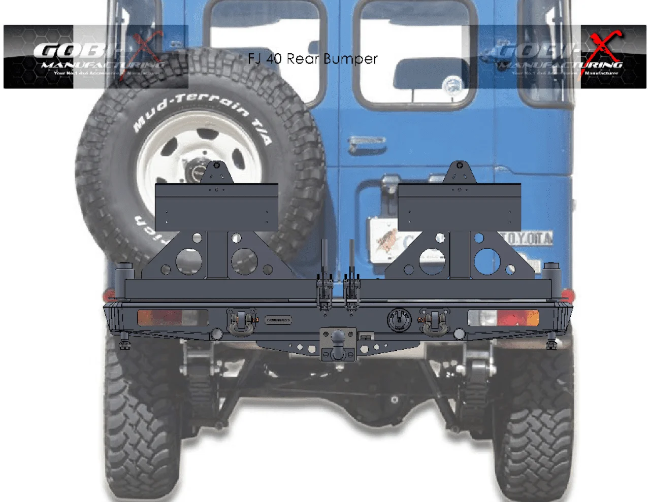

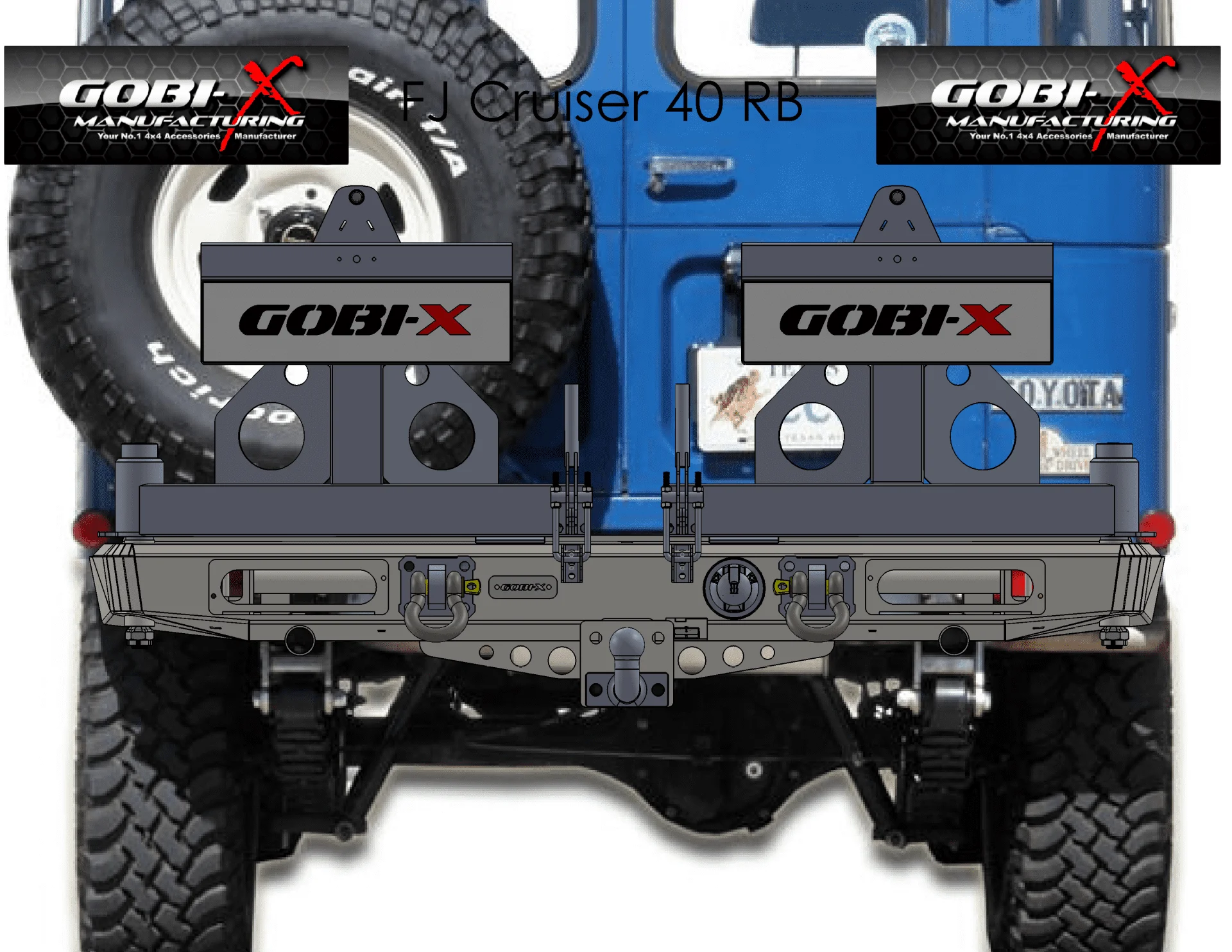

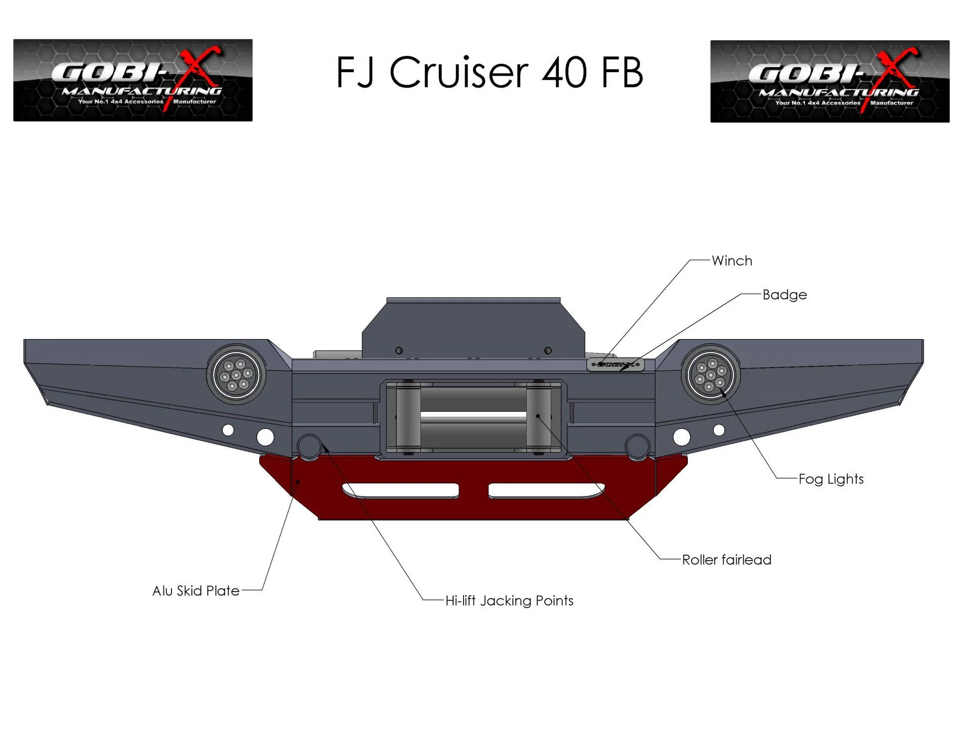

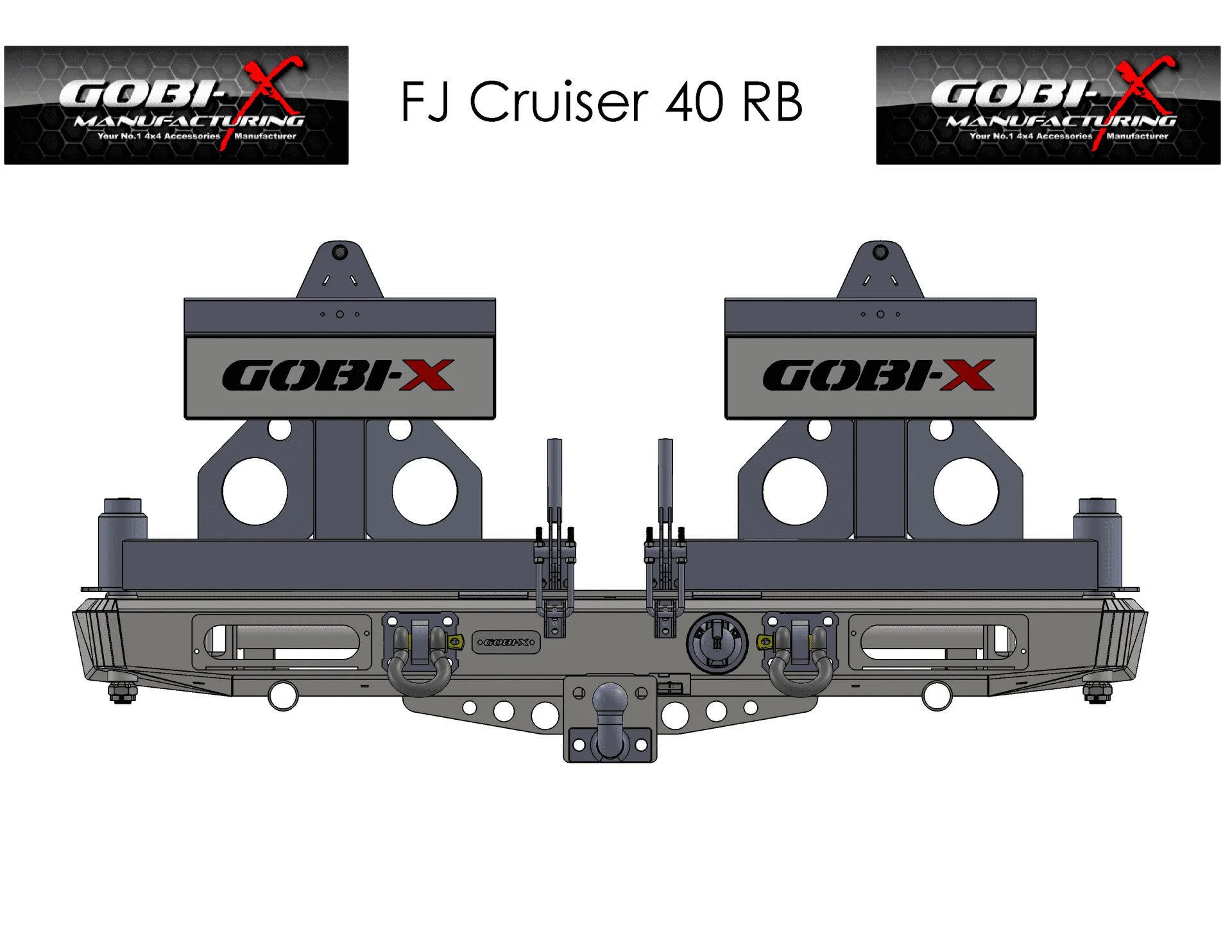

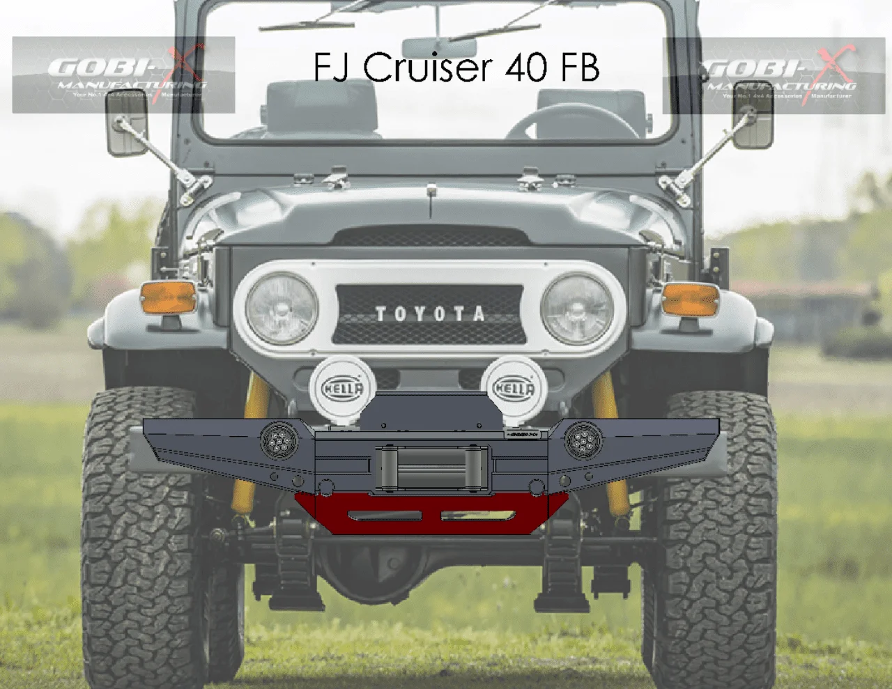

Some very rough drawings to get the creative juices going ...
ACtC-3cVt6C2ak88Nufe2OVSdzcZZi8Q3-6wMjunJfjKINAfXGm2iKnc5ylfRFRFzQReVfJFf5wT8YroYafIA5vApKQeLcEycf_wLdPO6Bi941i_VF6Oh5Ac34XDP48dwpznZAnx-GcmKHhwVrc3ZUmOaDds=w641-h381-no
ACtC-3dssDCNuWipP2tjesTg62wCnIgGa9wbxfvN9cHEiJhl7Ue7CaU61uHxXLYaImy4B-hodVh5HCd3kYXlBOiqOT95nw9TYSoOnDCk4YG5eXamwGc6YYwHQWG_k0ZRQk4poHxPFwUUM94OFcx8m2IwQJdG=w658-h381-no
ACtC-3ebpVNY2Illlf1lFXBptPrHxTPpmTyD31NeZ-o73YdhA4OHNQ7x2uy6KI7OSKF48iwcSGEXI7CZWQdolvFq4DnJ4QeGXihAss05VProC04LsJ8s5bdNkfgkN0p3pOIENkVqorbYEXQg0Qv1ajPjGoJQ=w621-h321-no
Watch this space.
