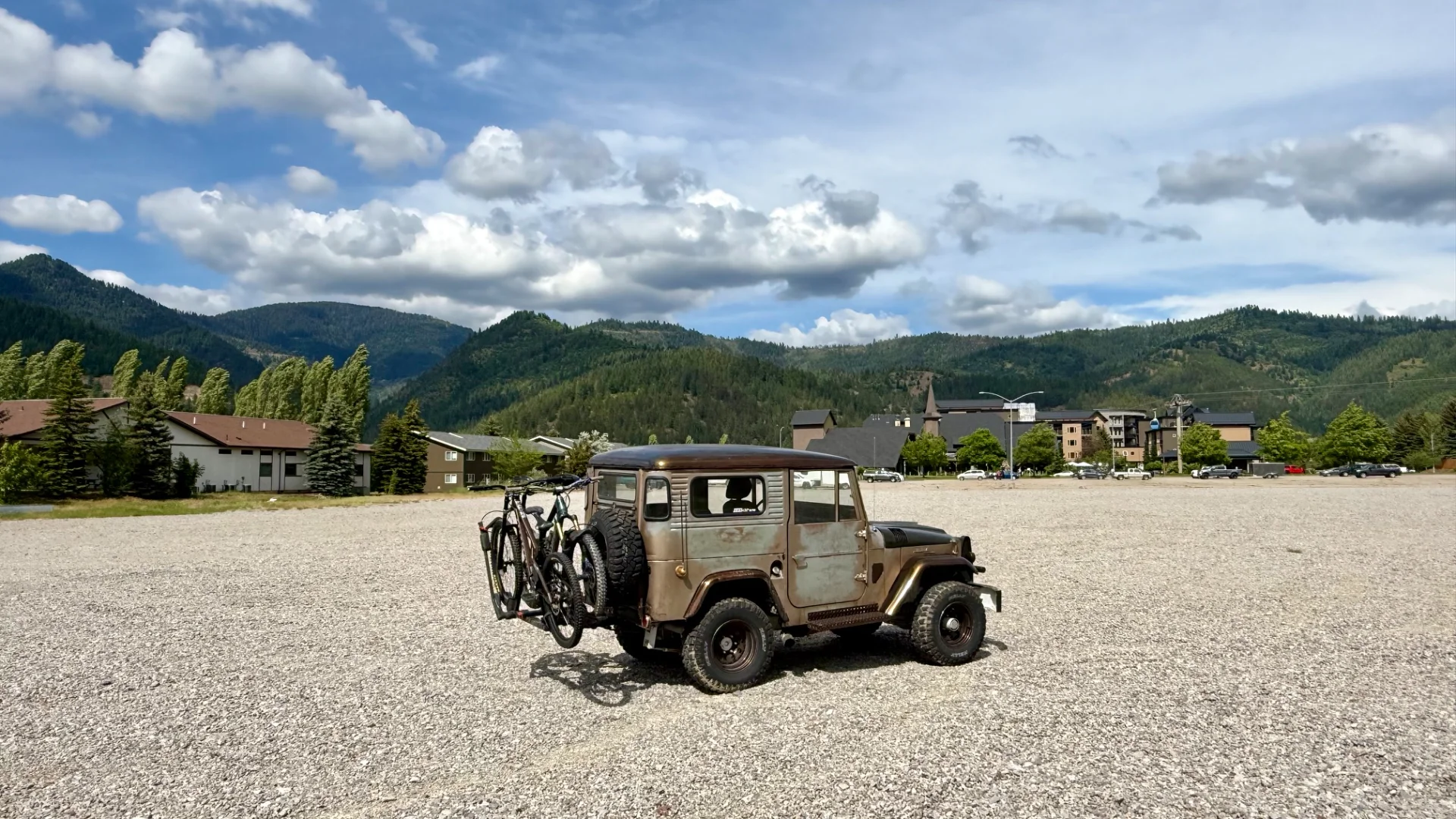

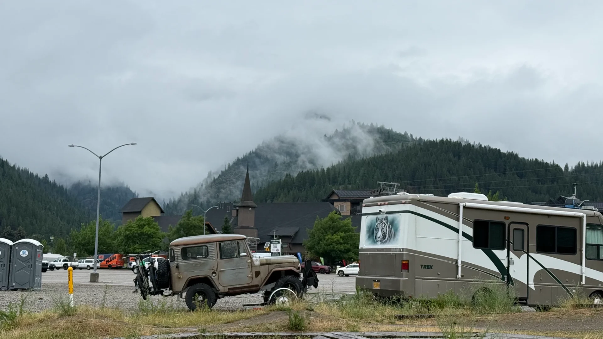

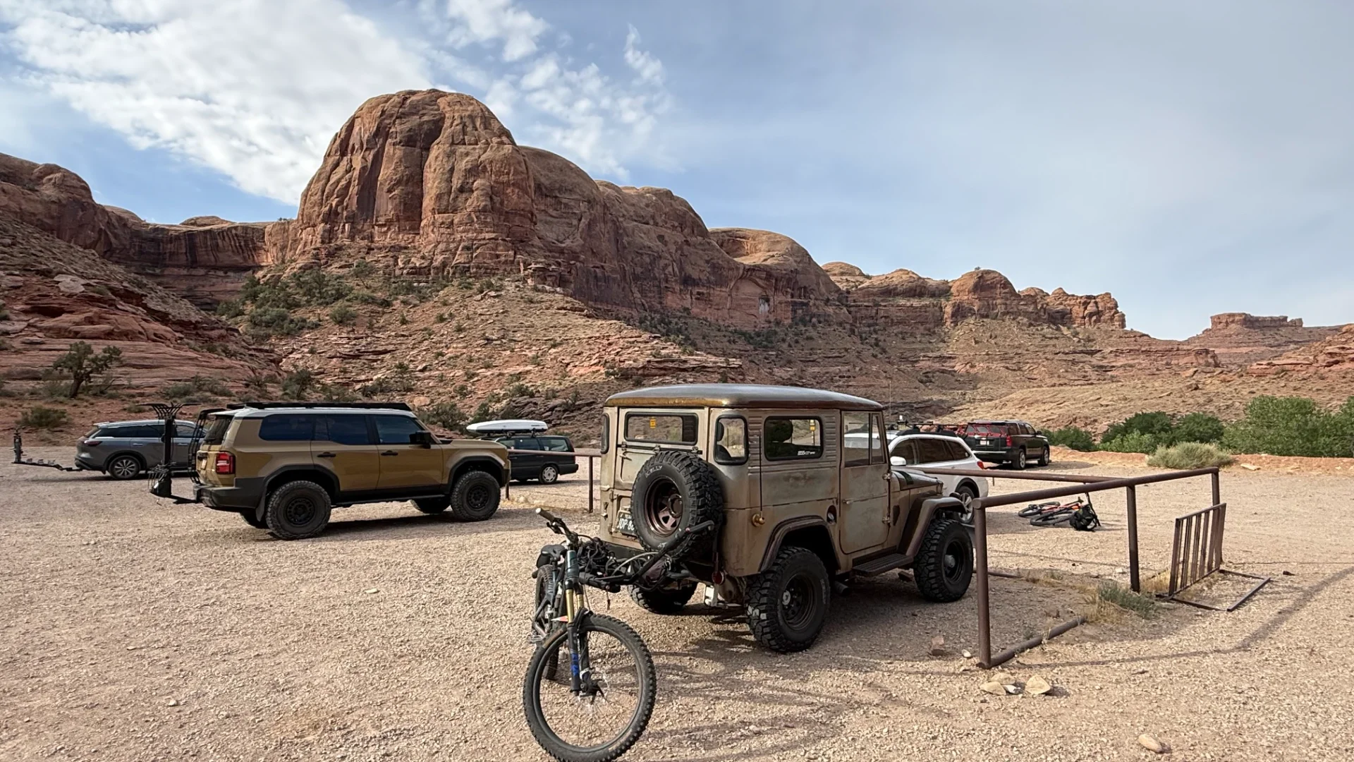

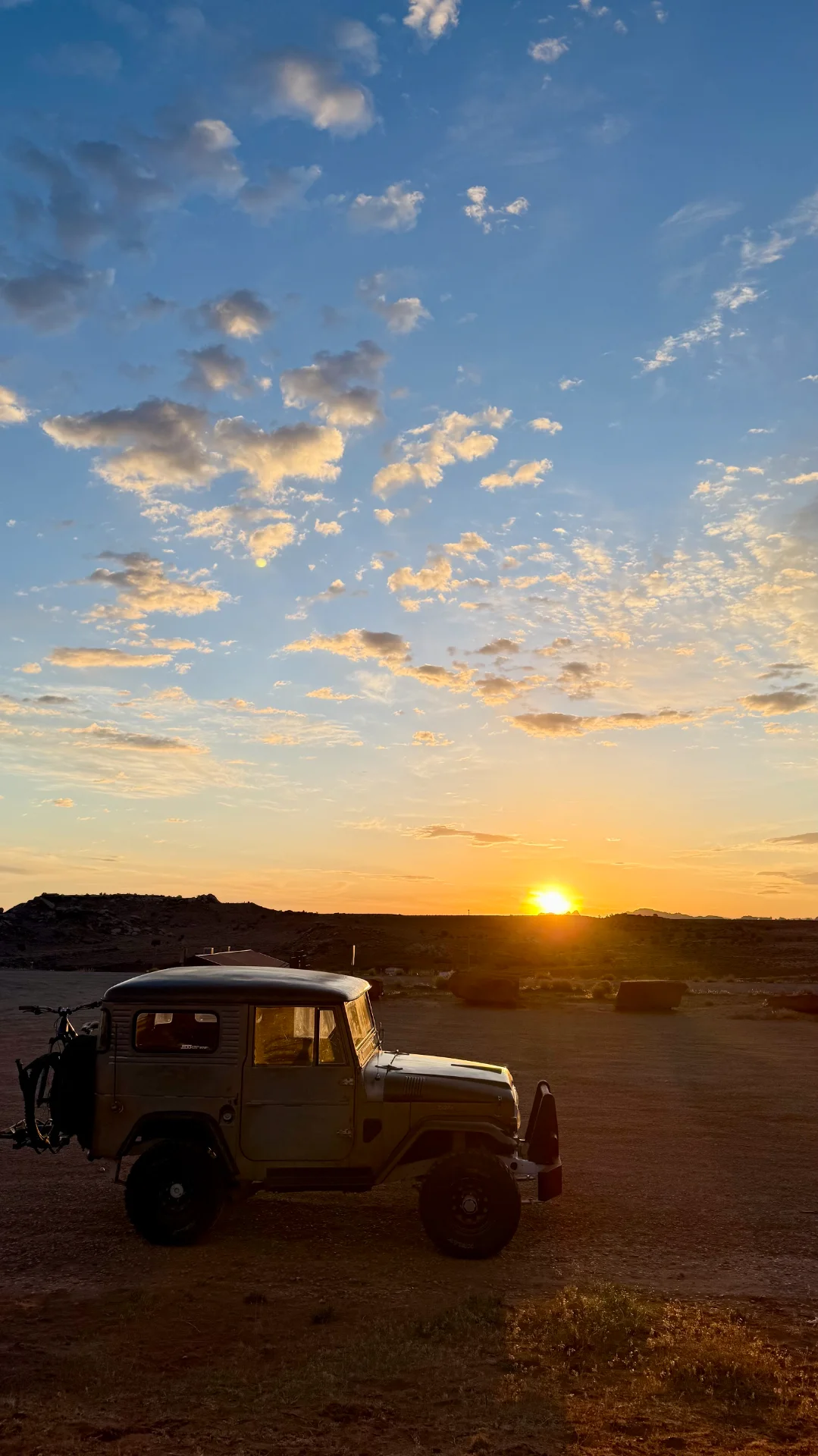

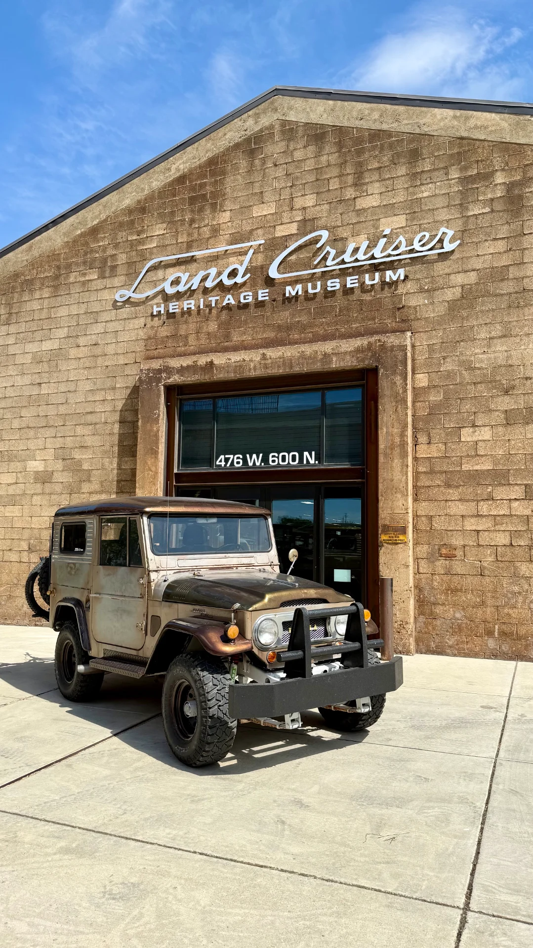

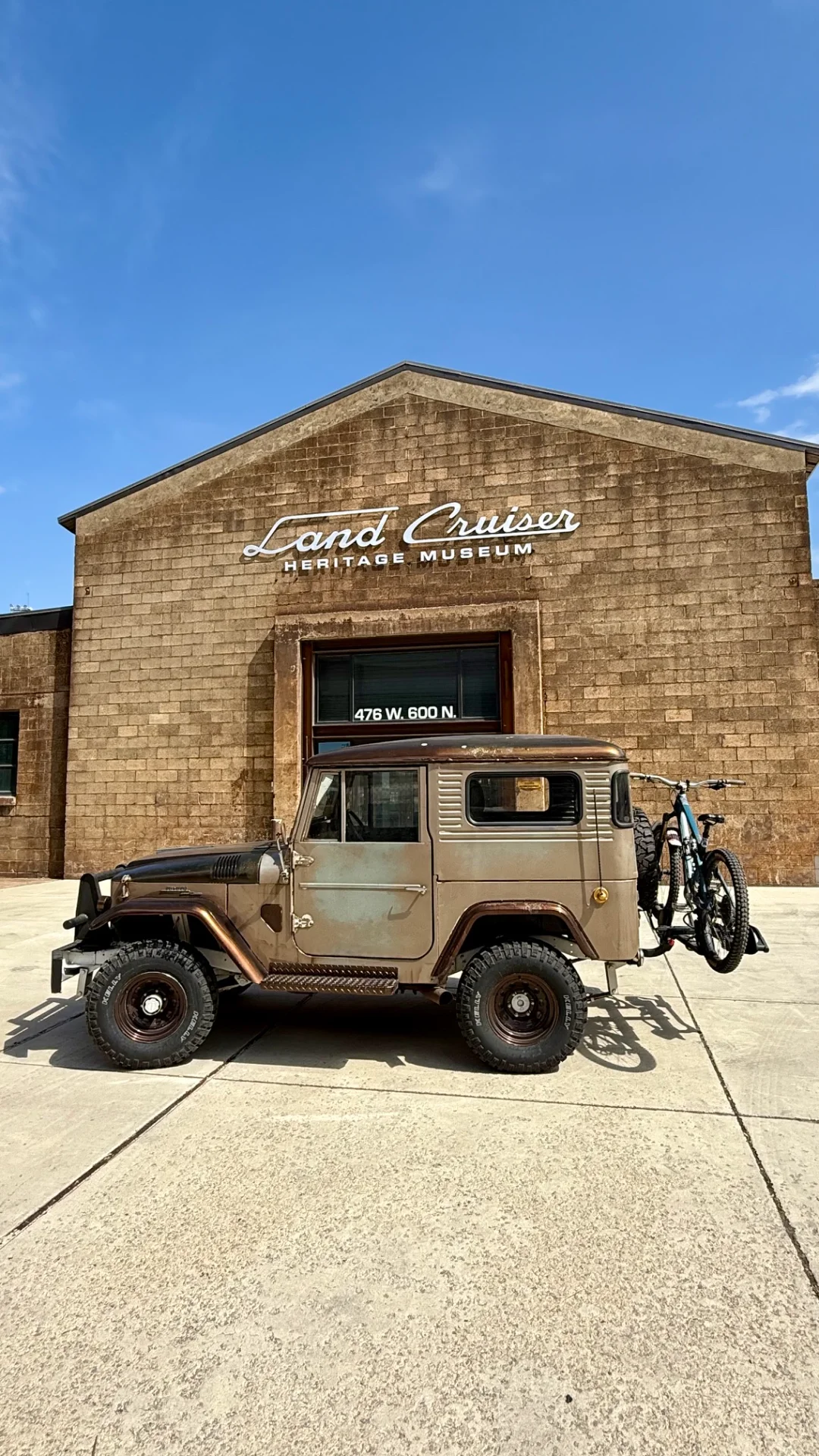

Just wanted to attach some quick pictures from my summer adventure.
I bought a new RV and needed a vehicle to tow and drive to the mountain bike trail head, which is why I settled on the FJ. I basically spent the summer travelling all over the west, and spent a month in Spokane in the middle. Made for some pretty cool pictures along the way. I only saw like 1 or 2 more the entire trip... both in Missoula MT of all places.
The biggest issue I had on the trip was the edelbrock carb acting wonky at all the different elevations. I found a Holley Sniper kit and bolted it on, now it runs like a champ. Very fun vehicle, get LOTS of stares.... and lots of "nice Jeep" comments, lol.
If you flip the bezel, swap the bumper, and paint anything white with black, it will look nice. There are some unique enhancements from the previous owner for sure, but please tell me it has the original engine.
