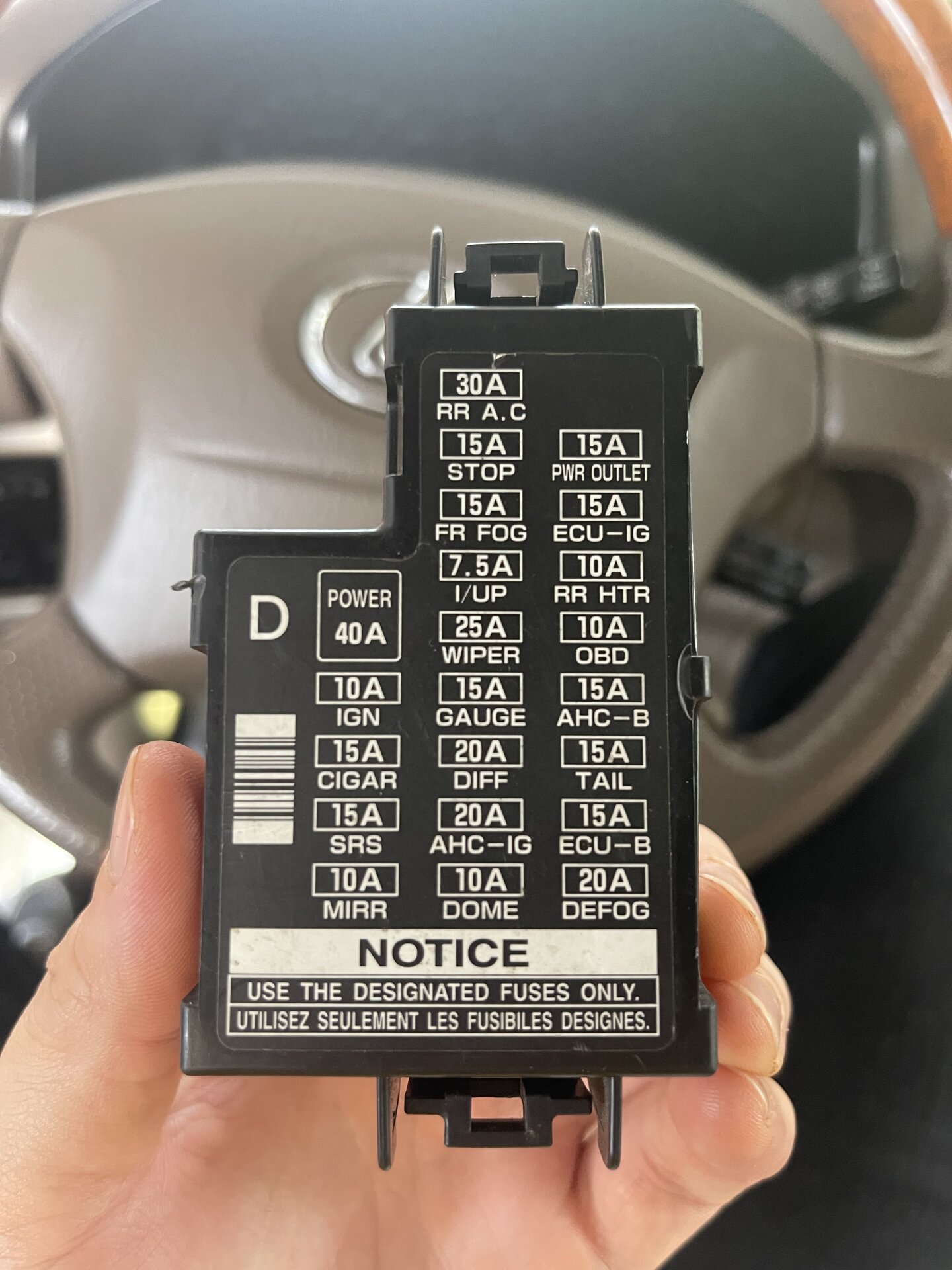

Internal fuse box constant 12v location on 02 LX
Aug 21, 2023
5
16
Nashville
So I’m in the process of wiring up an Autovox V5pro mirror/back up cam. It’s got a wiring harness that I am hoping to run off of the internal fuse box with the included add a circuit fuse adapters. I need a switched ACC to tap into (was thinking cigarette lighter) and a fuse that gets constant B+. I’ve attached a pic of my fuse cover, any thoughts on which may be the fuse that provides constant power?
ECU-B
