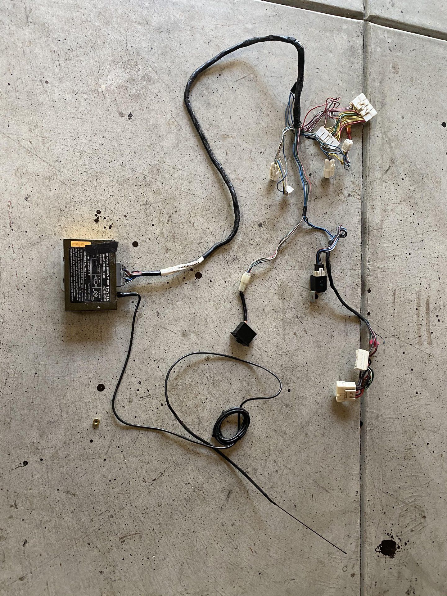

Which factory alarm do you have? Mine ('94) had a Rostrov (?) unit. This was installed under the dash compared to the RS unit which was under the seat. My unit went faulty and the symptoms were intermittent no start and intermittent blasting of the horn. Ripped it out and never looked back.
I have the unit under the drivers seat. Thanks!
Did you lose the ability to unlock with the remote?
I would look into changing the wiring to and from the ignition switch. That is more than likely the culprit since you have changed all the other. On an 18 year old vehicle the wiring can degrade to a point that it does not allow enough voltage/amps to engage the solenoid. I personally believe it to be undersized leading to this issue which seems to be common problem with most early 80 series. I chose not to go that route and have installed Ford solenoids on the 3 cruisers I work on and haven't experienced a no crank issue since. Prior to I was rebuilding starter solenoids and or changing starters at least once every 6 months.
We have solved the issue. (I think) It just started ten times in a row.
I removed the factory alarm system.
Thank you for the help and the awesome write up with pictures!

Happy to have this removed! I feel like I removed an alien!
