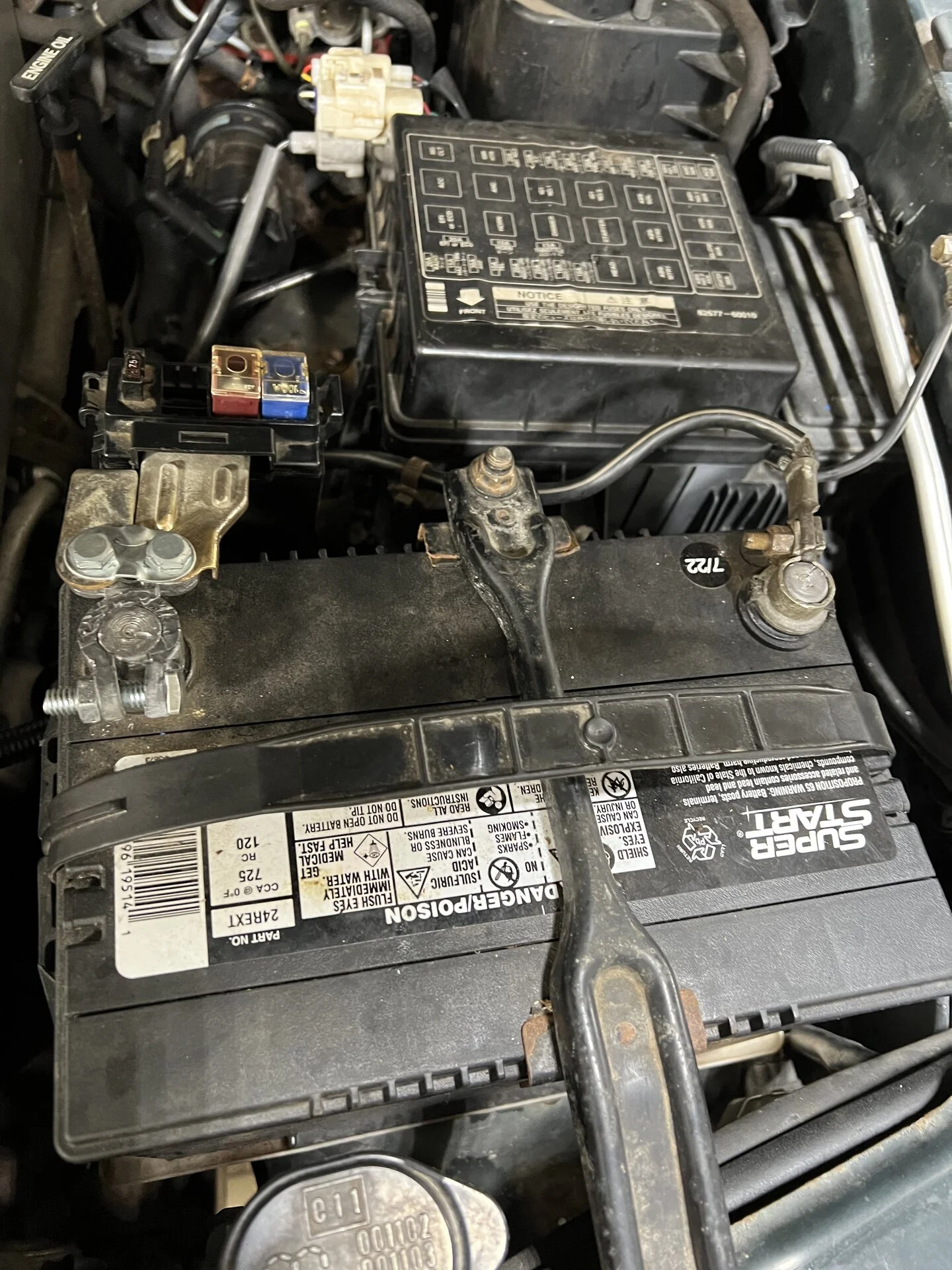

I checked the battery/fusible link fuses which seemed a bit corroded so I replaced them and cleaned all of the connections on the battery ground and cables. I also went through the fuses which were all good. There was no resistance across the battery/cables and the battery was 12.6v. The climate control unit still doesn’t want to come on.

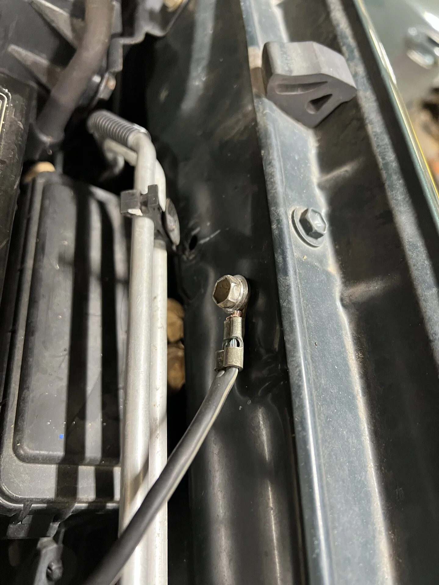

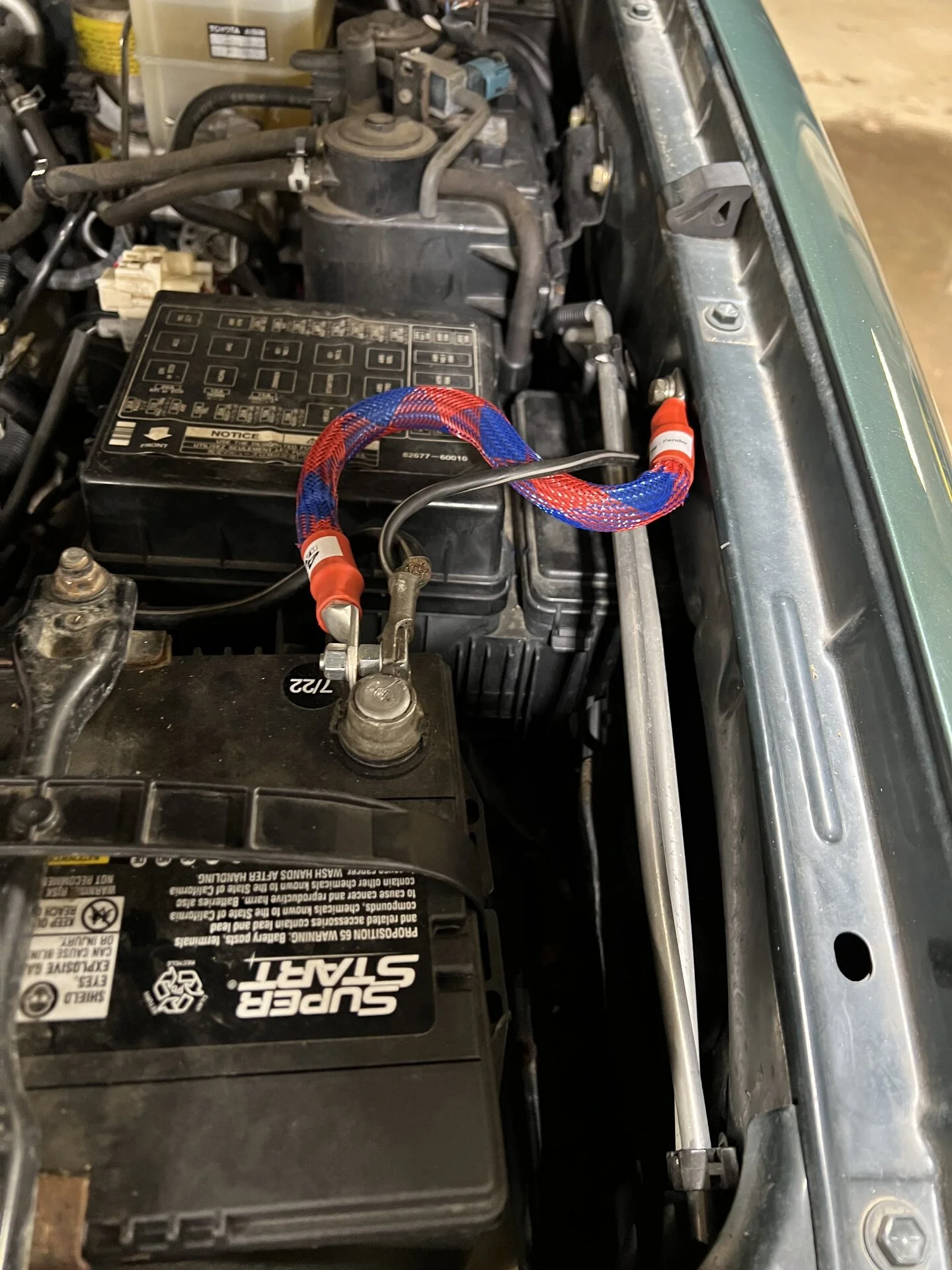

The main ground cables seemed a little corroded so I got the three upgraded ground cables from a member on here but Im still having the same issue with the climate control. Any ideas before digging into the wiring behind the dash?

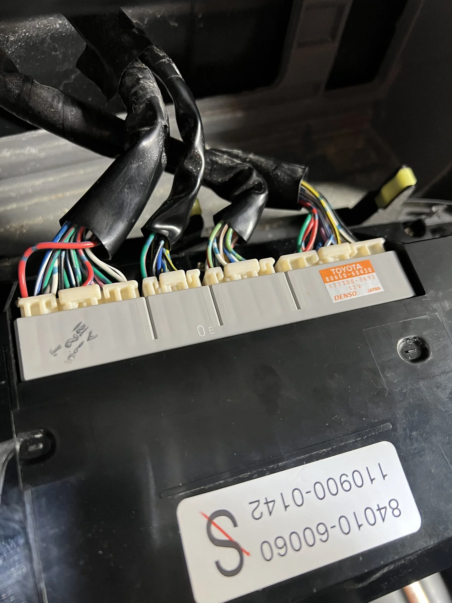

I don’t have a fix yet. I took it to the dealer and they said theres a module or power supply that isnt giving enough voltage. I tried giving power straight to it from the cigarette lighter wiring but then I got an issue where the fans and compressor do not turn on. I still have more digging to do in the service manual.
i got it figured out now. For some reason I thought I had to remove the old power connector and only use power from the cigarette lighter. But after combining both and soldering it up, the climate control module has good power and works now.
