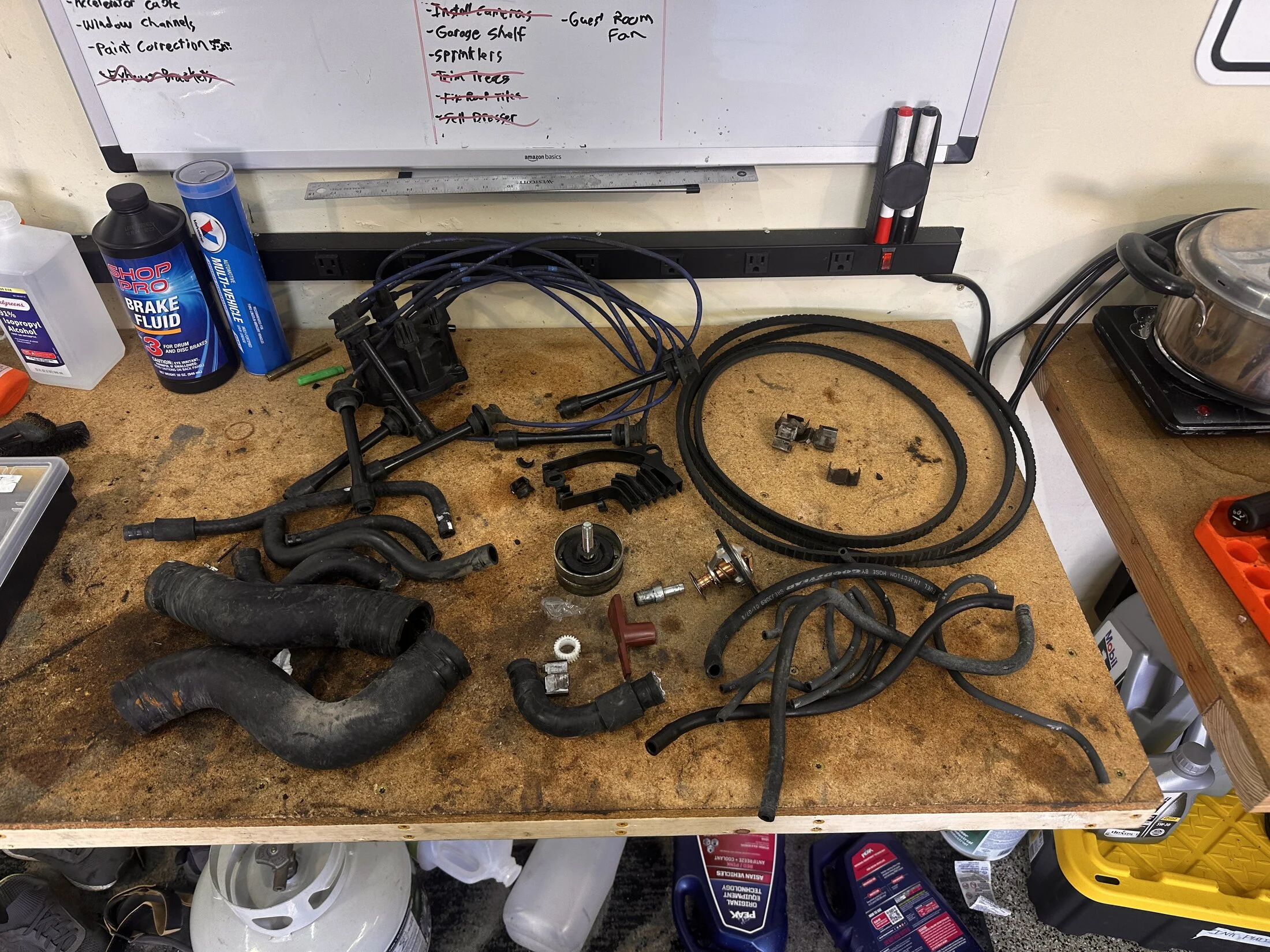

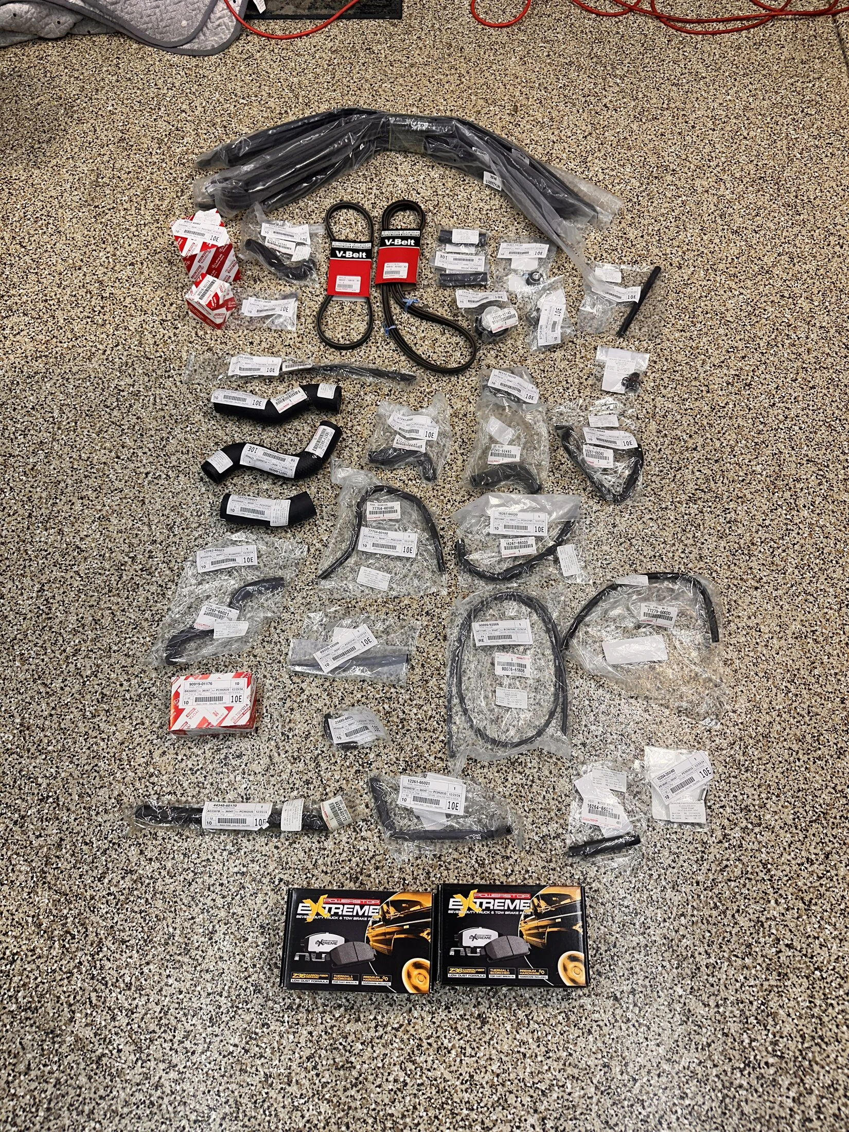

Ok, I have one for you guys. Recently purchased an 80 and I dove into all the general maintenance. Before tearing everything apart, it steered just fine, but there was a pretty serious power steering leak from the fill line on the reservoir. So during my maintenance I replaced serpentine belts, brake pads and rotors on all 4 corners, vacuumed lines, fuel line, coolant hoses, power steering lines, ect.
After getting it back on the road I had very stiff steering. I flushed the P.S. system replacing the fluid with ATF and burped the pump by going lock to lock about 20 times, letting any air escape ever 5 or so locks. It does groan at full lock in either direction. This seemed to help but I still have very tough steering intermittently at low speeds or when going from one direction to the other like when I’m trying to back into a parking spot. I’m stumped… I’ve read post saying everything from P.S. pump, steering box, air in the system, and even knuckle bearings.
