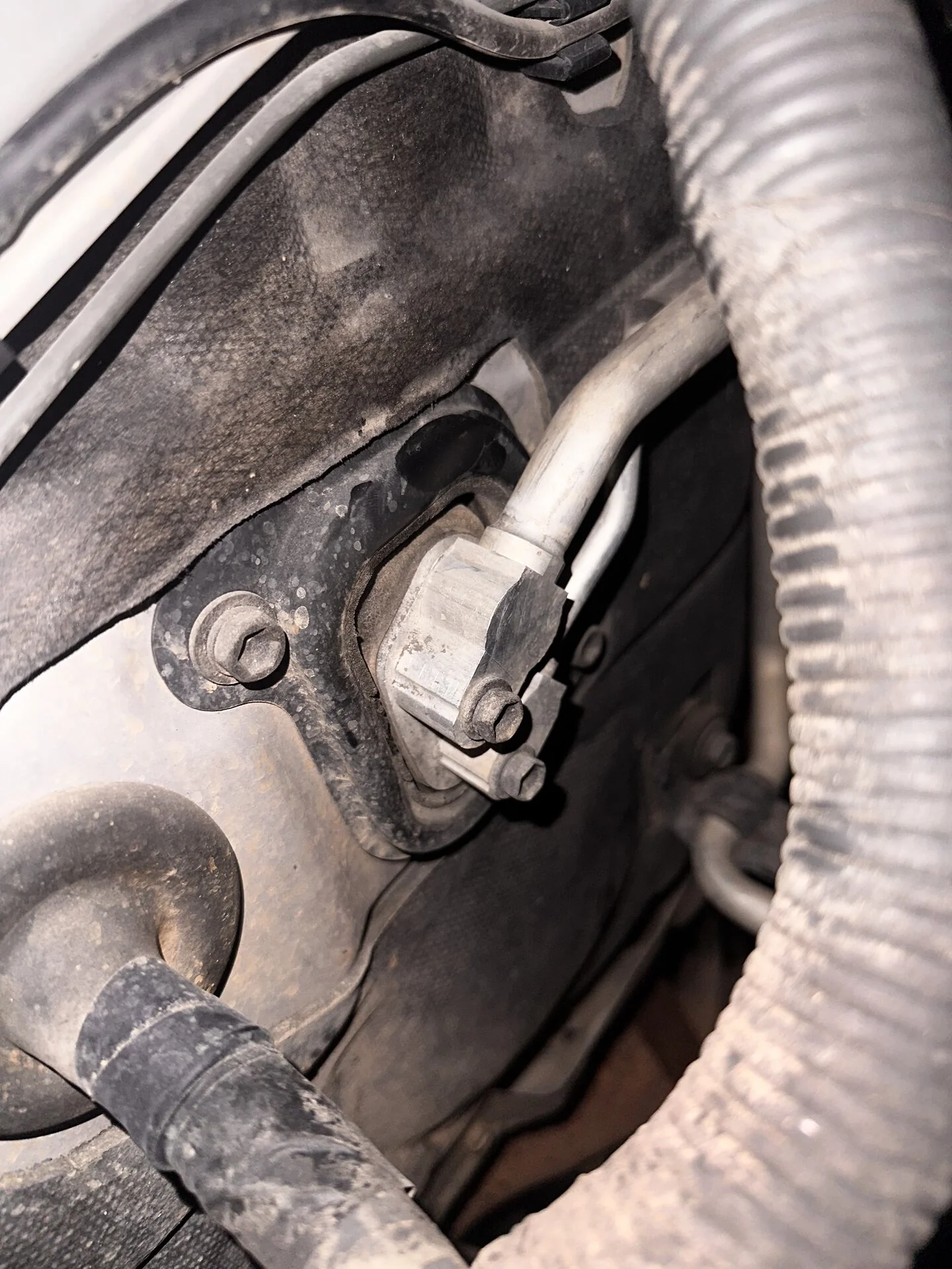

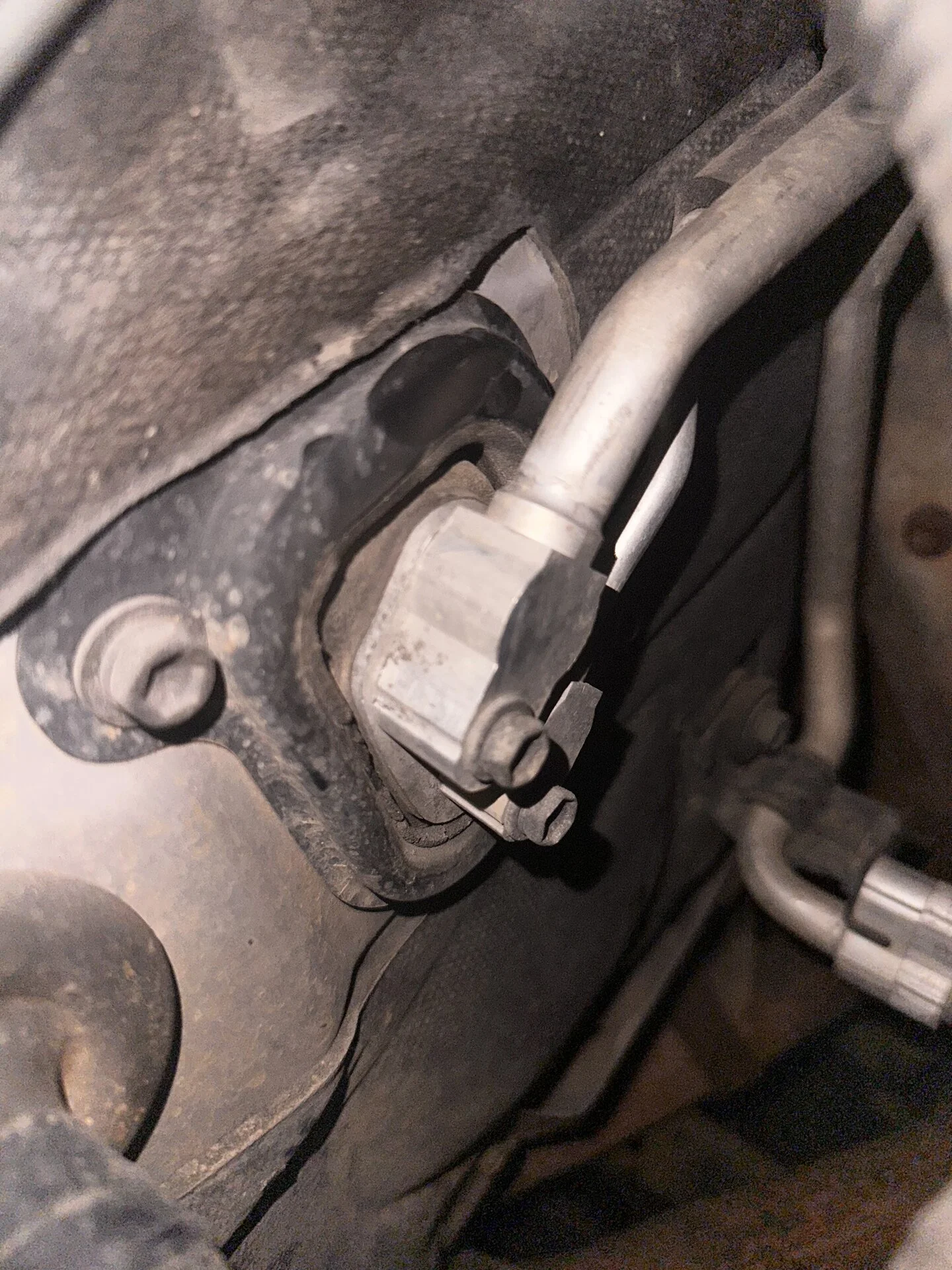

Hi, I’m working on my 96 Lx450, I got it on May 10 2023, and I been working on the interior first since, right now I’m trying to figure out where is water coming in from(the passenger side carpet )so that I can finally get the new carpet in !☺️, I have looked where the water usually enters based on previous threads I’ve read but I seems that none of those are the problem I’m having , but I found the problem ( i think😂) (pics attached), with a hose a pour water on that and a lot of water started to come into the passenger side floor, I don’t know is water is entering because of the metal piece surrounding it, or because of the one inside or because of something else, so if anyone know’s what are those parts called and how can I find them, and if anyone else has had the same problem as me?.
I’m new at this so I’m excited to learn and be a part of this community, also English is not my first language so excuse me is there’s any misspellings

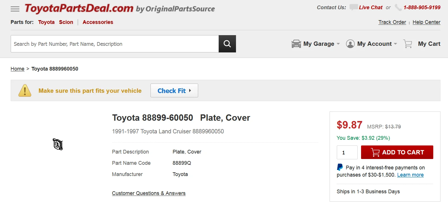

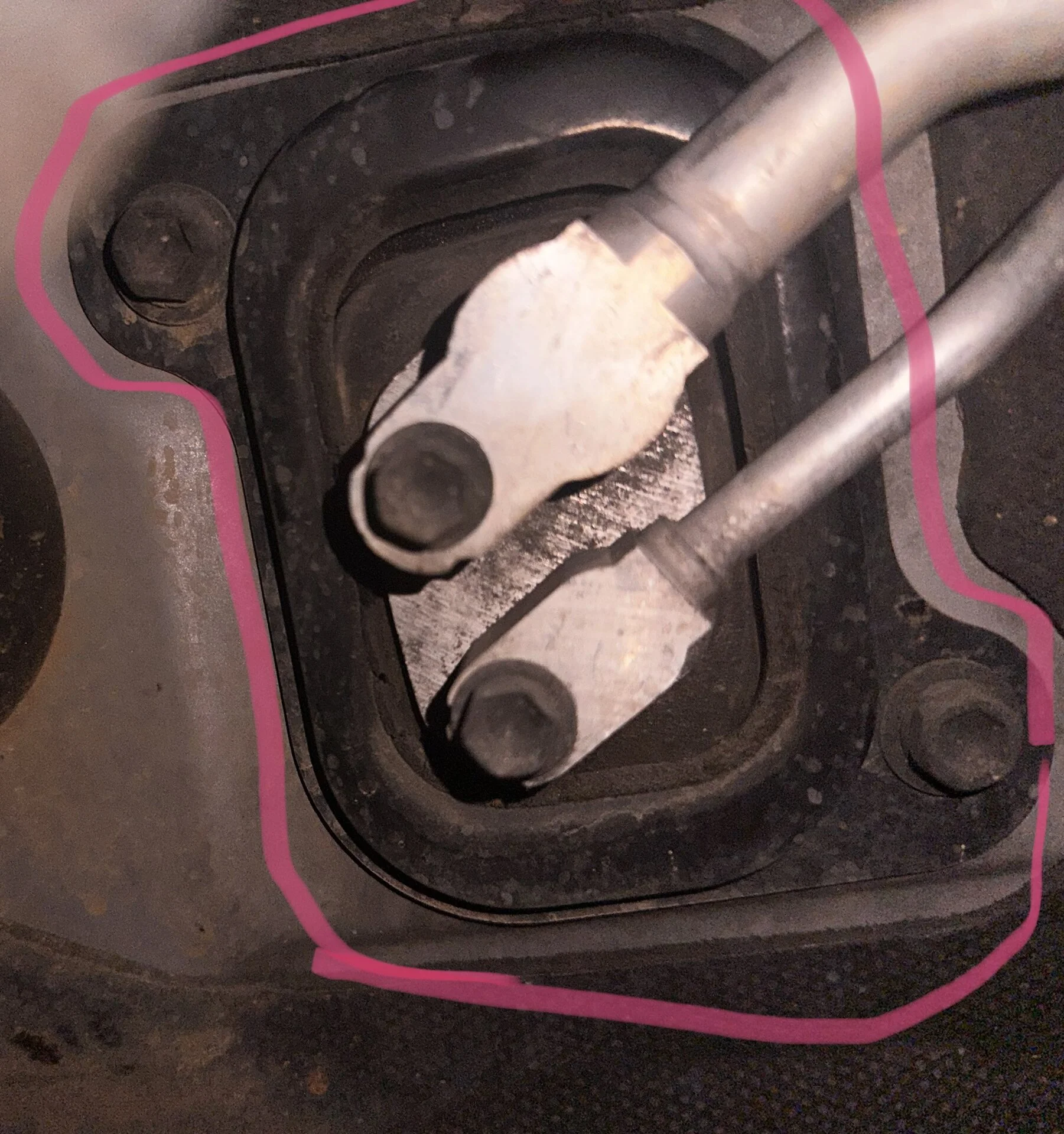

If you can spray or pour water on that seal, and you're getting water in the passenger floorboard area, you need this:

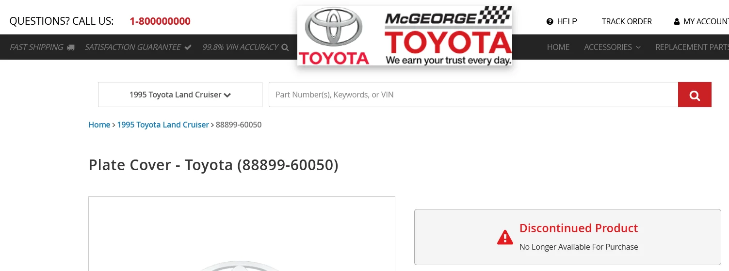

Unfortunately,
so, you'll have to make a gasket for the plate, which is probably all that you need anyway.
However,
so maybe they actually have one - no way to know unless you ask them.
The bad news is that the really seal it properly, you have to disconnect the two A/C lines going through that gland. That requires evacuating the refrigerant, and replacing it, along with a new dryer, located at the left front corner of the engine compartment, between the headlight and radiator. You should always replace this unit when the A/C system is opened, because any water in the refrigerant reduces its ability to cool significantly.
