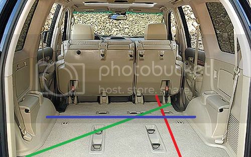

I'll try and remember to measure it for you and post back. If you were to build a sleeping platform, it does widen above the wheel wells, and there is lots of ceiling height in the GX470/Prado 120 body style, much more than a 4th Gen 4Runner or LC80, so that could be the solution. I can tell you at floor height, it's 5-6" narrower than my wife's '05 Acura MDX, which makes a huge difference when packing the truck for a trip somewhere, or putting dog kennels in, etc.
Red line (from 2nd row seat in the up position straight back to the cargo door closed) is approximately 60"
Green line (from corner to 2nd row seat in the up position) is approximately 72"
Blue line (from wheel well to wheel well) is approximately 44"
I'm 5' 7" and have to sleep at a bit of an angle to make it comfortable, you might want the second row right out for sleeping.

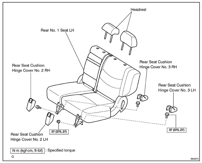

Thanks, good to know. Is the second row pretty easy to remove? Fromn RCsGX pic it looks like it might be similar to a 80 and pretty easy.
