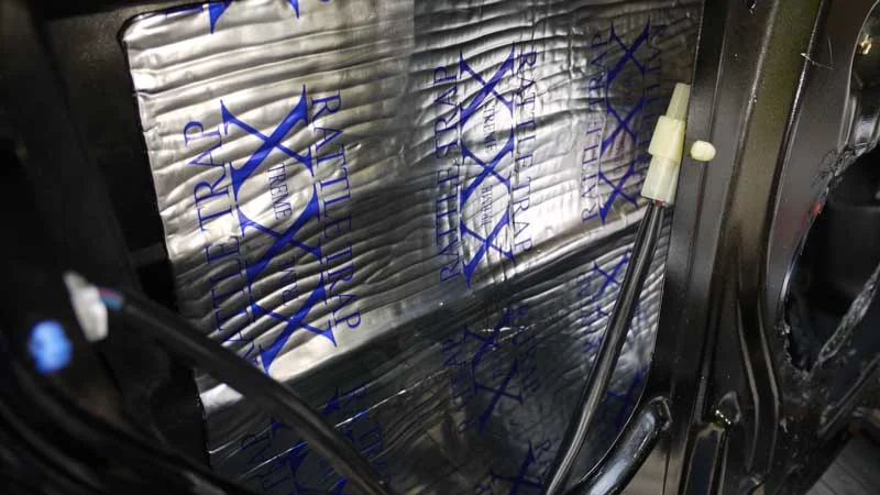

If your really looking to go over the top...use Dynamat or Rattle Trap Extreme it's a FatMat product thats every bit as good if not better than Dynamat and half the cost.. the aluminum backing is much better. I purchased 100Ft pack for $132.00 ... and then brush or shoot on a sound deadener like Second Skin..or Lizardskin. You can top off with bedliner...
I used Dynamat Extreme and Dynaliner on the roof and floor

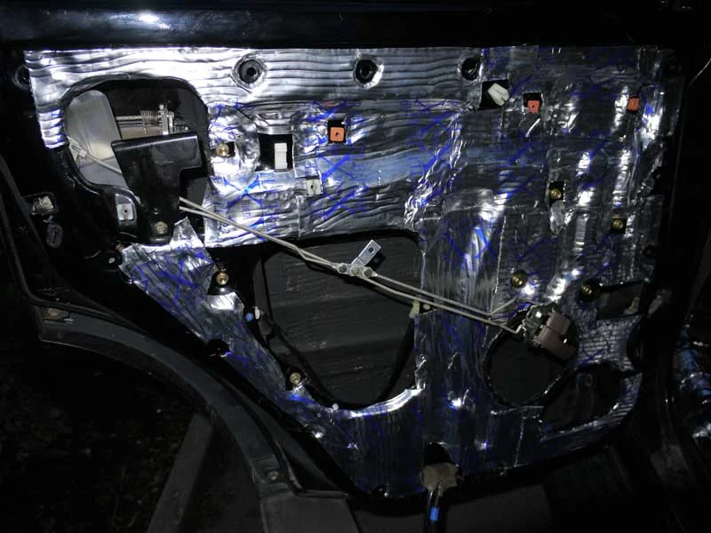

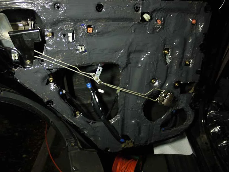

Here's a few shots of my doors and the process ...As you can see ..one can get little carried away:)
Lou
