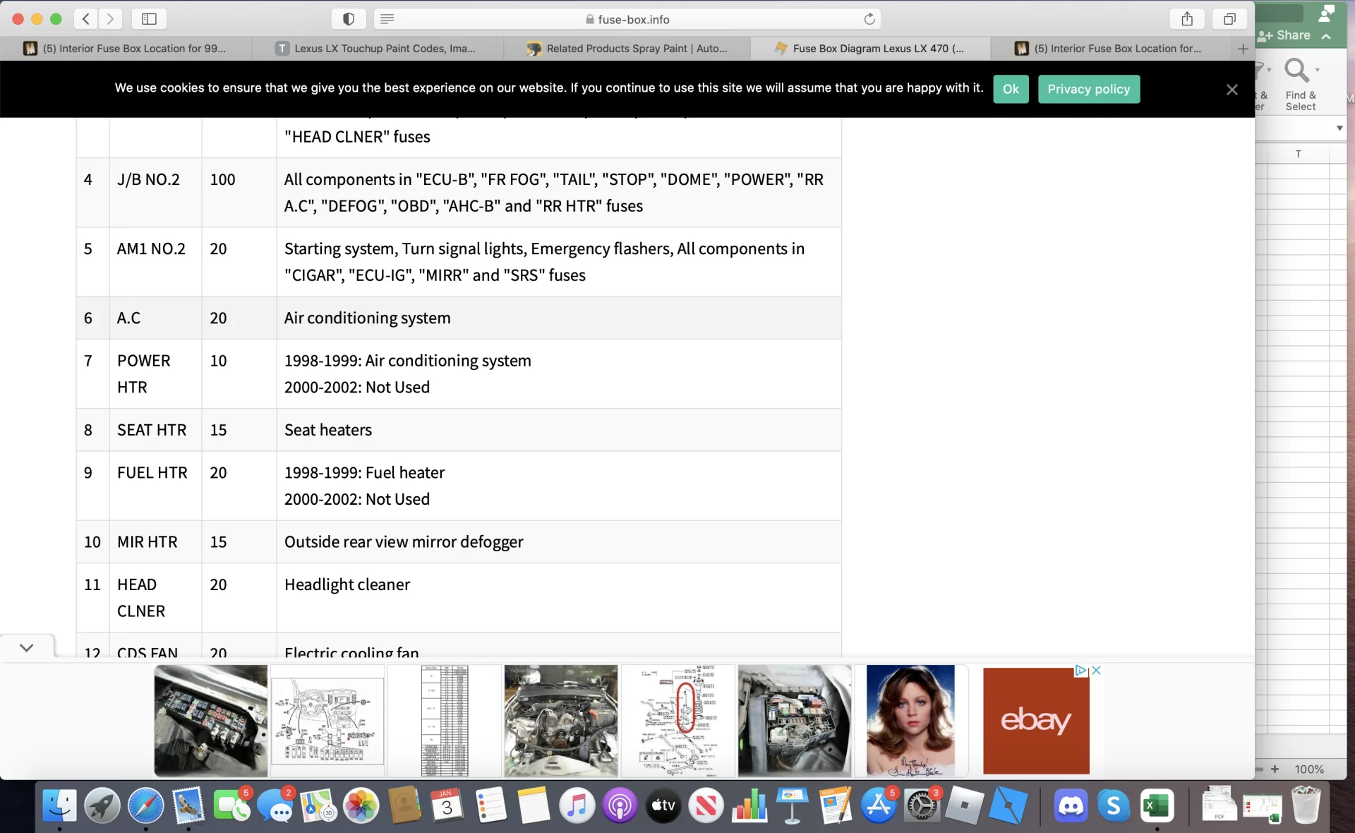

seat heater on early lx470 is fuse 8 under the hood I believe.
Is it the PS Kick Panel? Basically mirrored from the driver's side?
Nah, sorry. That's just a link to the full FSM online, with better year-specific information. I don't actually know anything about the early models except what's in common with the later ones.
But if it's there, then yes. On mine it's basically a mirror. Only a few clips to pop that side loose and check.
