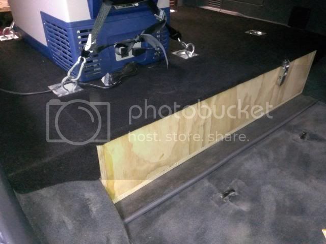

Hello. I am looking to to see if there is anyone interested in getting custom storage built for their rig this winter? I am a Contractor in Harwinton, Ct. SNS Building and Remodeling is the name of my company. We build and finish a lot of cabinetry in the shop and I would like to expand to SUV storage solutions if there is interest. We take a lot of pride in our work and delivery high quality craftsmenship and customer satisfation.

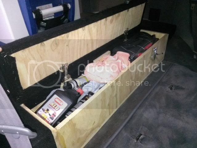

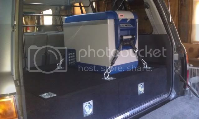

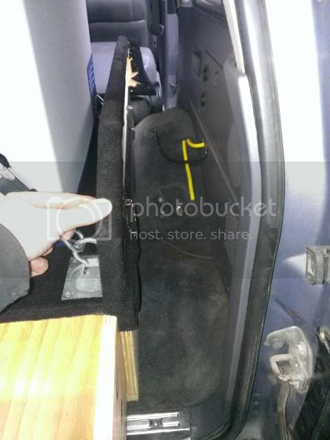

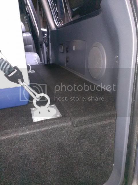

I currently have a storage unit in the back of my 96 Cruiser 80. It serves as a TON of storage as well as a sleeping platform. Both sides flips up on European hinges. Front storage flips up. 2 Large drawers. It is by far my favorite mod I have had in any wheeler/camp mobile
Below are a few pics of my setup that I built last year. I am willing to build to suit individual needs. I did not use drawer slides to cut cost and no moving parts to break in the future. Draw slides can be used as per request. I can build boxes, carpet/etc, and install or just build and ower install. All options are open.
Let me know what you guys think. Opinions/etc. Scott

I like it...nice and clean. The carpeting makes it look OEM.
I'd be interested to know how well the slides work fully loaded. I used 24"Accuride 100lber's and so far so good. My guess is there's maybe 50 lbs per drawer.

There are no slides. The box's are just smaller than the opening. They slide well. Very strong and nothing to break. Also no Big $ to spend on slides. I cleared all the wood with Latex poly to keep them from swelling/etc. I keep then rubbed with bee's wax.
Base price would be $1350 built, carpeted. Cheap installation for local mudders. You lend a hand.

Hardware can ratchet up the cost fast, and sometimes overkill. I think ball bearing drawer glides are overvalued for this application. Don't get me wrong I think the KV epoxy ball bearing glides are a great product, in stationary things like a house, but in an off-road application its hard to keep them true. I have them on my set of AT drawers but I'm going to remove and replace with maple-on-maple runners with 3 coats of butchers wax. If my white LC80 were up here I'd sell the ATs and have Scott build me a set. Under the category of life that "the cobblers children never have shoes"

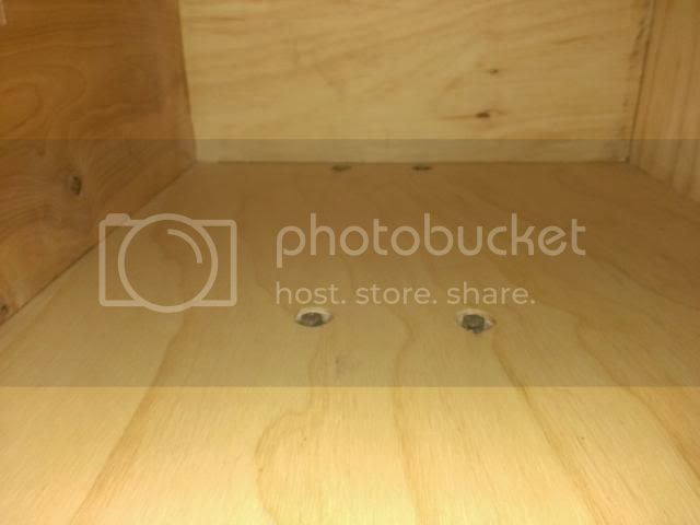

If you roll your rig will this go flying? And everything in it? I see no mention of it being bolted down.
Yes it is bolted down via the third row OEM mount points. The 8 bolts go through the main "box" which is 3/4" material. Def. not going anywhere in a flop.
Flip up side storage and front storage have latches.

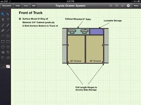

I'm planning to do something similar. One drawer will be full length. The other only 26" deep with an enclosure for two 8" subs with .65 cf each firing toward back seat.
^^^^Exactly what I was describing but with one sub. Every sub has different requirments for cu. ft. needed. Also some need sealed, or ported box. You should start looking for a sub that requires minumul cu. ft. A bandpass style enclosure would be the best so the sub is not exposed at all. This would require a very shallow sub/magnet. PM me if you want to narrow down some details.
****just saw your details under pic. you know of the cubic ft. already. Are you planning on building the system yourself?
Scrowley - yes I am planning on building this myself for my 100 series. I was just hijacking your thread because I'd already made plans for the sub enclosure in the storage system :)
I don't know the total height of the systems you use for the 80 series, but the 100 series are all ~11". This means 8" subs. I'm going with Image Dynamics ID8s. Relatively low power requirements, low price and sound good in sealed boxes ~.60-.65cf. http://www.sonicelectronix.com/item_22182_Image-Dynamics-ID8-D4-V.3.html
Here's a quick and dirty sketchup drawing of my proposed setup. I'm sure you could do something like this, or a setup with 1 sub for the 80-series owner above who was asking.
