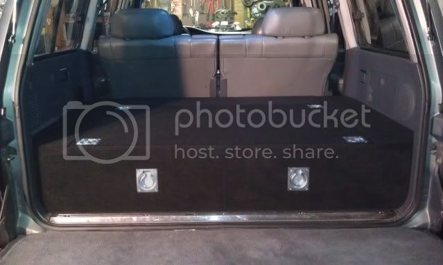

Well I had a chance to build another set of my storage drawers for a local to CT. Mud member. I will be installing in his 80 next week at my shop. Customer made a couple changes and upgraded to locking pull handles, and drawer dividers. It was another fun build. Now I have a template for the 80 series for future builds. These units are rock solid and my favorite mod in my 80. Amazing for camping/sleeping in the back and a ton of organized storage.
Includes:
- Solid 3/4" AC ply construction
- All ply wood edges have 1/8" round over done with router. No sharp edges
- Side compartments flip up for easy to reach storage
- Front compartment (directly behind rear seat) Latch style lock
- European style hinges on all compartments
- 2 drawers. NO slides. Compression fit. Easy to use. Nothing to wear out or rattle. Maximizes size of drawer. Bottom panel of drawers are recessed 1/4" so the drawer glides on the two 3/4" wide side panels.
-4 Ring tie down anchors. Flush mount
-Locking pull latches on drawers. Flush mounted
-Entire unit is finished with 3 coats of acrylic clear coat. Sanded in between coats for a cabinet grade finish. Clear coat underneath all carpeting as well. This unit will stand up to lots of abuse.
-4 metric bolts and washers included for install. Unit bolts down to OEM 3rd row seat holes in body.
-Drawer interiors : 29 1/4" long X 19" wide X 7 3/4" deep
-Front storage behind rear seats : 42" long X 8" wide X 8" deep
-Flip up sides: 40 1/2" long X 8" wide. Not square. Wheel wells are on interior
-unit weighs 130 lbs. Complete.

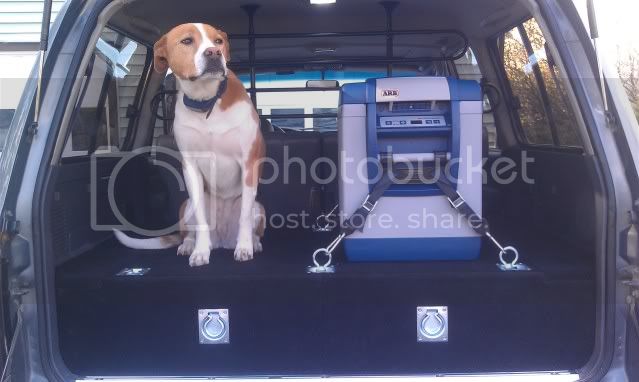

Here is a couple picture's of my unit installed. Built this two years ago. My most useful mod to date. My unit doesn't have the nice locking pull latch like the newest unit.
Also I applied 2 coats of clear polycrylic sealer on the full unit before applying carpet. This will ensure min. shrink and expanding during weather change. This will be standard on all units.
