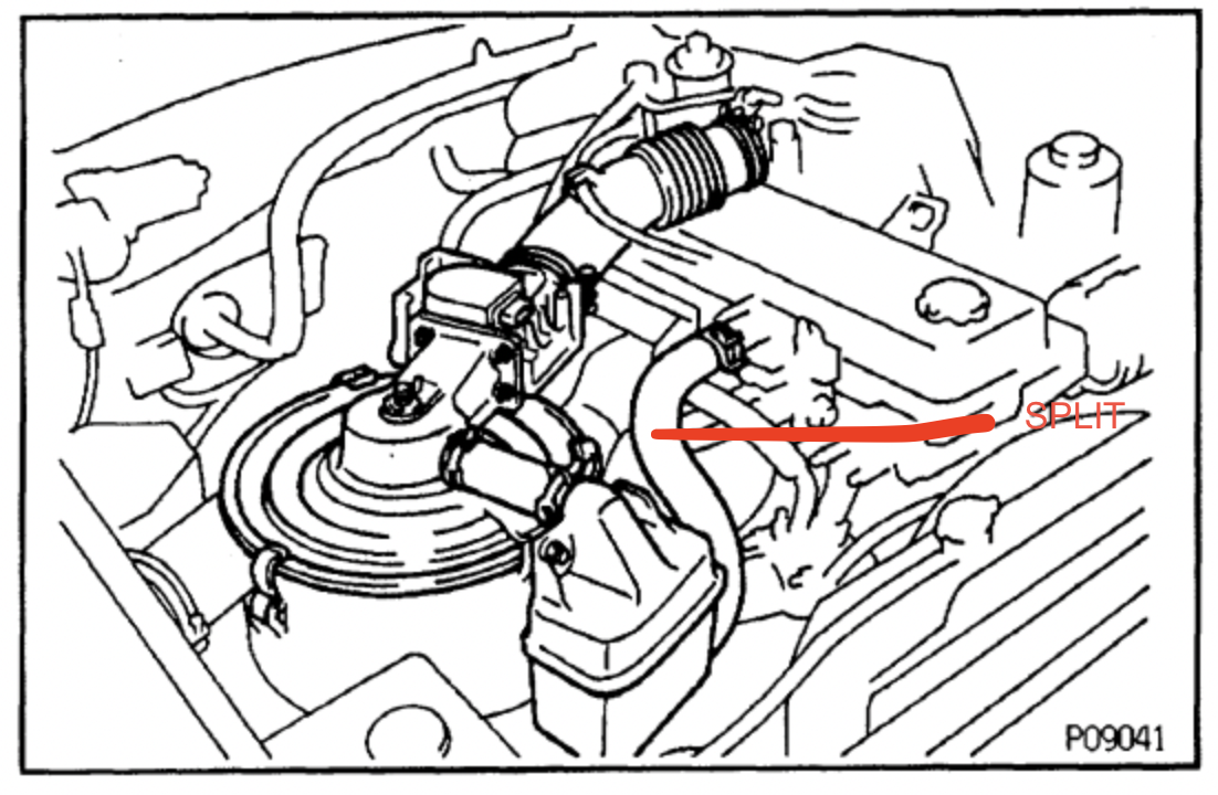

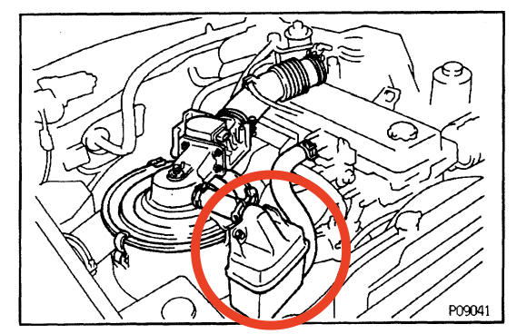

Can anyone point me to threads about the resonator on the side of the air intake can? What is its purpose, what would the impact of "deleting" it be, etc?
I have a split hose, and was wondering if I can remove it, bypass it with a single piece of hose, meanwhile removing yet another thing from my engine bay...

"just a silencer" Required Equipment to pass emission test (Maricopa County AZ-- OBD1) - https://forum.ih8mud.com/threads/required-equipment-to-pass-emission-test-maricopa-county-az-obd1.1285958/post-14476350
Bypass hose - Gates 22627/NAPA 9260*​
* put a piece of old inner tube around the air cleaner port because it is slightly smaller.​
If I want to replace that hose that is split on mine:
The part number was 17342-66010, it was discontinued several years ago.​
There is a V6 Tacoma radiator hose that can be used as a substitute for it. 16572-07040.​
When I paid homage to my PAIR, that box went with it - partly because it no longer served a purpose as a result - but crucially to make room for the second engine room battery.
It's just a silencer...mine has the hose re-routed by PO to delete...just sounds like a low rumble fart if you blip the throttle or on decal sometimes when the PAIR is functioning. Kind of like if you buzz your lips into a Christmas paper roll to scare the dog or kids, but for just a couple of seconds.
Thank you for the insight. I ordered the hose to bypass it and it will arrive later this week. Awesome. One fewer thing to bother with!
