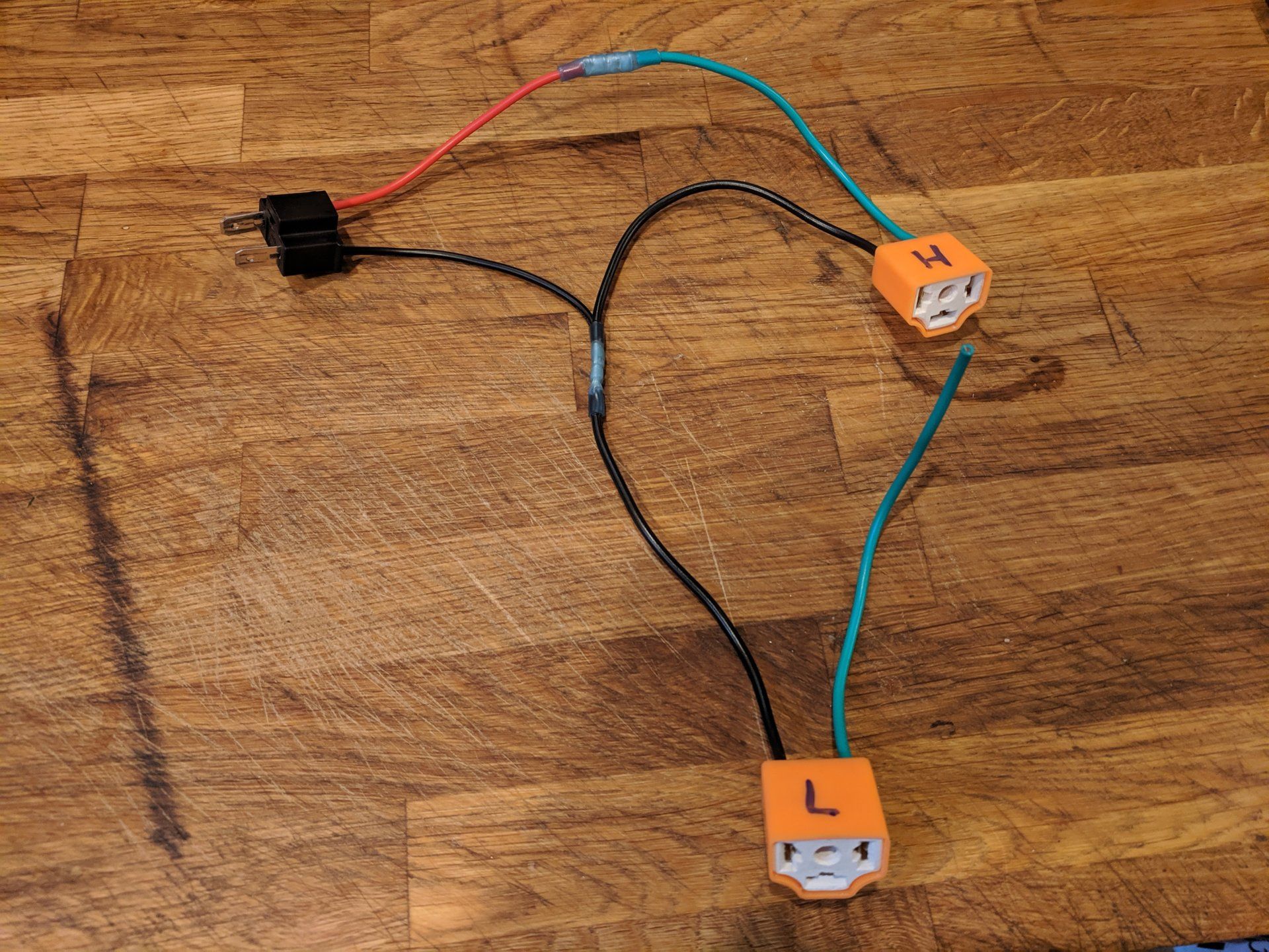

Despite the lack of diagrams, this was wildly easy.
Instructions:
Wire up a harness as seen in the image below:
The black connector plugs into the spot where your high beams once plugged in.
The new high beam connector is marked H and the new low beam connector is marked L. Note that you are no longer using the old connector for the low beams (this is where you plug in a relay if you want to get your high beam dash indicator working again).

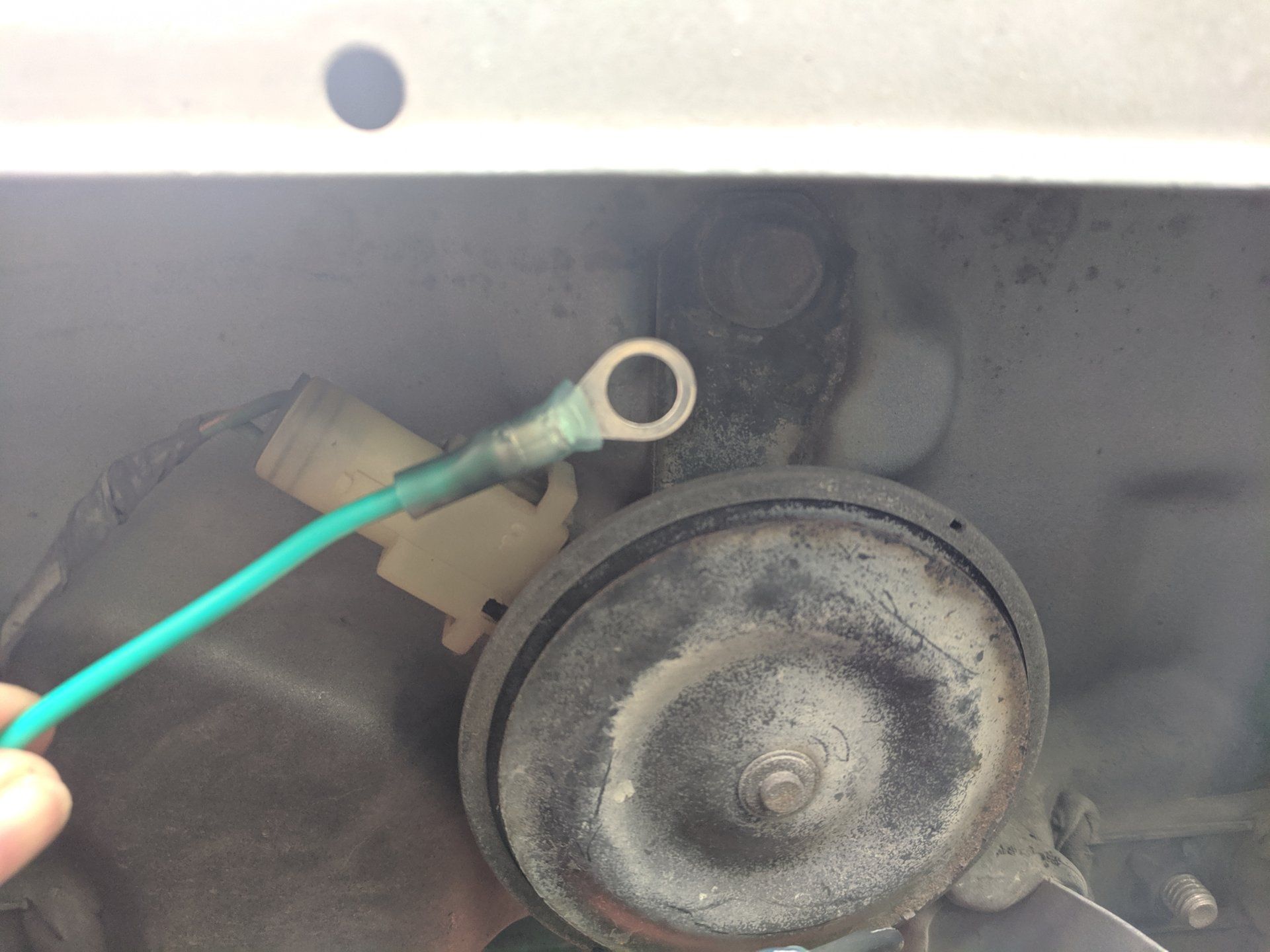

The green wire with nothing connected is your ground. I put a 1/4 inch ring connector on it, and grounded it to the bolt holding the horn in place on each side as seen below:
Worked beautifully! I can finally see at night!

Wow thanks - definitely going to need to add this in. Drives me bonkers that my lows turn off during my highs being on ..
From the looks of it, the stock wiring for the high beams is 16 or even possibly 18 gauge. I suspect 16. Not sufficient to safely handle the 6.6A (~80W) total draw of both a high beam and a low beam being on at the same time for an extended period (and I do a ton of driving on lonely highways late at night where I have my highs on). When I convert my harness, I'll wire in two relays, one for high and one for low, with the relays being triggered identically to the way the OP wired up his headlights. I'll still use the exact same trigger OP devised for the high beam indicator though, since that can easily be tucked out of the way. I still want to get rid of my Tangen harness I built so A) I can more comfortably fit a G34 battery without the relays taking up space, and B) have the low beams stay on when I turn the high beams on.
