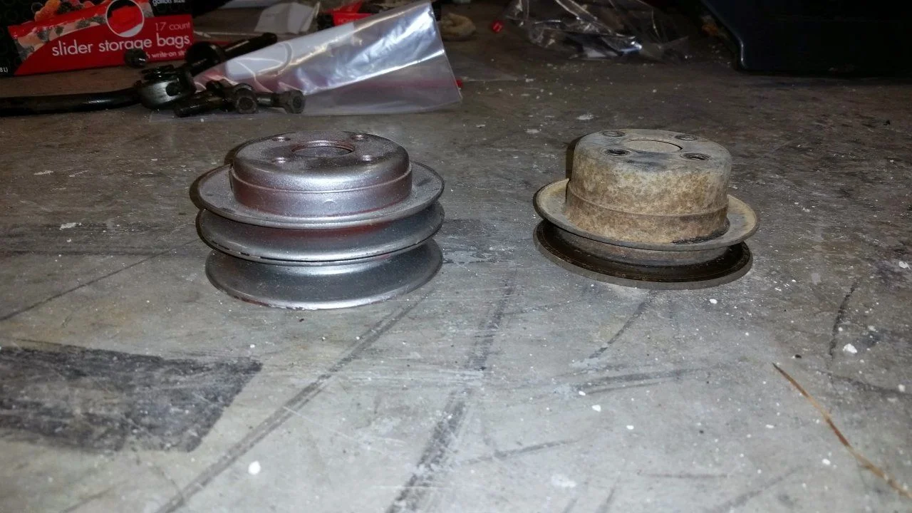

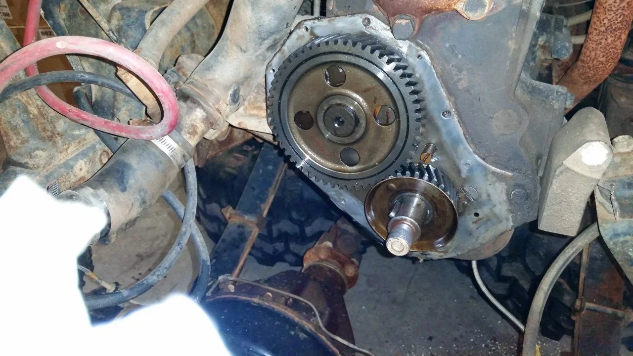

Once i am done then i will combine all the part numbers and places where i got them from to help you. The way i do it is not cheap but steering should not be cheap in my mind. The most expensive part is the gear box itself. If you have that then it will cost about 500 less. I have a used one from my old 60 i will be using. I also have an older F engine so i had to find new pieces for the front of the crank also. That took the longest to find. That being said i will be using a smaller width belt as this set up uses a smaller belt for the steering part.

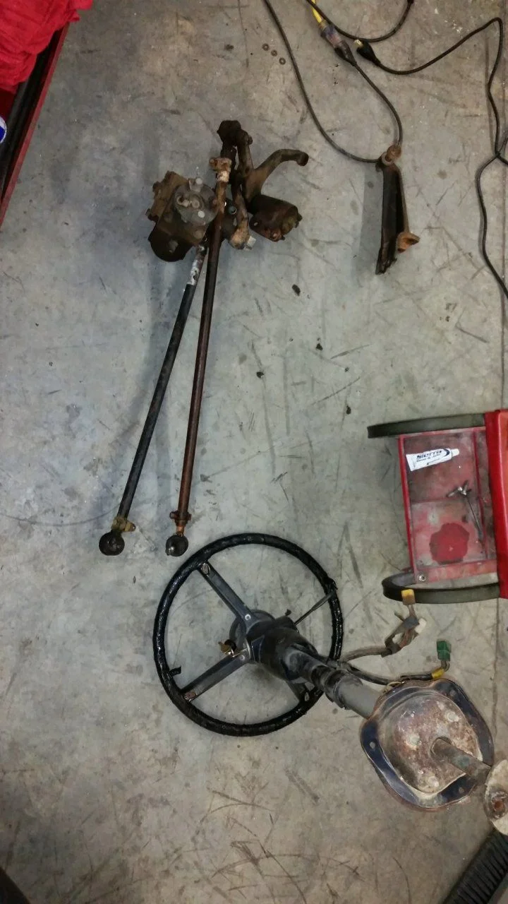

First thing is to rip everything old out. I busted the bottom of my radiator as i was trying to get it to drain. Good thing is that Toyota still has them in stock for my cruiser. Mine was original though so i can not complain.

Power steering pump pulley for a 2F motor : 1984 Volvo 240 from a junkyard.

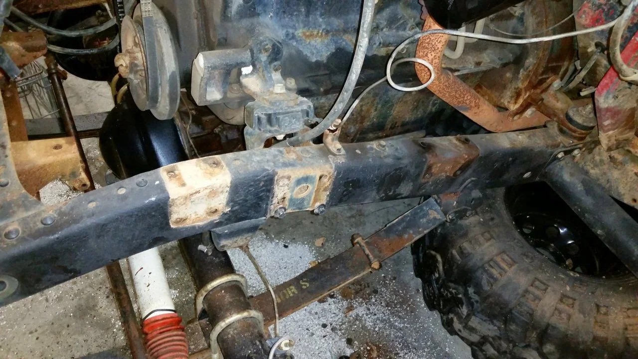

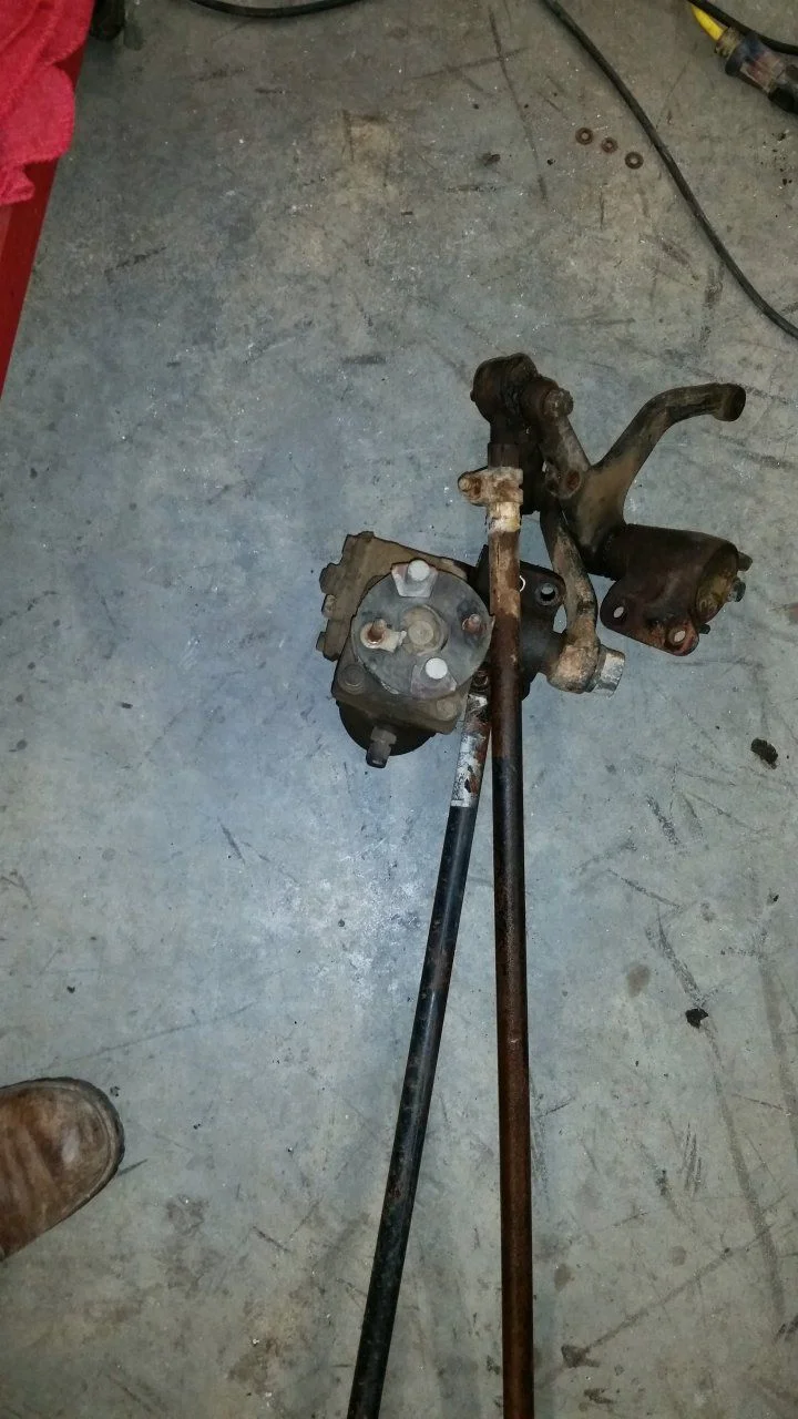

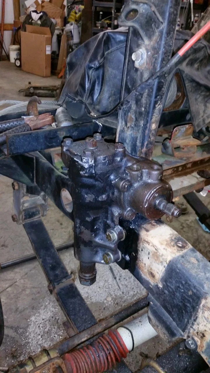

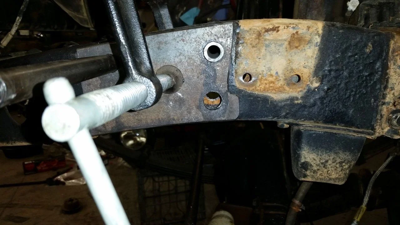

First pictures.

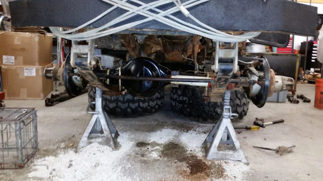

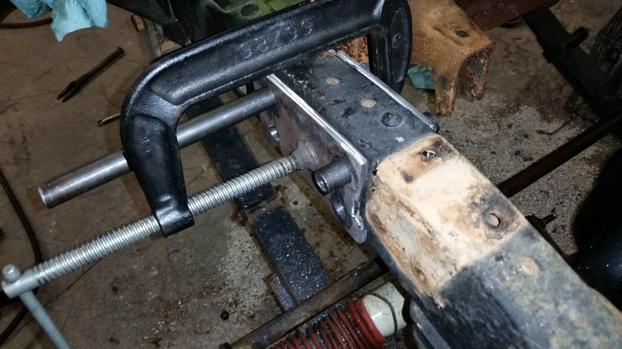

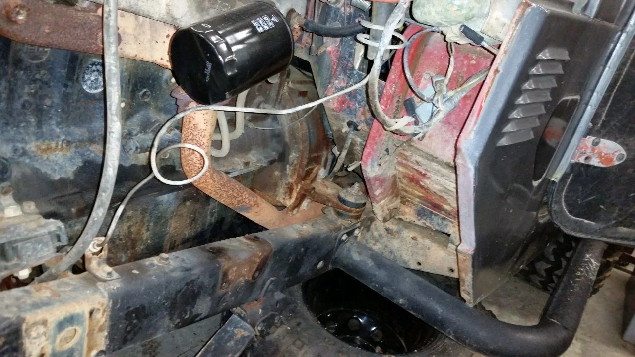

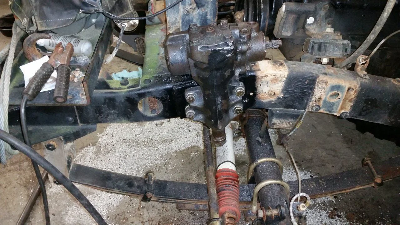

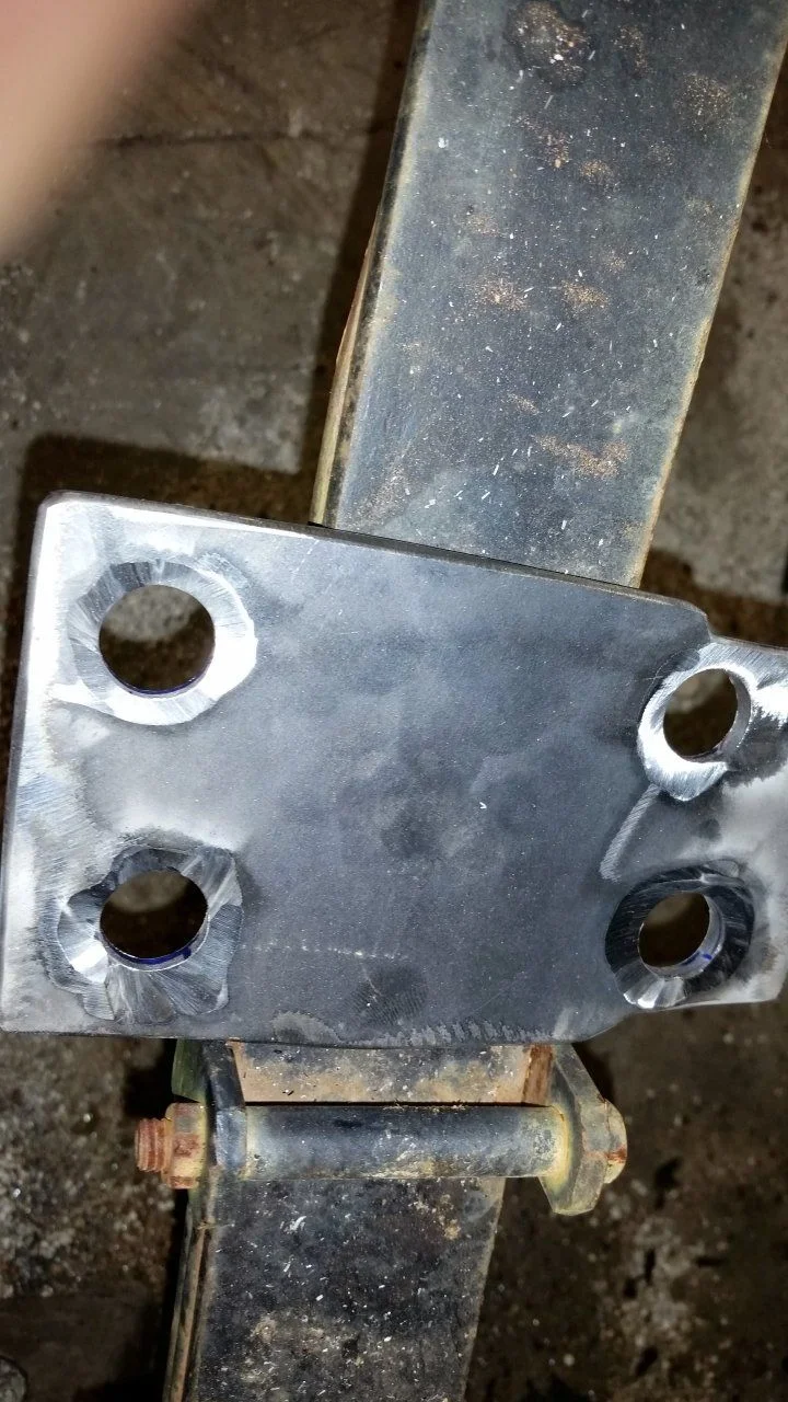

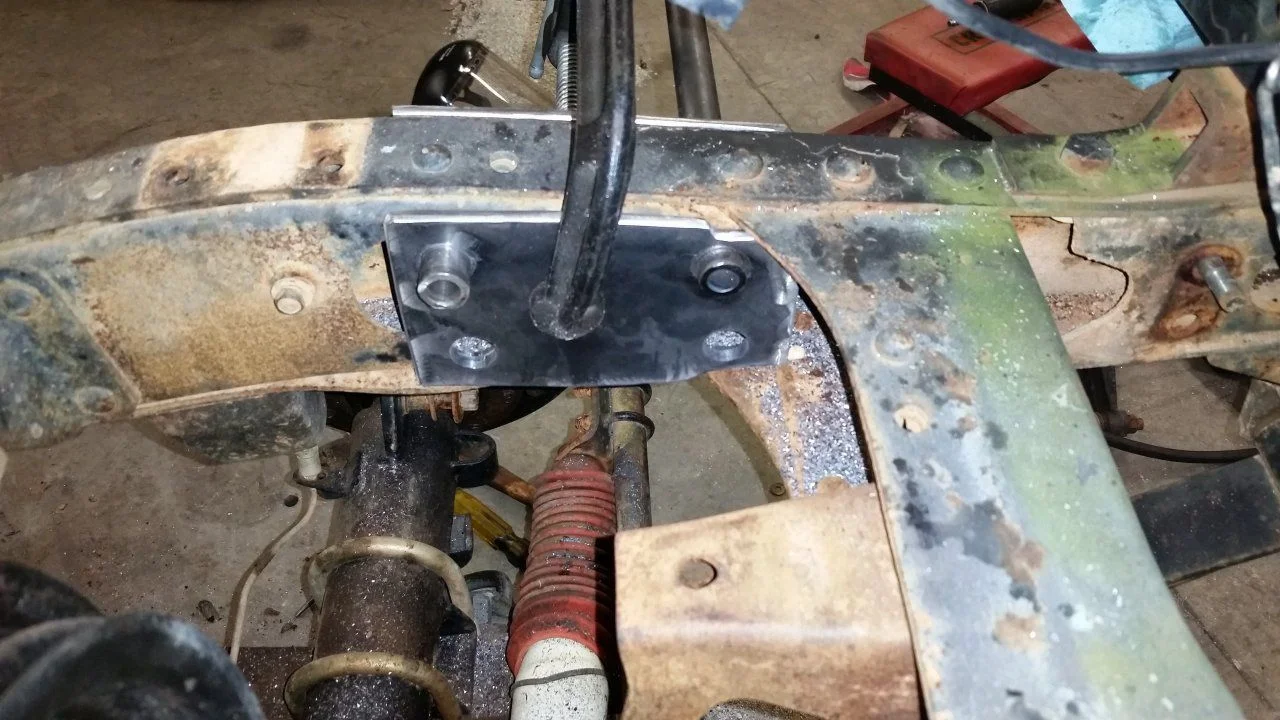

So. Today was spent doing things while I was in there and then fabricating metal for the box to mount to. I sleeve it very well so it takes some time to do it.

I did not mention there but you do need some metal also for the fabrication of where the box mounts. There again are numerous ways of doing that also.
