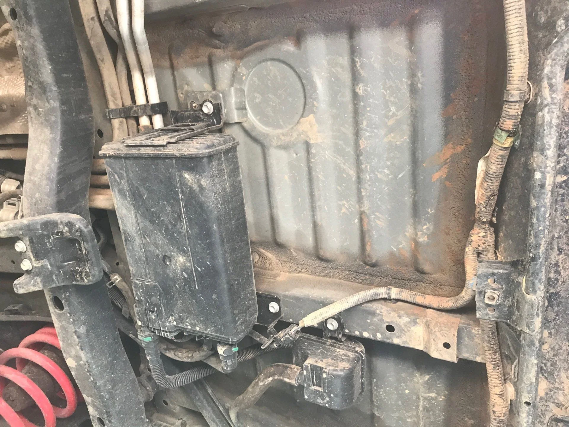

So, the 2018 LC we picked up this summer did not include the factory tire carrier. It was deleted when the original owner replaced the rear bumper with a Slee rear with swing outs.
For several reasons... wife's primary vehicle, towing, etc. I am thinking of adding the factory tire carrier components back in. Looking at the Slee bumper installation manual, it looks like this is an option. The following is a picture of my truck's very vacant rear underside...

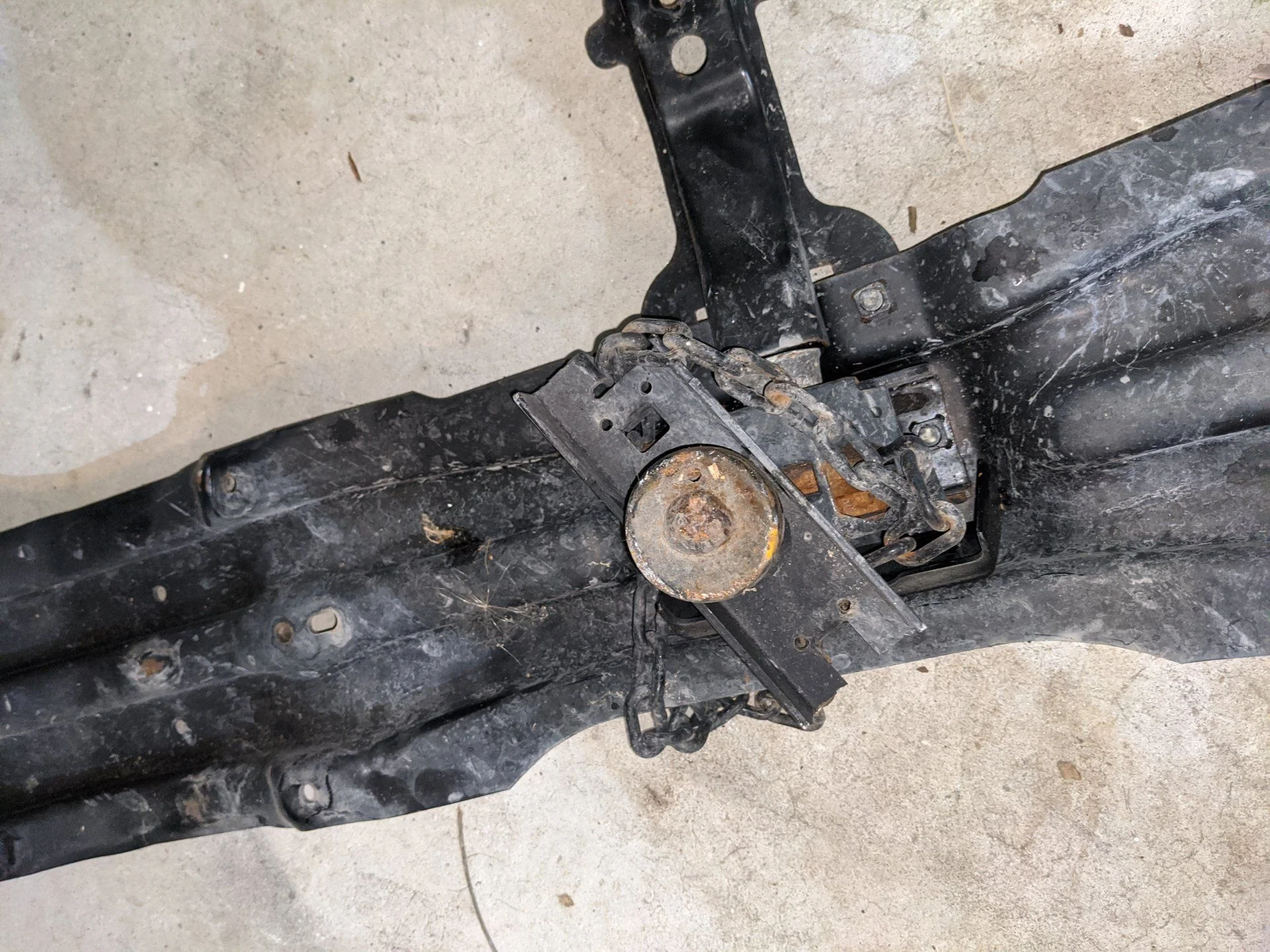

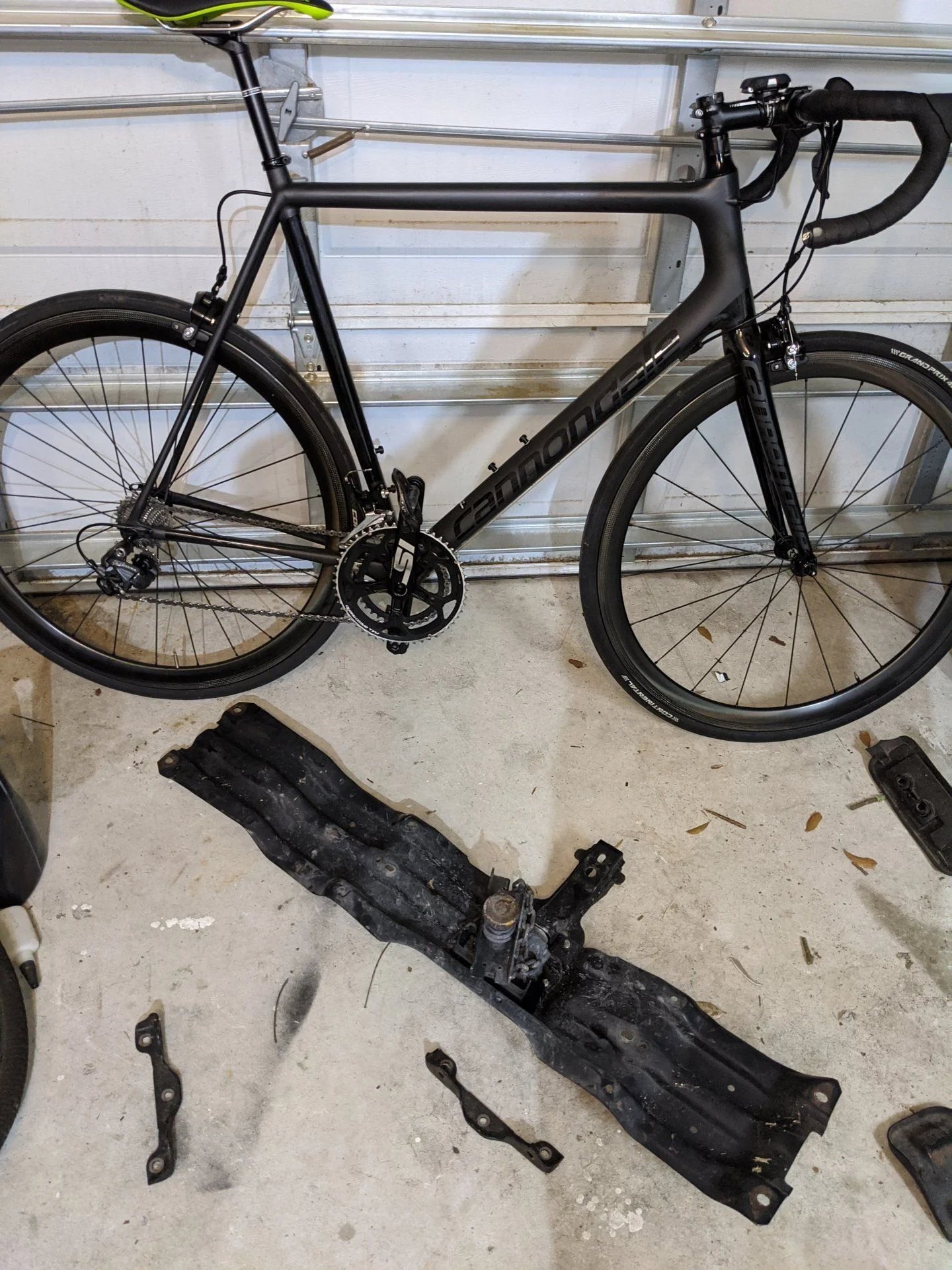

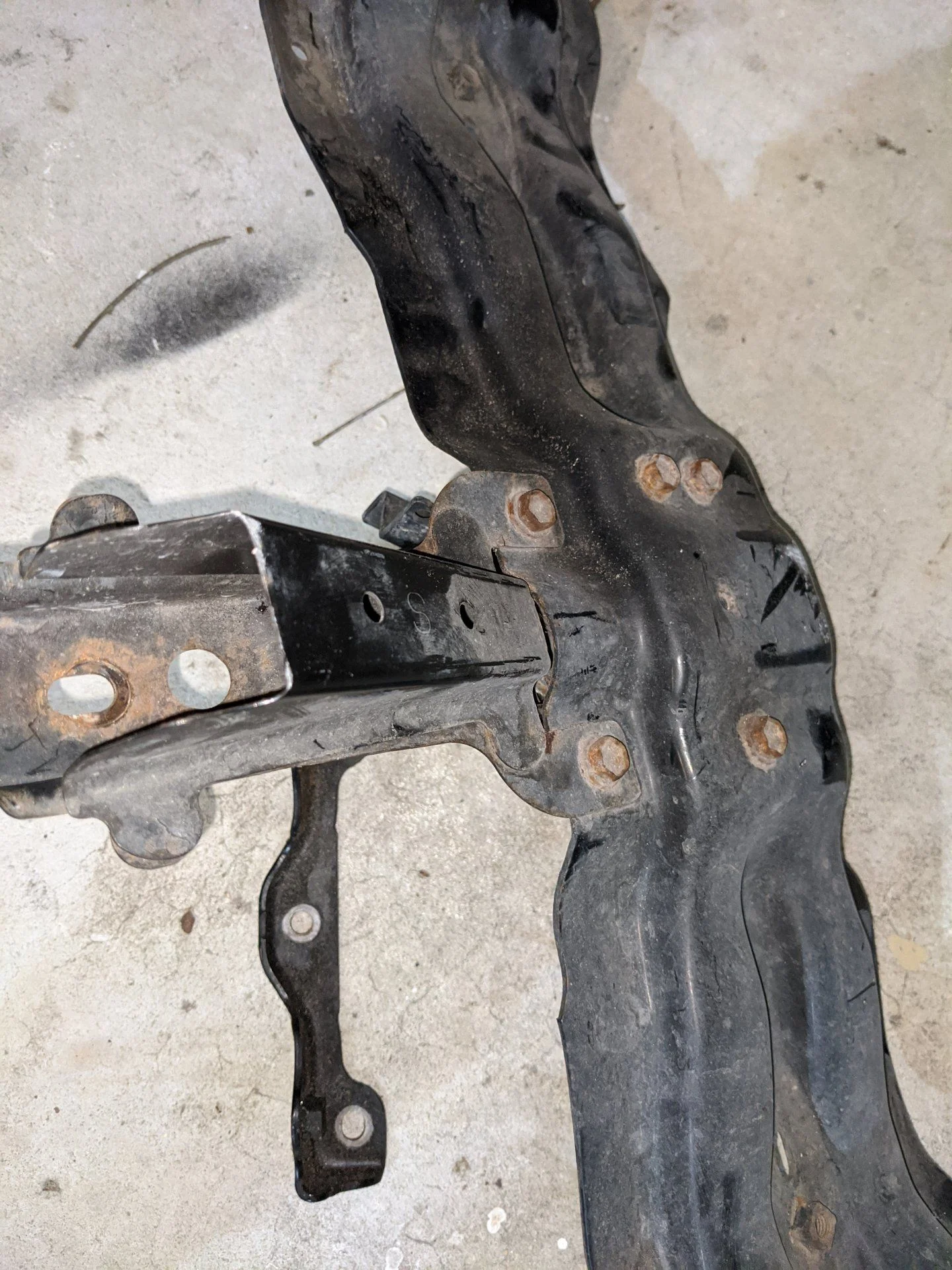

I have one that I am about to throw in the garbage. Pay to ship it, or if someone wants to come pick it up...
@terdrocket PM me some pics. Just want to be sure it is not rusted much. I'd be interested.

I will send a small box of all the bolts that I removed, as well.
I am glad I didn't toss it out and that you can use it.
