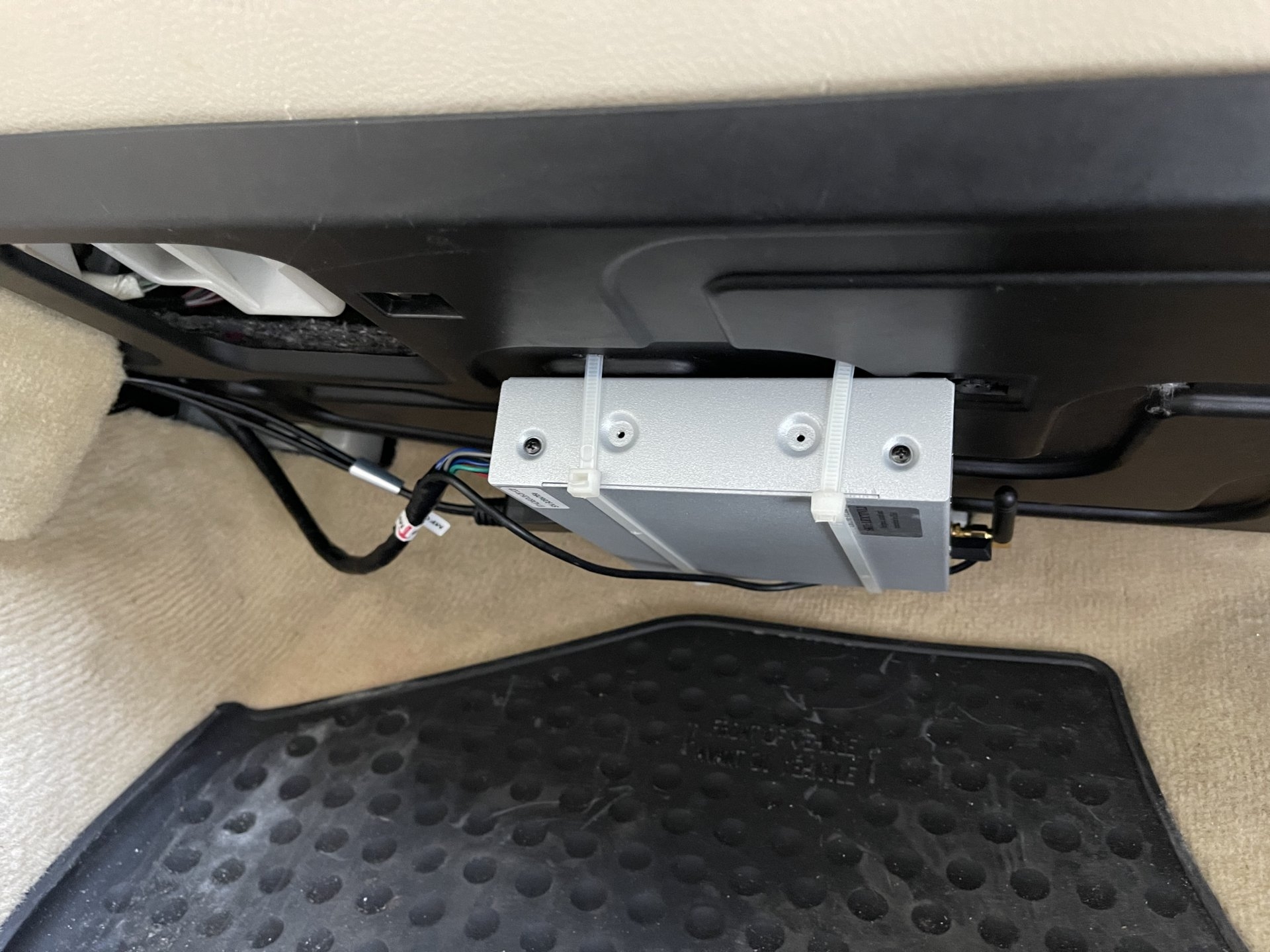

Where did others install the box? I wanted to be able to access the box if needed. I know they suggest the glove box. Anyone else have a good spot to put it?
Installed mine last night. After some debate, I figured it would be most serviceable if I put it under the kick plate.
I put mine at the passenger seat footwell. Seems to work well and stays out of the way. Remains accessible if you need to unplug the main cable. I ended up using the accompanying brackets to drill into the plastic piece, using some small screws for the attachment.
Mine didn't ship with the brackets. Zip ties do the job I guess...still need to do some cable management.
