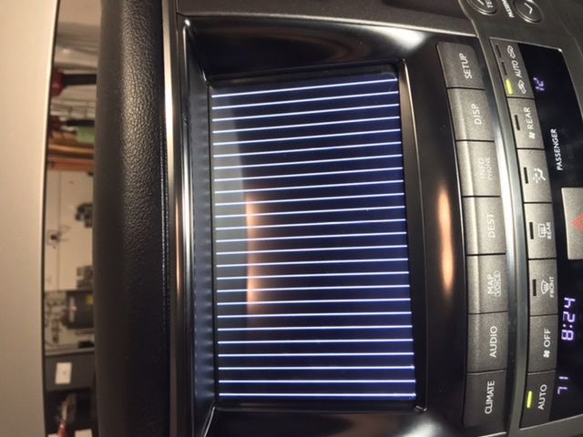

Besides some functionality surprises, I am having one technical issue. The cameras are no longer working. I only see lines when in reverse or I hit the camera button. This has to be figured out or I am sending it back.

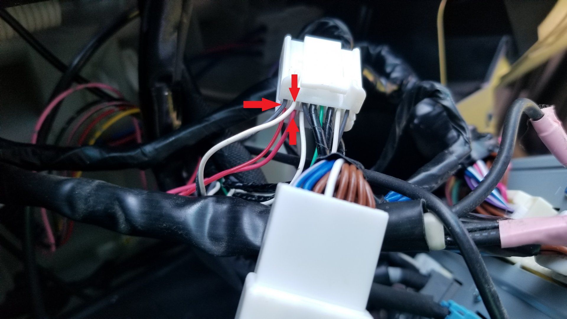

In attempt to re-enable the rear screen functionality for the DVD playback on rear screen entertainment AND not have audio issues while using the GROM VL2, I decided to take apart the dash and execute instructions per my conversation with GROM support. To be honest, I felt a bit uneasy cutting these factory wires but since they were previously left unplugged I figured i would just give it a shot... End result - this fix works. While i have not verified, i'm guessing the only trade-off is you lose the abilty to utlize the Video/Audio RCA inputs for rear passengers on the center console.
See attached picture for instruction. I've identified the wires that need to be cut (or disconnected) - I cut a few inches down from the connector with plenty of room to strip if i ever needed to reconnect.
For a recap, GROM provides a female 16pin connector as part of their main harness - the factory 16pin is supposed to plug into this, but as others have found out and mentioned on this post (and perhaps others), doing this creates significant audio interference. I've been running my GROM with this unplugged for the past 3 months and the only thing i discovered to not work correctly was the rear screen for DVD playback. I actually still find this convenient for my kids, so getting this screen to work ahead of some future road trips has been on my mind. The fix is quite easy and only involes cutting 3 wires from the factory 16pin bundle, then plugging it into the 16pin female end of the GROM harness. PM me if you have any questions - happy to help.

I don't like the idea of cutting factory cables. Anyone know what tool could be used to properly extract those from the harness? Or could they be cut on the Grom unit side of the connector?

@tincan45, i thought for sure someone would reply here but looks like this went unanswered - the tool you're looking for is called a terminal key removal tool or de-pinning tool. you can get these from Amazon. i cut the wires because i did not have the tool on hand and i knew the wires only impacted the AUX input for the rear passengers. GROM advised you can cut on the GROM side of the connector, which i did mention in an earlier post as the "blue wires", but i became wary since that is a "Y" harness.... they're probably right, but i know my solution worked for me and in my head, reattaching a cut simple wire where i know the source made more sense to me vs troubleshooting a Y harness where i do not know all the downstream impacts.
