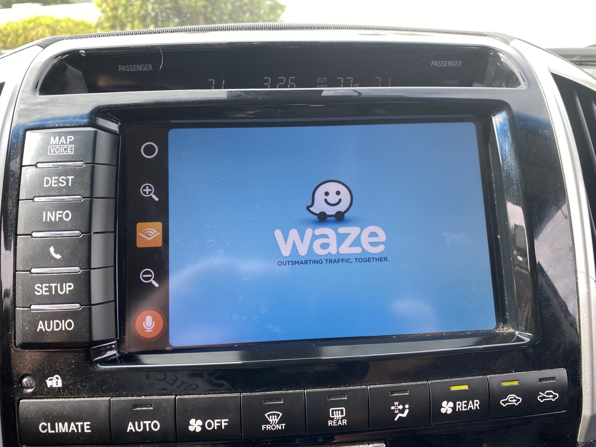

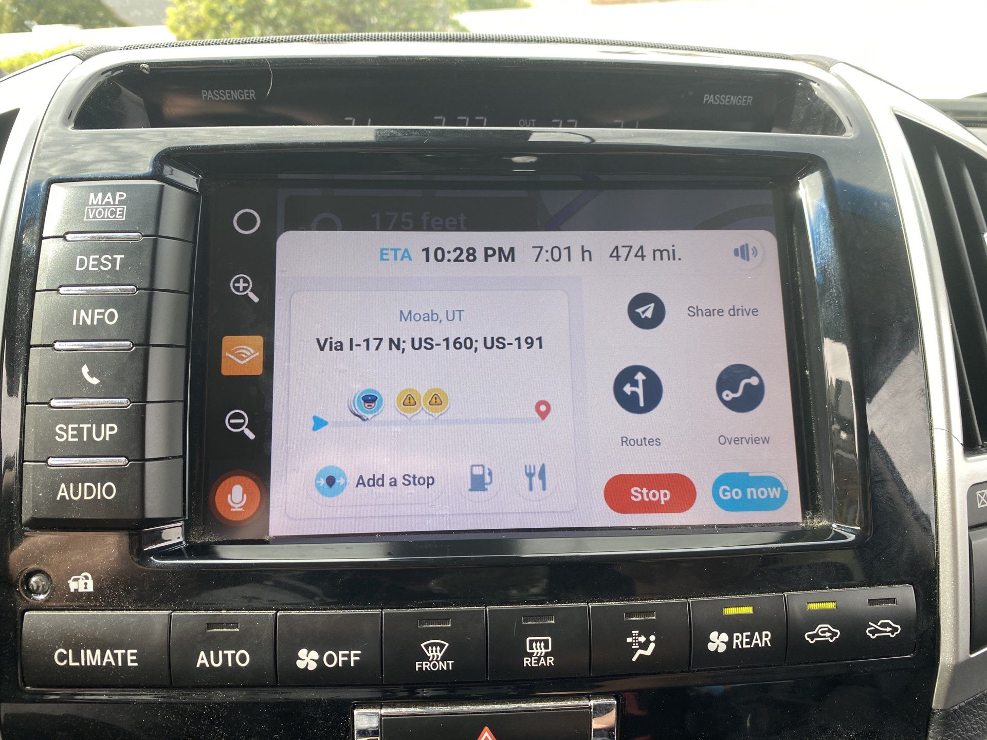

Waze: Works great in both Native Android and CarPlay. This and Spotify are always running on my setup and both have worked flawlessly. Easily my two most utilized apps.
