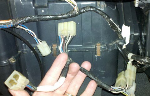

I'm currently adding ac to my 1st gen 89 4runner. I have the evap unit installed and need some help figuring the wiring out. Where does the 4 prong plug coming from the ac amplifier go? I cannot find a matching plug for this? It is the plug next to my thumb in the pic.
Look way up high under the dash pad, the mate to that plug is taped to the wiring harness.
