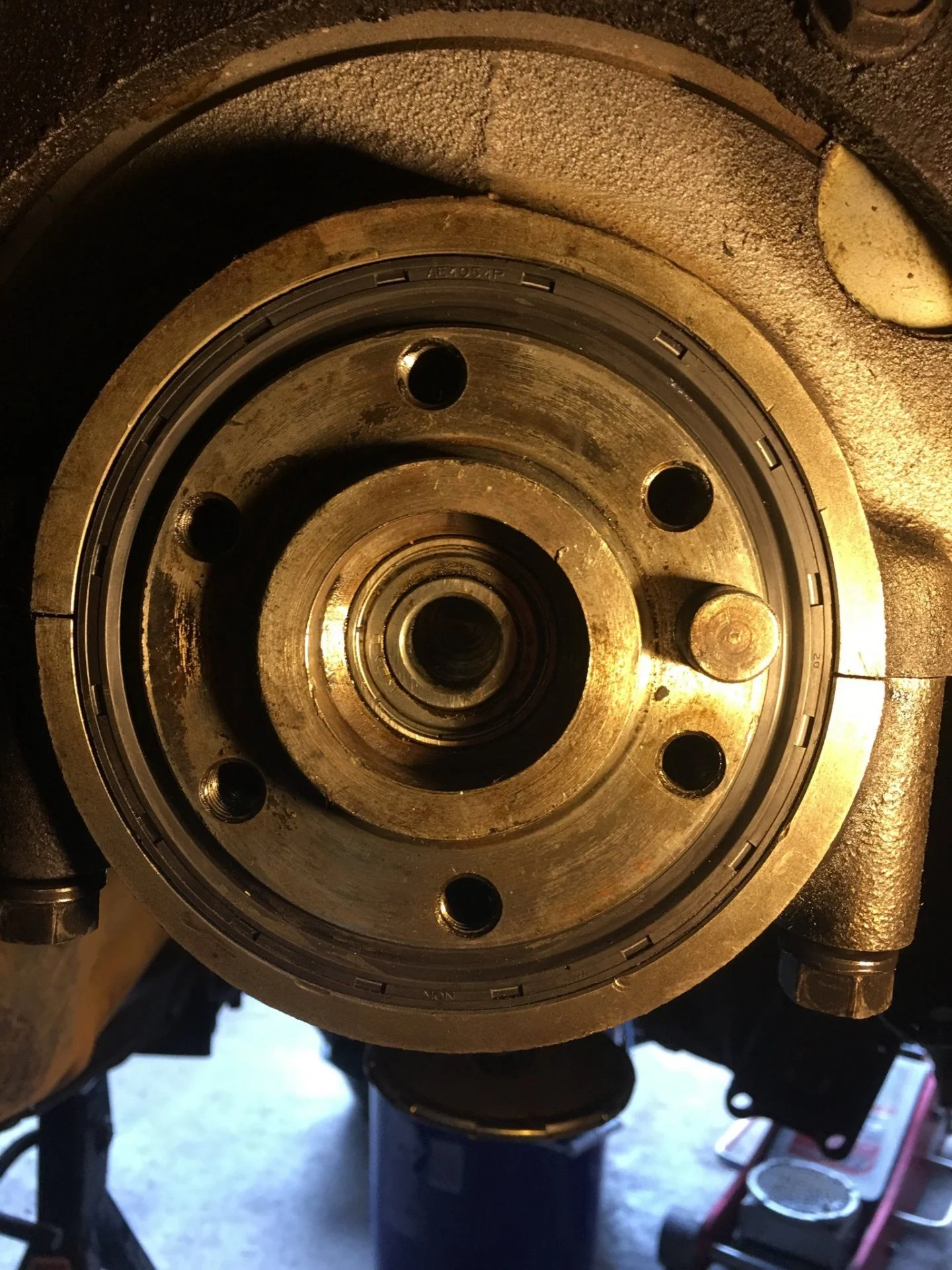

I was careful, I lubricated, but my goodness. I even carefully and evenly pressed and the rubber on the lower right side just started to shave off. I want the peace of mind here, but damn the install is tricky.....
Question, order a new one and pull this out? Or just shove this in?
These seals are expensive. I kind of already know the answer, but can someone who has installed several of these chime in?
I mean - what is the secret? Such a pain in the butt to install!!!
I will have to order another one and pull this one out, flushing 60$ down the drain.
Thoughts?

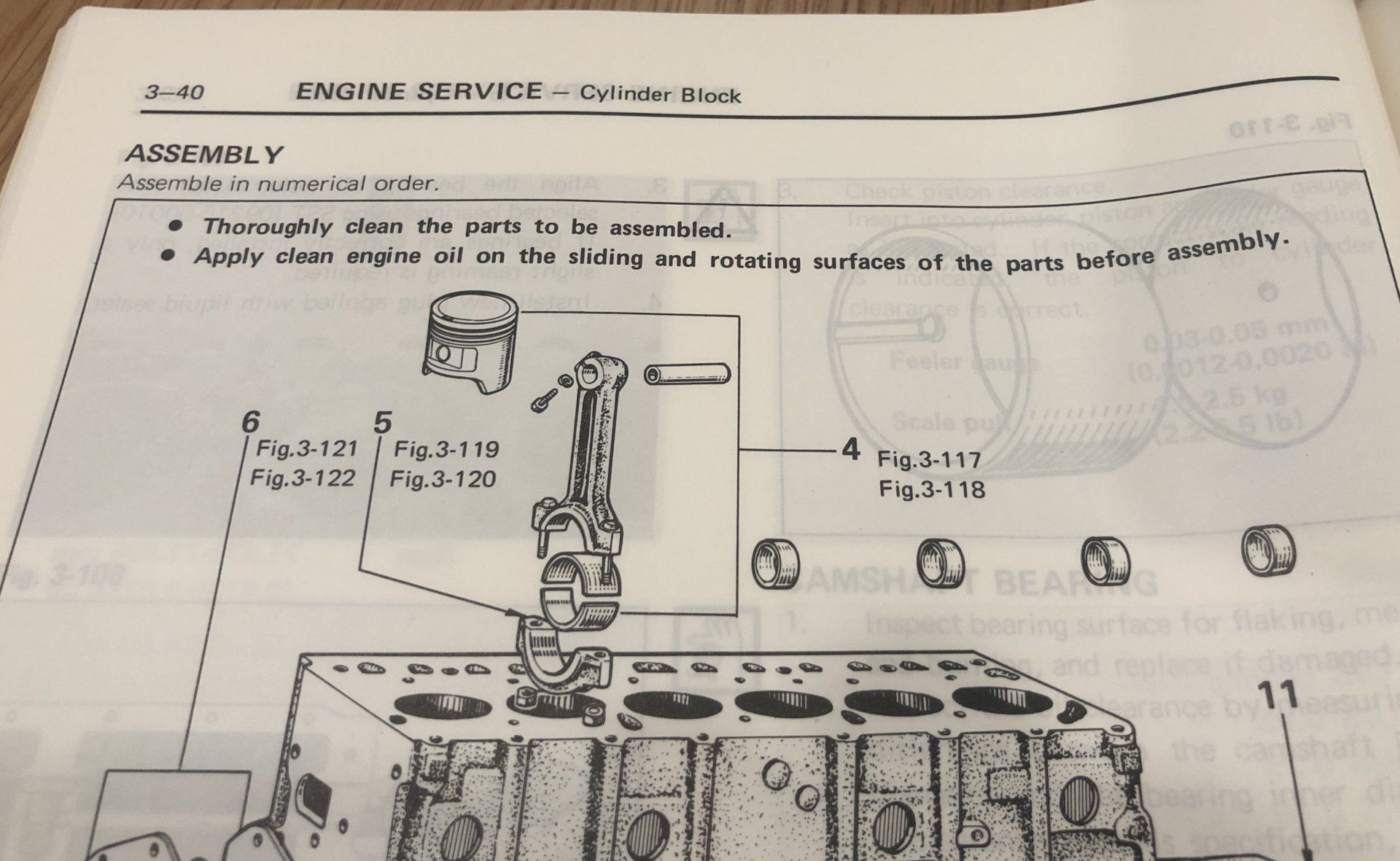

Well now I'm confused. I've been using the 2F fsm from Aug 80, and on page 3-48 of engine assembly it has this figure 3-154 -

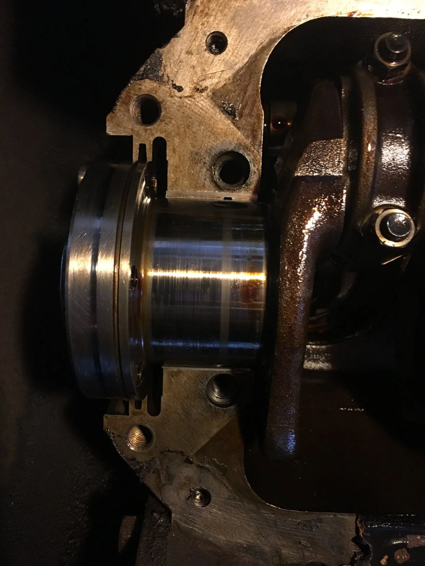

I didn’t use any sealer, here’s a pic of my #4 with the cap removed. Oiled the other half and assembled on my 77 and it’s been fine.

The book I am using doesn’t even have that page or instruction. Here is from my last page:
I have that same manual and have used it many years, and yes it looks like some pages are not addressed. The whole section on reassembly seems to be missing some things that you would expect. I have a PDF copy of the 1984 manual I got free online if you need it (would have to find the link again)- PM me. I got a very nice paper copy from Amazon for like 26 bucks.
