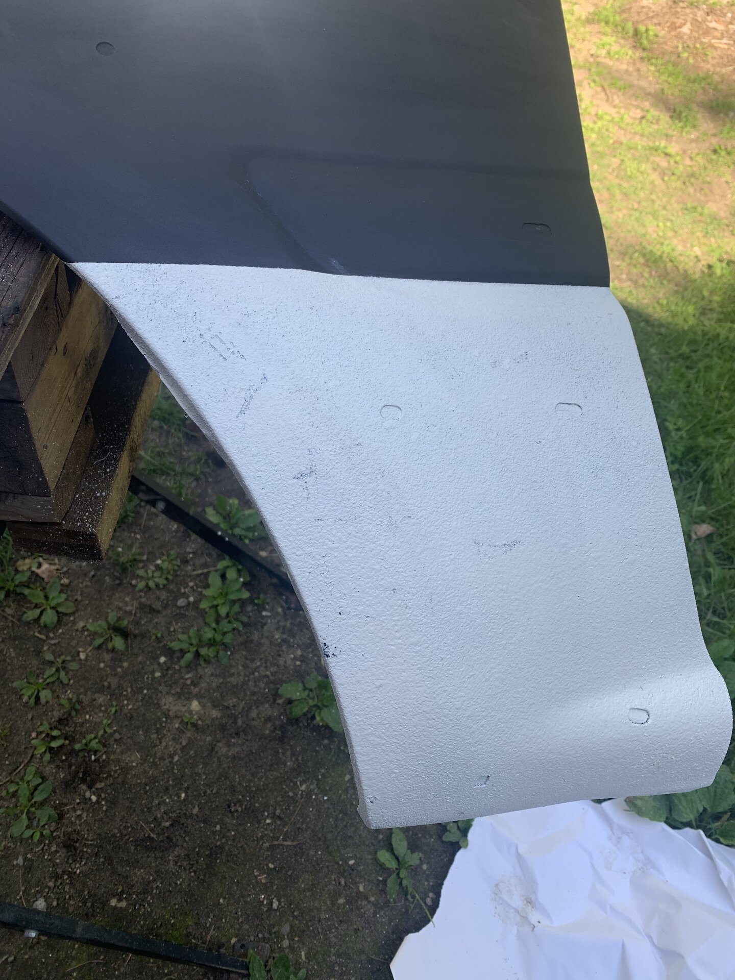

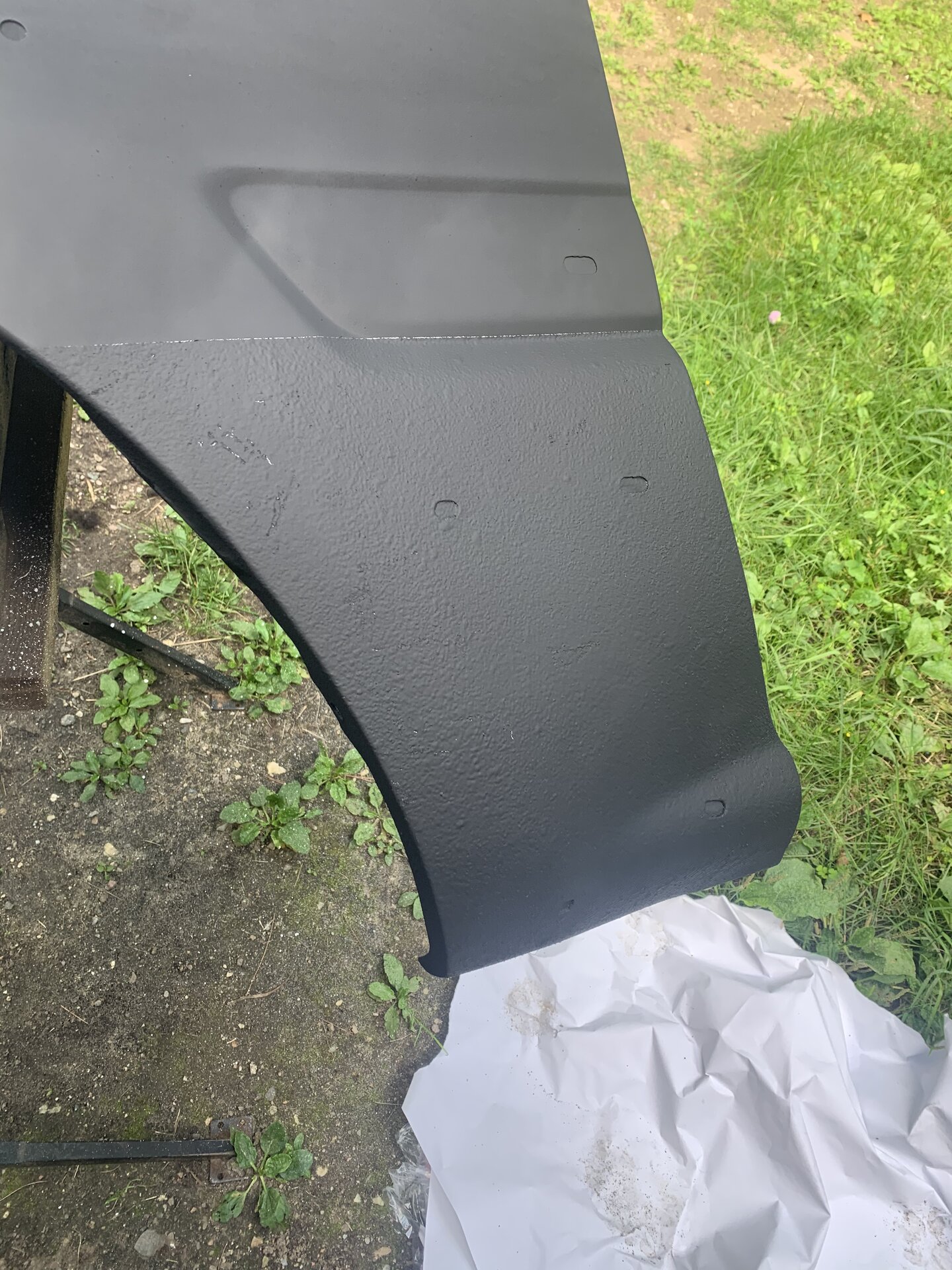

I used this NAPA product to mimic the factory rock guard coating. I think it is about as close as you will get. The stuff I originally used had a texture that was too rough.
This is it applied over the rougher texture stuff.
