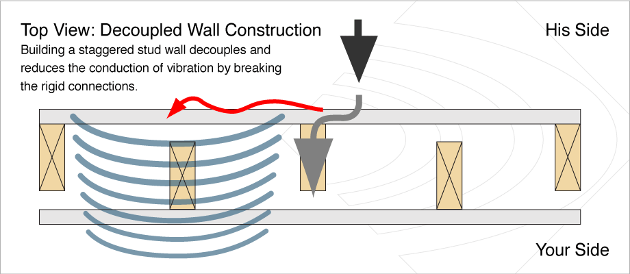

1. Decoupling
The first element is decoupling. Keep in mind that sound is nothing more than a vibration. The vibration will travel (conduct) easily if there is a nice solid direct pathway to follow, like the string between two orange juice cans. If we cut the string, however, we “decouple” the pathway, and the sound vibration stops (no conduction).
Obviously for soundproofing, we want less sound vibration to travel from one side of the wall to the other. It is therefore enormously beneficial if we decouple the framing in our walls (and ceilings). It’s simple, inexpensive and highly effective. Let’s look at different methods of decoupling:
  • Double Stud Wall with Green Glue
  • Soundproofing Clips with Green Glue
  • Staggered Stud wall with Green Glue
  • Resilient Channel with Green Glue
You can see that all of these methods offer varying degrees of separation of the drywall on one side from the drywall on the other side. Again, all of the walls shown are superior to a single stud (common) wall.
We can see how decoupling the wall studs limits the vibration trying to conduct through the wall. We are left with the airborne transmission represented by the blue waves. Note how decoupling does not affect airborne transmission.
So our decoupled framing reduces a good deal of vibration, but not all. We need to continue to the other elements to reduce more.

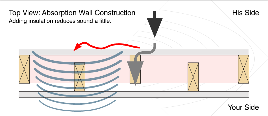

2. Absorption
Air cavities will resonate. Ever “heard the ocean” in a seashell? Ever blow across the top of a bottle and heard the sound? Both sounds are actually the trapped air resonating. A hollow wall will also trap air that will resonate. When the wall is vibrated by sound (from your neighbor), the air in the wall cavity is also vibrated, just like a drum. This air cavity is another means for sound vibration to travel from one side of the wall to the other.
As you can see, even though the wall framing is decoupled, the vibrating air cavity will still transmit some sound through the wall between the wall studs. Simple fiberglass insulation will absorb some of this (absorption).
Insulation helps, and should be done if possible, but the vibration reduction is smaller than the other 3 Elements. You can use other insulation materials as well like cellulose, mineral wool, and recycled cotton. The key is to keep the density low. Don’t compress or pack the insulation.

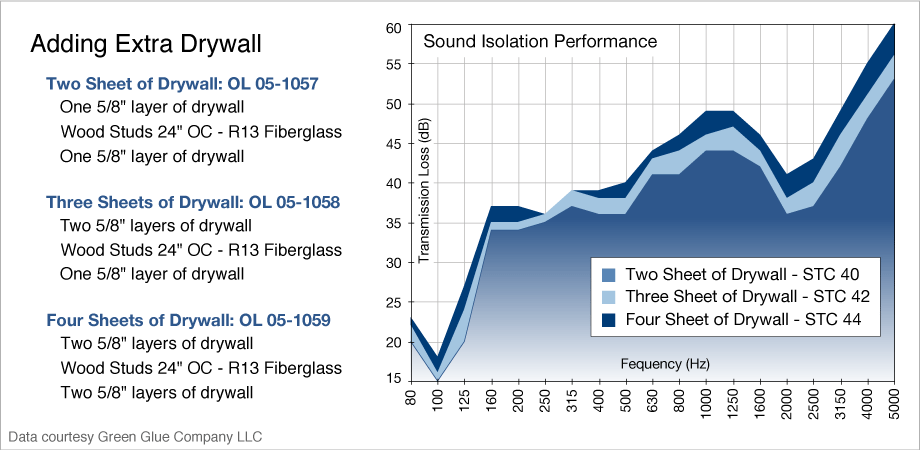

3. Add Mass
A very important element. In this case, we simply mean make the walls as heavy as you can. Common cost effective choices for heavy materials include Drywall, Plywood, OSB, and Cement Board.
For sound to conduct through a wall, it has to actually move the wall ever so slightly . A heavy wall is harder to move than a lighter wall. Simple as that. Drywall is one of the lowest cost sources of mass available. Best to use two layers of 5/8″ drywall. It is very important to note that a heavy wall will still vibrate, just not as easily.
Note that adding mass improved things. It’s harder for sound to move this heavier wall. You will still hear low frequencies (bass) quite easily.
Simply adding more drywall does not get you a lot improvement in the low-frequency bass.
  • Two Sheet of Drywall OL 05-1057
  • Three Sheets of Drywall OL 05-1058
    Four Sheets of Drywall OL 05-1059
This graph illustrates the performance gains from adding additional drywall. While adding mass obviously helps, it doesn’t help as much as we need.
