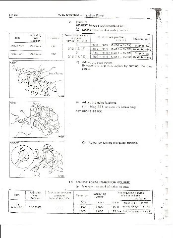

Are you refering to just truning the stop screw or a full adjustment of stop screw and guide bushing?
Here is the page on it from the manual.
It's pretty crappy quality, sorry guys, I guess I'll have to get a star one of these days.
