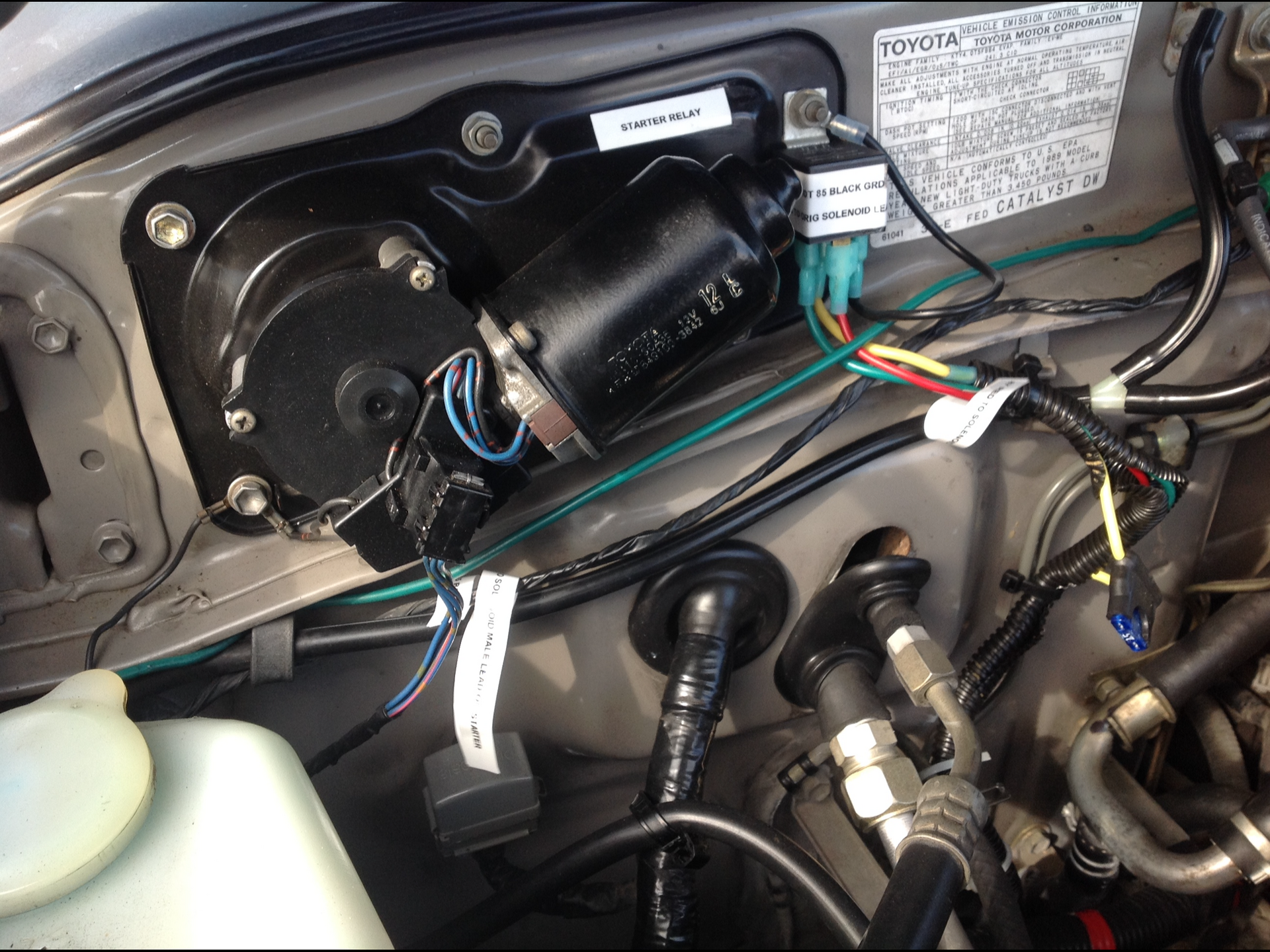

You don’t need a new starter, you need more juice TO the starter. Buy a 4 pin relay, switch to the relay, relay to the battery & then over to the starter.
It is a band aid for 20+ year old wiring. A band aid that has lasted me 15+ years on my 60 & still going and 10 + years on my 62 before I sold it.
I did think it was a matter of not getting enough power to the starter, but if this was the true issue, shouldn't the car have started when we bypassed and went straight to the starter in a jump start from another vehicle?
Interesting idea though, might be something to look into.
