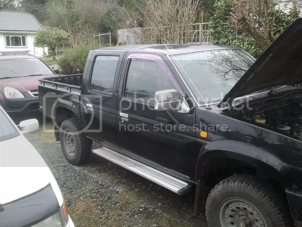

It's not a cruiser, but, it's kinda fun so far. Someone will undoubtedly say, " Not a cruiser?? Datsunacceptable." Yes yes, bravo.
The Mutts like the back seat. I've wanted a pickup for a while, but with dogs, it had to have decent back seat room. (I don't carry dogs in the beds of pickups. Should be illegal.) And I wasn't about to spend 10k on a 15 year old toyota tacoma.
So here it is. Just doing some poking around today and cleaning up a smidge. Has power windows and door locks which I'll have to mess with. Rear passenger window is wired backwards..(yeah, that's not annoying at all) and the passenger outside lock isn't connected. Nothing major, plastic clips etc.

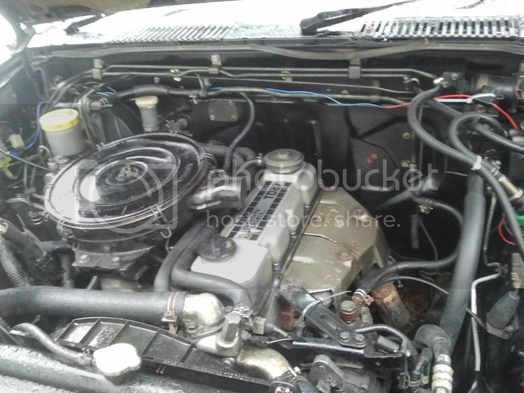

Here's the mighty sewing machine. I have a powerful urge to throw that s***ty little airbox as far into the bushes as I can. Friend of mine has a Donaldson I may have to see about getting that from him. I don't like the cone filters, but it would certainly be less restrictive than that piece of crap that's in there now.
Lots of room for a turbo...:hillbilly:

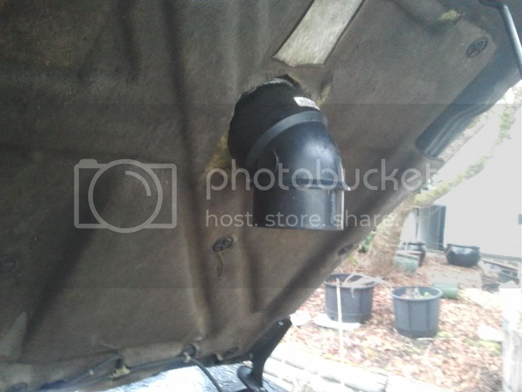

At least the butt ugly scoop puts a little more air into the engine bay. You should see the stock air snorkel that goes out to behind a headlight. You could maybe get 3 fingers inside. Dumb.

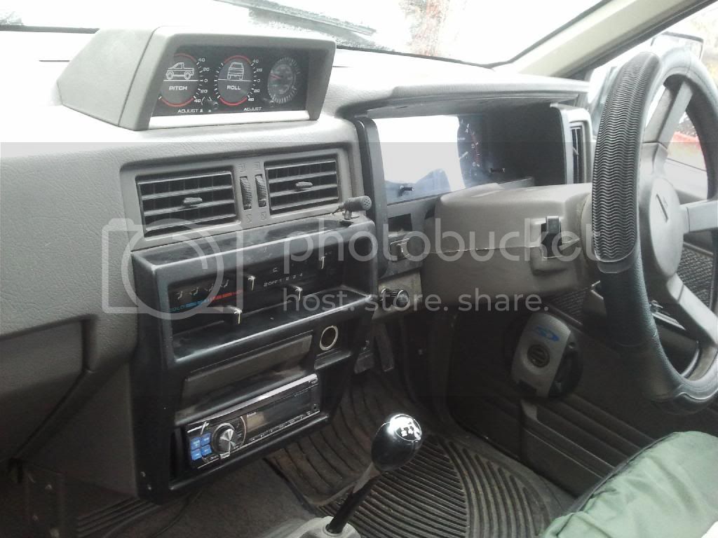

All this crap seems to work. Maybe a good spot to put the pyro. The roll and pitch gauges work, but who really cares??
Wtf. It beeps when you push some of the buttons.

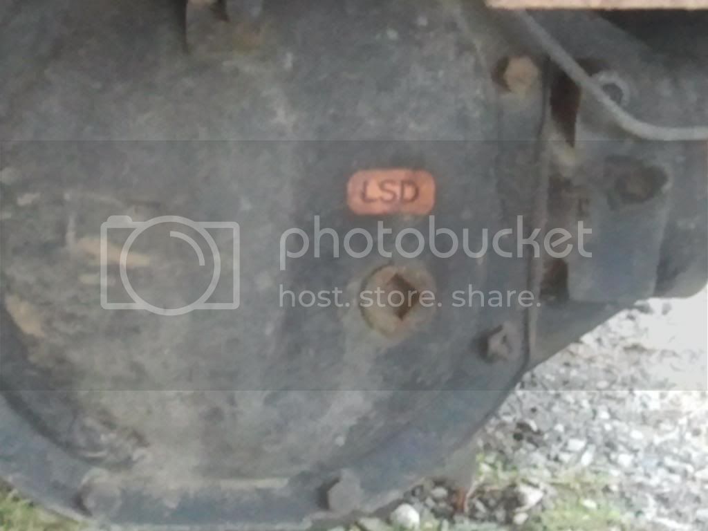

Nice little truck Ryan. Engine bay cleaned up real nice. LSD is a bonus. Hope it serves you well, and looking forward to seeing what you do with it. Still can't believe how cheap that thing was.
LHD conversion would be pretty cool, but probably a fair bit of work. Engine has a mechanical injection system? or electronic? Is the engine timing geared? chain? belt? Thermostat location reminds me of a B series engine.
