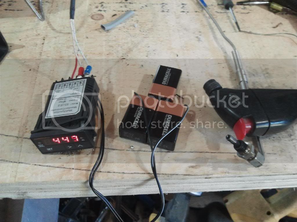

Yeah, not just the number but how slow the gauge was to react. Clearly something wasn't right.
I dug the auber out to do a side by side....note the scientific testing aparatus.:hillbilly:
Out of curiosity, I hooked it up to just a pair to see if it worked on 18v....it did. So then I had to try 13v. and yup. appears to work just fine....ordinarily I'd email the company in question and see if it's kosher to run it on lower voltage, (the flashing led is good for 8-32 v or something like that ) but my last communications with that "Suyi" person who answers emails there were largely in "all caps" and rather impolite. Long story. Won't be asking him(her?)
Don't most of those little 24/12 jobs work both ways? Just a gauge from auber is pretty cheap, but I'd have to get someone else to order it...doubt they'll send anything to me again after our last conversations...:lol:
So yeah. It's all installed, and to be honest, looks better than the isspro anyways. Switch and blinky light above are for the afterglow. Blinky light is freaking bright, so pretty hard to ignore when it's on. still may find a timer relay, but low on list.
And now that glow and afterglow function, and I advanced the timing a bit, cold starts are much better. It always caught and idled, would just start to stumble after a bit with no afterglow, and could fumigate bc place when you revved it up.
Took it for the obligatory "drive the grandmother out of it" test drive with gauge installed. Got it up to 1100 and change on the henry road hill. So pretty much what you'd expect, a lot like a 3b. There's room for a bit more fuel, but I'll leave it for if or when I turbo.

Thats pretty cool that the 24V Auber works on a 12V system. A lot safer to try that then attempting to run 12V Auber on 24V, haha.
The DCDC converters I'm familiar with definitely don't work in reverse; you could try though...haha. The magic smoke might get out.
Your install looks nice and clean. I like the after glow light/switch too. Looks factory even.
Sounds like your EGT's are nice and safe. Funny thing, when I first got my Prado it took nothing to get it to 1150 POST TURBO :eek:. And people wonder why the heads crack...

Not too surprising, I suspect they use the industry standard 78XX for voltage regulation. They would likely need 5V for the electronics inside. 78XX (X = Volts you want) can regulate from 30-2V more than what you want.
They're also great for projects that you want to regulate from 24->12V ... only catch is they aren't for "high" current applications... usually less than 1.5A unless they are in a tin can case or something like that.
Yeah, you're probably right. I design electronics for a living, and am very familiar with the 78xx linear regulators. Sometimes products have transient suppression that is designed for a specific input range though. This can go bad when raising voltage and the protection part starts to conduct.
On a side note, the DCDC converters like the one I linked to use switching regulators, so are very efficient and run relatively cool.
