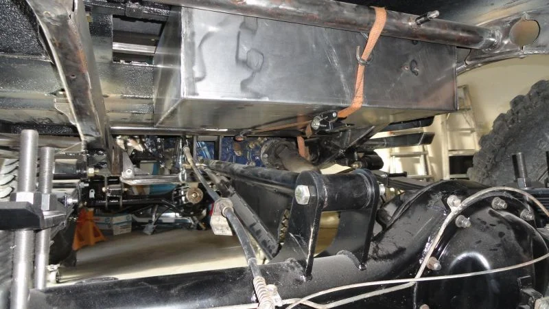

Costume build tank around 40 Gal.

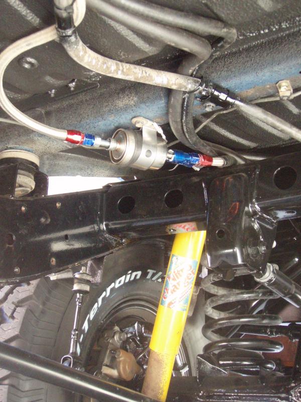

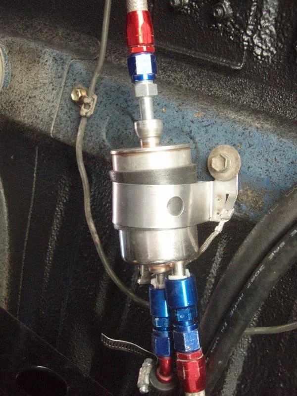

I got the filter at napa was $44 and the fitting where around $11 to $15 but they are so damn easy to assemble that you either forget what you paid for them or realize why you pay so much for them... so all an all around $90.. I only used 3 fittings as I had an earl fitting for the fuel pump....

The fuel pump does have the sending unit..as Im running the evap stuff but I havent found a way to wire it up to the stock fuel gauge so I just used the mech fuel sending unit......
You can buy a used electric fuel pump for cheap on ebay...
I made the mistake of buying a new one that was supposed to self regulate as my engine is a returnless (one plenum only) but it didn't....that's why I ended up using this set up......
