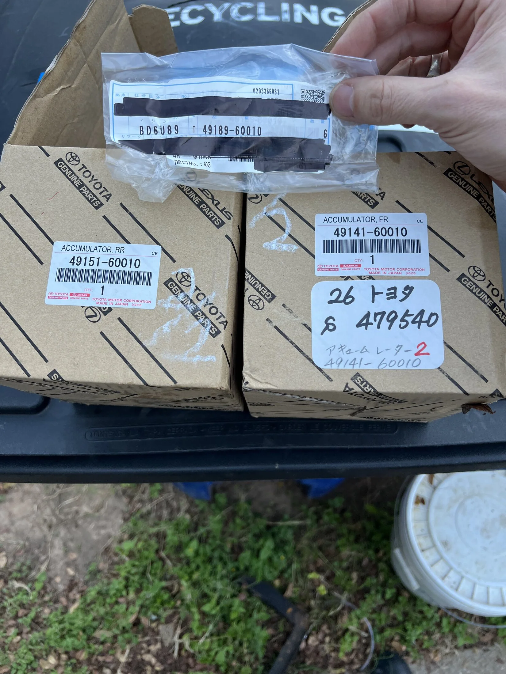

Impex is LEGIT 4 new AHC globes. Door To Door from Japan, less than 2 weeks

2005 LX with 113k miles, looking to change globes for maintenance as it probably needs them. Is it ever worth it to pull them off and do a pencil test, i'd need to bleed the system and waste a bunch of fluid right? So i figure i change them at the same time i flush the system.
Searching on Impex comes up with "no part found in our database" so i'm assuming it's out of stock, or should i be submitting a quote by email.
Partsouq is very expensive now, and megazip and amayama reporedly don't ship to the US, so that leaves me with eBay sellers, the two reported by other users still have globes available at a good price (600 for all 4).
Is this the best route to go at this point? I'm super distrusting of eBay and Amazon because i feel like people slap oem stickers on crap non OEM chinese parts and you have absolutely no recourse or way to tell. Aside from the packaging, would there be any other way to confirm the globes are OEM

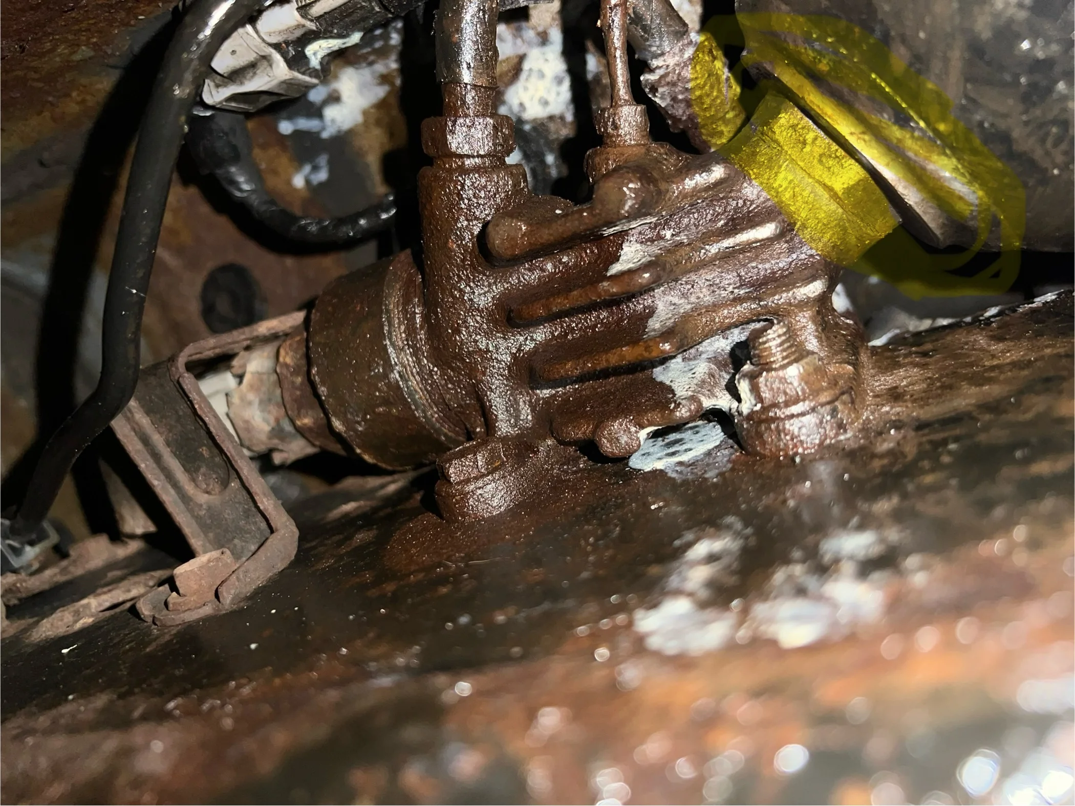

If I can’t get this rear driver side one off, I’ll sell you mine. I highlighted where it’s corroded together, been using PB overnight, torch next day, cranking at it to no avail.
It’s so corroded, and smooth that it almost looks welded together.
I’ll be ripping out the entire system and throwing Iron Man on it, if my buddy can’t get this off 😂
Finally got that last one off with the help of a friend and a higher powered torch than what I had..this job turned out to be a real PITA. Stay away from northeast trucks!
