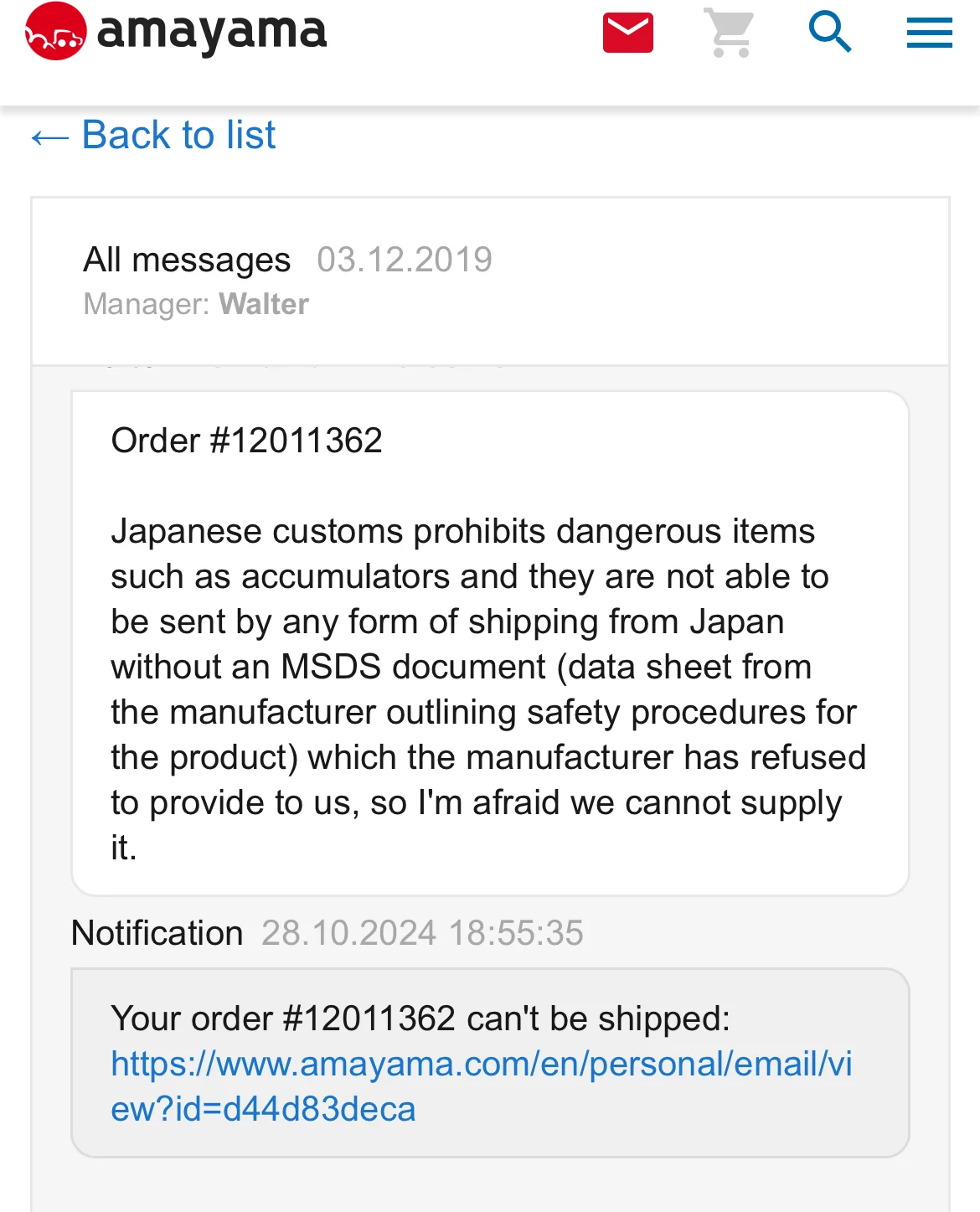

Amayama will NOT ship gloves to the US. I tried them before IMPEX (ordered 10/29 and still processing). Amayama is strict about the no pressurized shipping and sent a message that their supplier will not provide documentation for the import.
Figured I may save someone 2-4 days of dead time there by sharing.

Amayama will ship shock absorbers but must use FedEx for shipping.
Maybe have Amayama declare them as shock absorbers?

Here is the response I received when trying to order them through Amayama. Maybe at one time they had the required paperwork, but now they don’t.

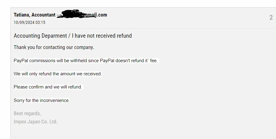

FYI , IMPEX screwed me over on a recent order (not globes)
I put in the order, waited, waited, and waited. Fianlly i reach out to ask what is going on , and they said the part is not available and I will be refunded.
I waited, waited, and waited soem more. No refund after several weeks. I finally reached out ( they hide their customer service contact very well) and I was told that I could only receive a partial refund because of "paypal commissions". So i am out over a month of waiting and $30+ because of no fault of my own.
At least i got some of my money back.
I won't do business w/ them again , extremely poor customer service

Sad to hear, last year I placed 3 different orders through them with 0 problems. Rubber seals/telescopic motor/random interior clips and such.

I had a similar issue with them. I ended up paying for PayPal fee for parts that they didn't have. That was the last order I had with them.

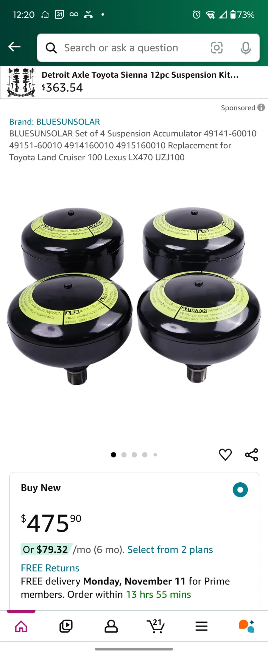

I am curious...have any forum members tried Amazon's China globes? Asking for a friend ;)
I read a lot about aftermarket and some people are changing them/failing after 3 months. I paid $435 before shipping for OEM. I’ll be another $100-$150 in shipping, but I’m ok with that.

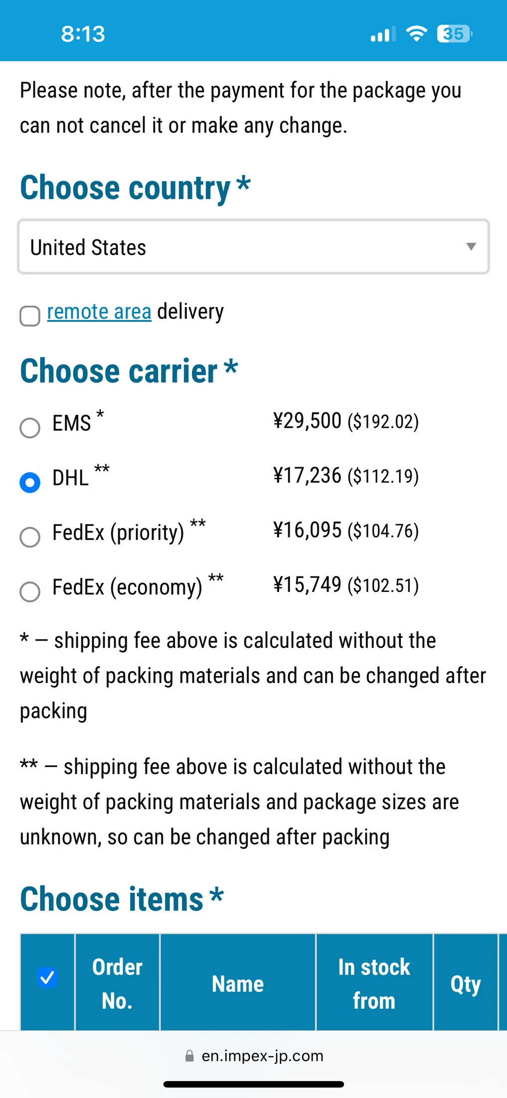

Got my email this morning to create my package. Went with the DHL option.
