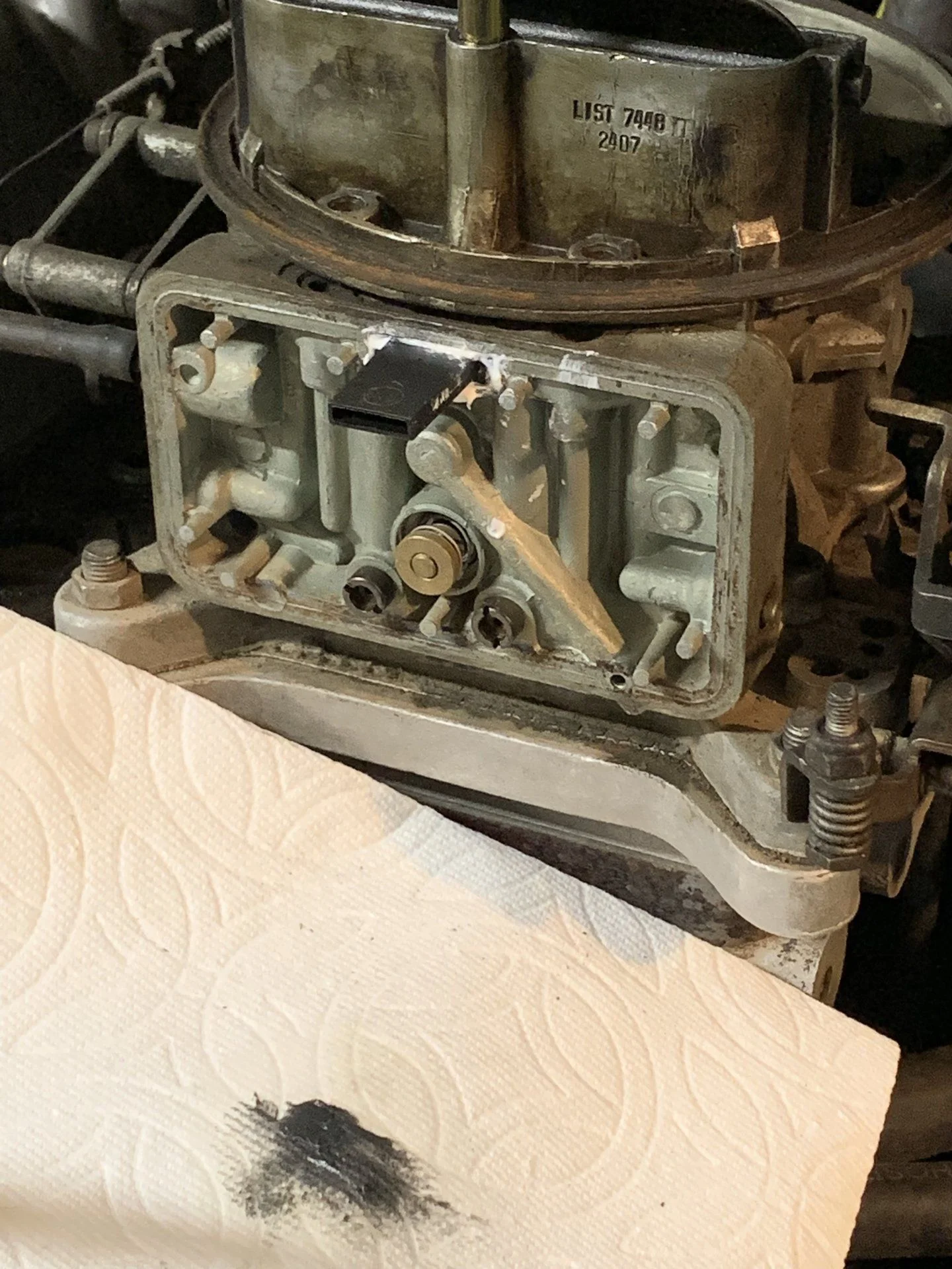

I have a Holley 350 2 barrel on my 1969 FJ40. I tried to take it over the Miller Jeep trail in SoCal but my pig just kept flooding and stalling whenever it got on an incline. I eventually had to get towed out.
I read up on the issue and found out I needed to baffle my carb. It seems silly to me that Holly would not design this into all their carbs. The carb floods on any incline. I could be in any car in SF and hit an incline and the car would flood as well. Not to mention if you have an electric fuel pump it would just keep gushing fuel out and it would be a major fire hazard.
I know I should probably get another carb but for $30 I thought I would try to baffle it and see what it does.

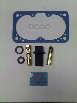

So here is my off-road kit. 1 baffle whistle, 1 spring loaded vale and needle, and one slightly longer vent tube.

I put some marine JB weld on the baffle to keep it sealed and in place. It says it is petroleum resistant. We’ll see.
Getting the old vent tube out was the hardest part. I couldn’t get a grip on it with my vice grips or my needle nose pliers. I carefully ended up using a reverse drill but inside the tube to get it lose. After it was out I blew out the vent and tapped in the new longer one with my hammer.
The spring loaded needle valve was interesting to install. I had to take my float valve cover off twice to to this right. You have install the needle with the float upside down so you don’t lose the spring. I took care to notice how many threads the old needle had exposed so I could adjust this one the same.
I still had a problem after the install. When I turned on my key and electric fuel pump I kept getting gas flowing out my main shaft onto the headers. I didn’t think that was safe.
I had to adjust my float down a little more to stop the flow of gas. I think the float was always too high but installing the baffle kept the vent open which allowed the gas to keep coming.
I think I am much safer now. And hopefully ready to OFF-ROAD!
mrtodds, the Holley 350 float bowl baffle and chimney kit have been in my ebay store forever, see ebay #254041028091, especially pay attention to the 3 drawings with the photos. This is a 1,000% cure all for the Holley's:
1. Use JB Weld to install the whistle tube, it seals around the edges.
2. Make sure you don't have a blown power valve, common Holley problem.
3. Check ebay for a Holley #125-207 (extremely long shot), it's a dual stage high altitude power valve, and boy does it work- - -I had a screaming hot rod at 8,000 ft.

The spring loaded needle valve does nothing for most off road/off camber/incline angles. They are primarily intended for float bowl "bounce" on studder bump flat dirt roads (which Baja is full of, ala south of San Felipe). I believe a slightly better choice than Wizards choice above would be to use my ebay #254041028091(listed in my post above) because it includes the float bowl baffle, and a much taller vent chimney. Then if you are lucky enough to get ahold of a Holley #125-170 high altitude dual stage power valve, then you have solved all of the Holley float bowl issues, plus set the carburetor up for fantastic running in 5,000 to 10,000 ft. altitudes.
So, I've said before, and I'll say again; the only guys who didn't like a Holley 350 in off road terrain didn't have their float bowl set up properly for off road use, and those who did loved their Holley- - -easy deal.

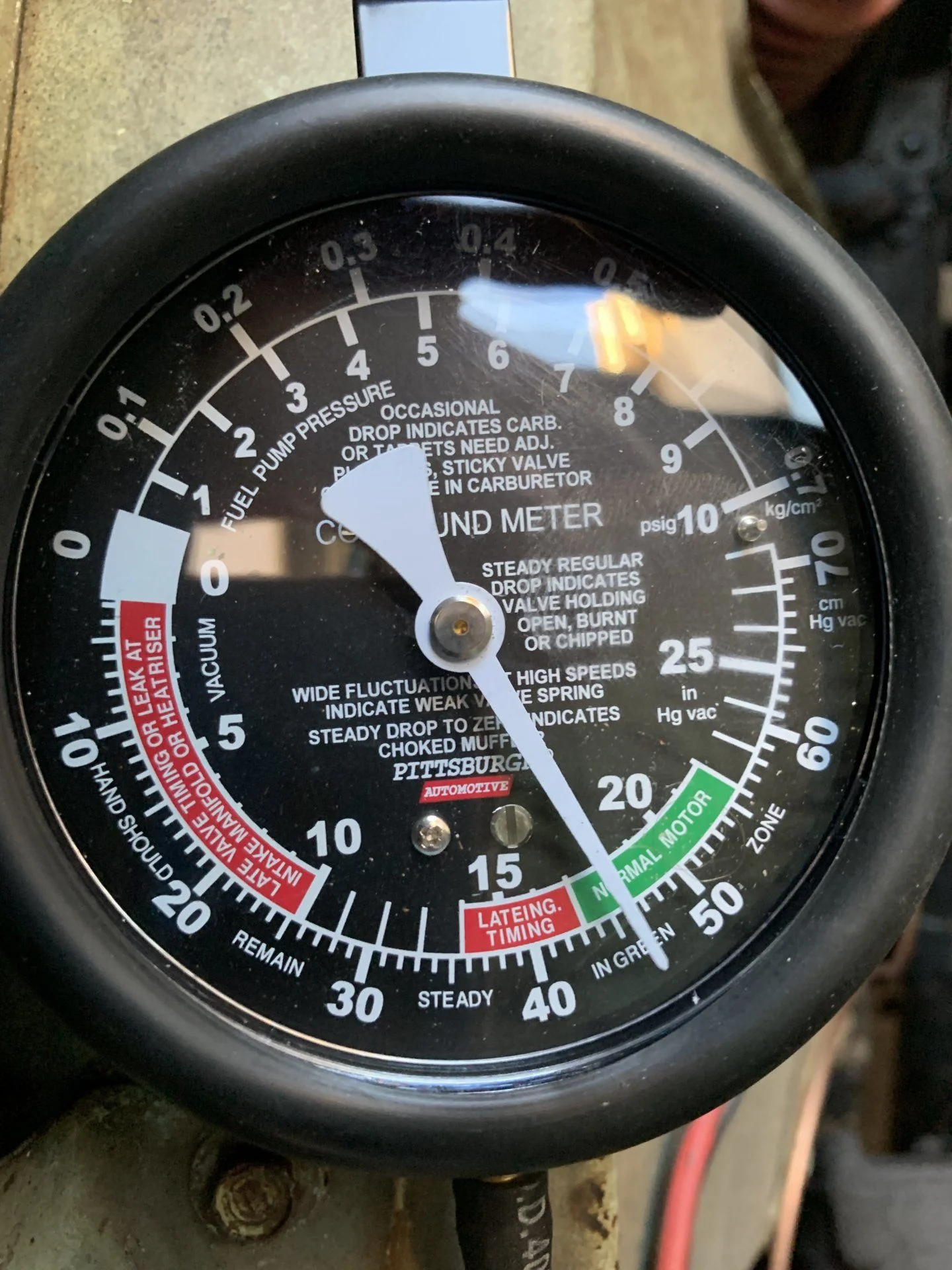

Downey, I think my power valve is ok. But I will do some tests. Do you know of a good test to determine this?
Yes, slowly turn in your air/fuel mixture screws, if power valve is good engine will start to die, if power valve is blown engine will just keep running since it is not shutting off the flow of fuel. 1992-older Holley power valves could blow out with an engine backfire, 1993-newer power valves have been improved and won't blow out if engine backfires.

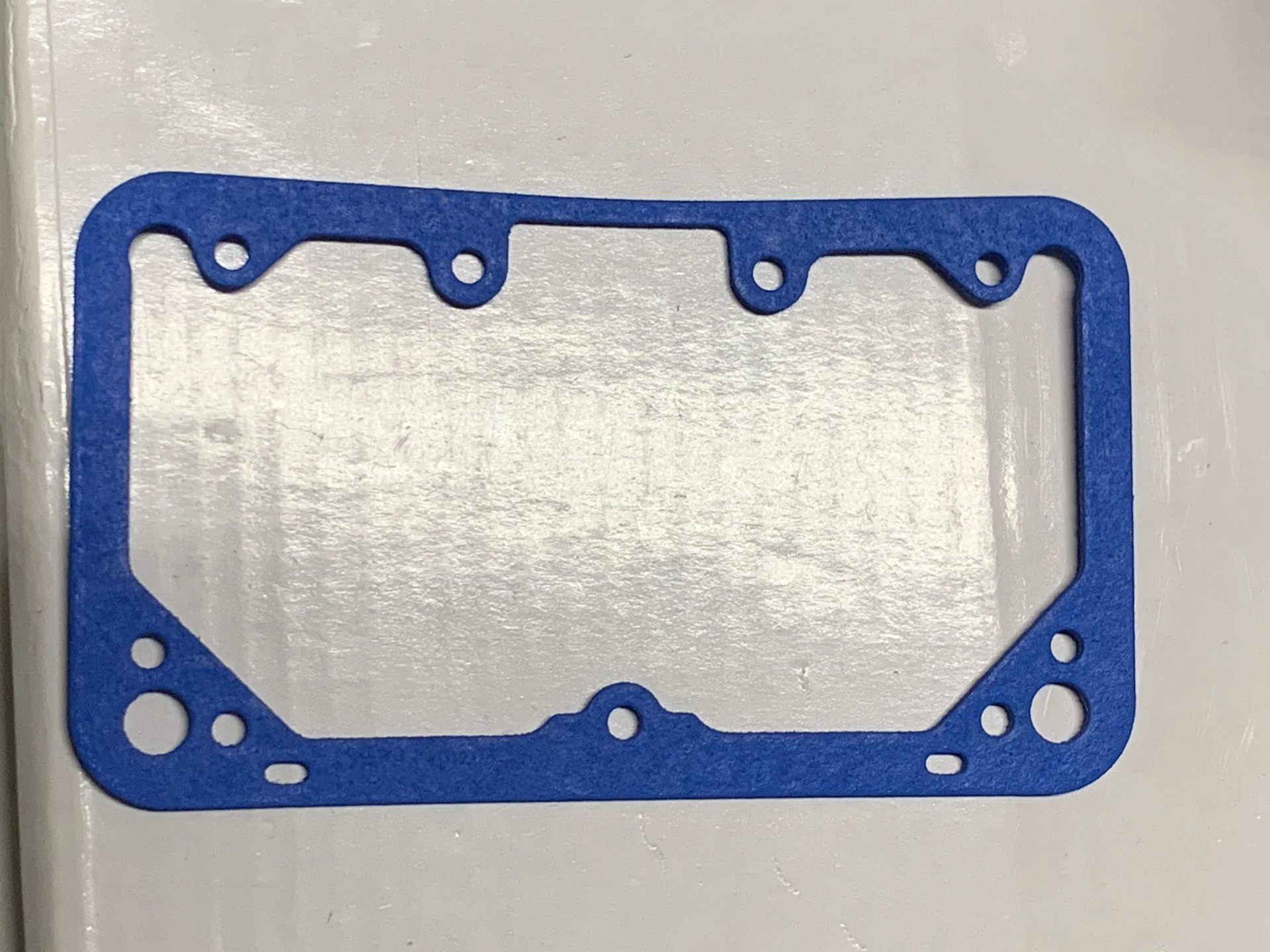

I did find a power valve 125-170 on eBay for about 45. I do want to go off road at altitudes like rubicon so I may install that as well. Is the install straight forward? Or do I have to take everything apart?
You merely unbolt the float bowl (4 screws), pull off the metering block from it's dowl pins, then unscrew the old power valve, install new power valve with new washer gasket, then possibly need new gaskets when re-installing the metering block, float bowl, and 4 screws.
I checked my manifold vacuum and adjusted my HG until I got to 18 HG. It was only 1/2 turn up from closed on both idle mixture screws. So I think that means I need a power valve that opens at 9 HG. The 125-170 power valve recommended by Downey has the first stage open at 9 HG so that sounds about right.
