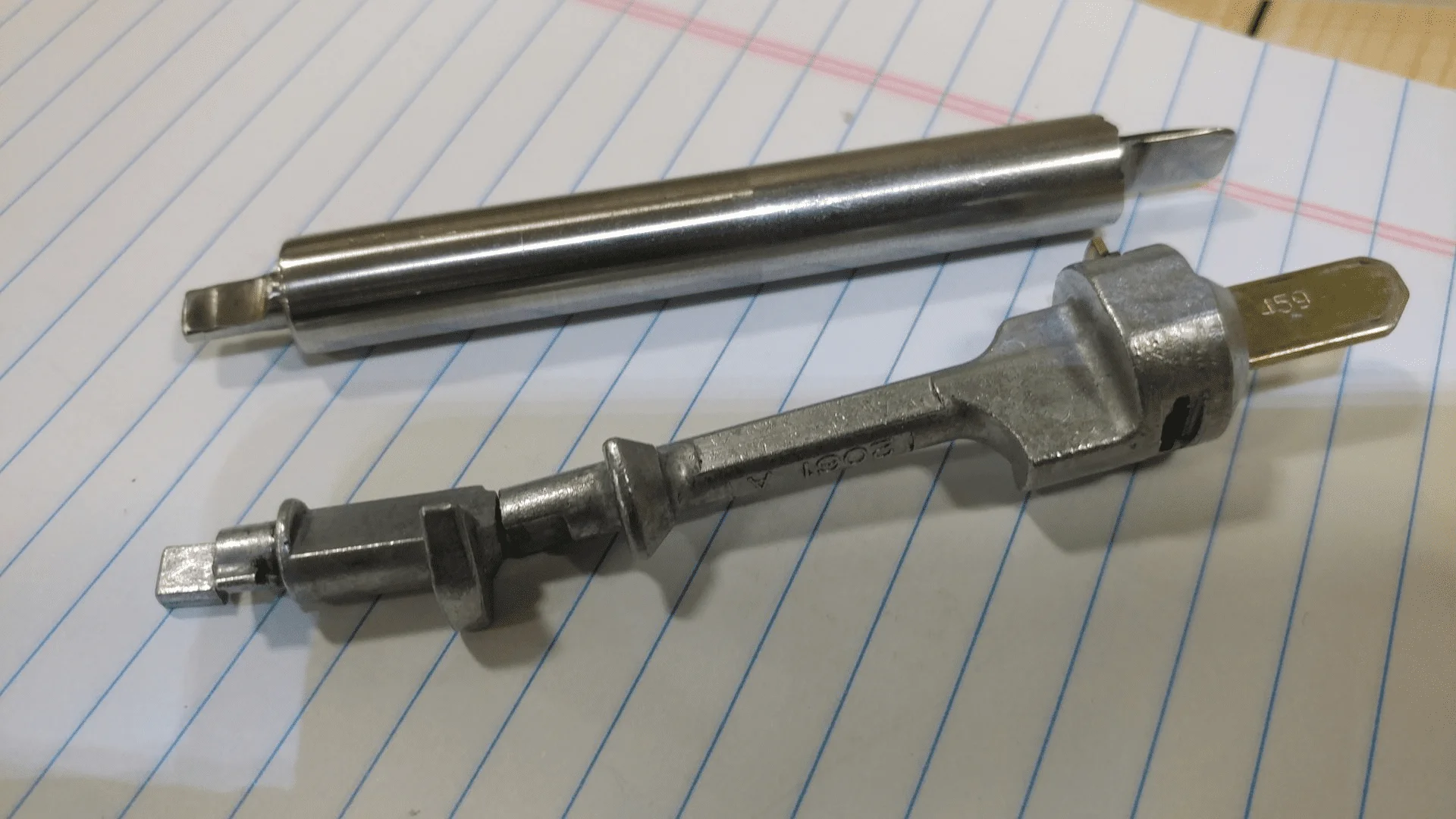

After reading a horror story, I am thinking about replacing my Ignition Rod before it breaks. I am not currently having any problems but, my 2001 LX has 122,000 miles.
Do you all think that is a good idea?
If so, what is the best rod that I can buy?
Preemptively replacing a working ignition rod, with basically the same type rod, seems kind of silly to me.
The best solution, that I've seen for the problem, was made, not bought:
( Picture stolen from this post Ignition switch broken...help?! )
