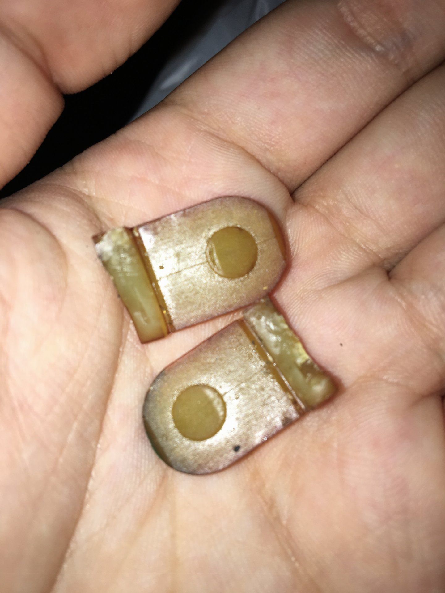

Part Number: 90541-06063
The remains of the old one are probably on your carpet :)
Thank you! I was struggling to find this part number anywhere else.

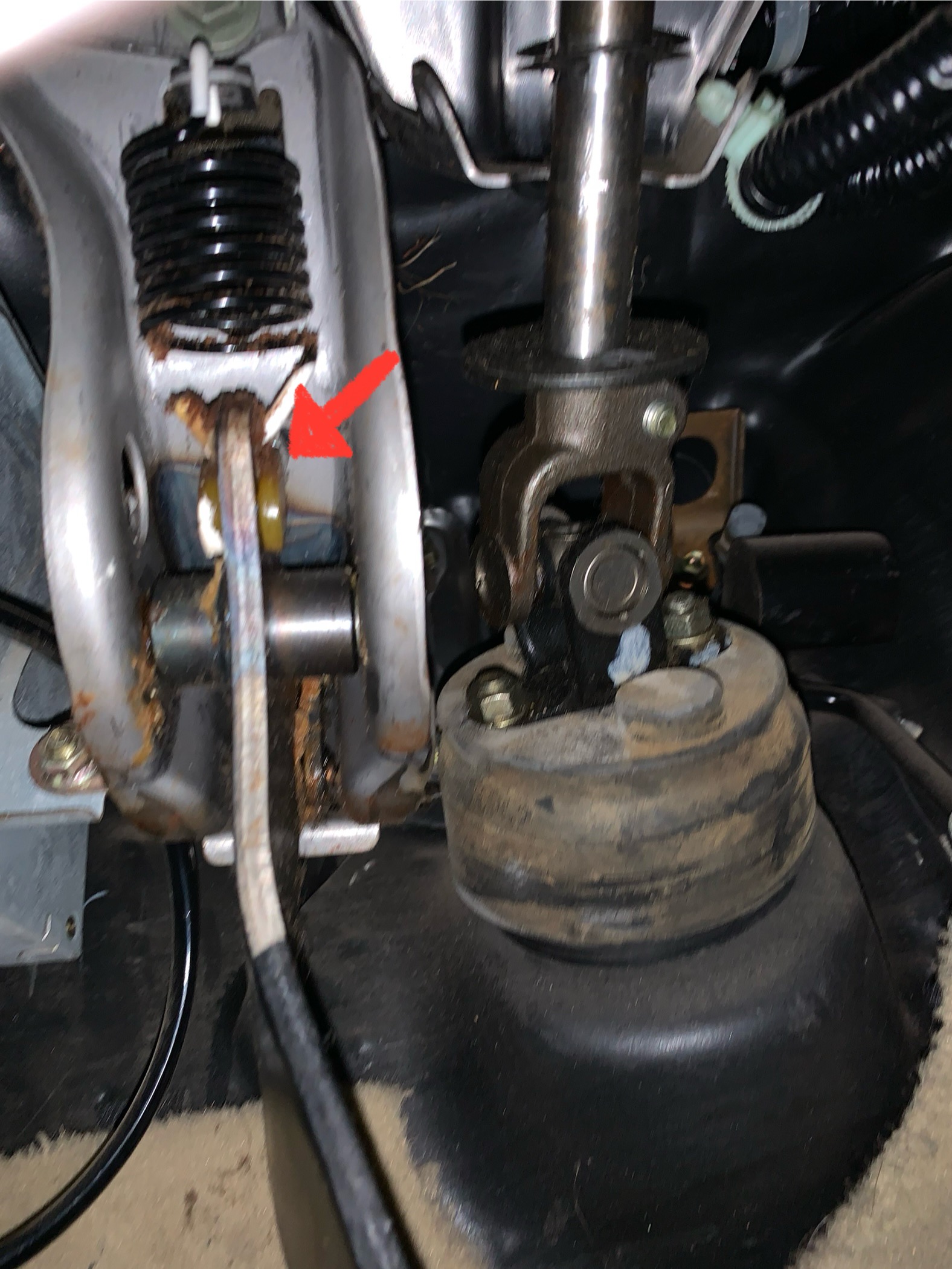

Does anyone have a pic of where this is located on the brake pedal? My brake lights are stuck on. I have the battery disconnected. The turn signal relay seems to be okay.
lol

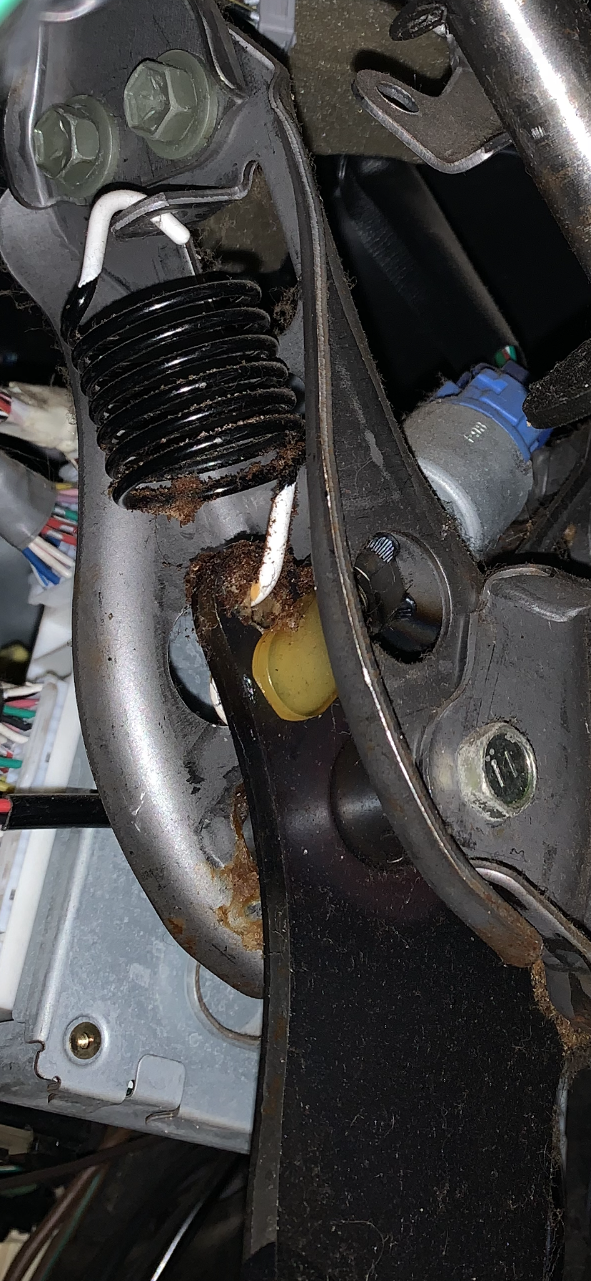

I found the parts on the floor...i see where they go now. Just on top of the brake pedal there is a cylinder with a nipple coming out of it. If you press the nipple in, the brake lights go off. I will take a pick in the morning.

The U shaped part wraps around the top of flat brake bar.
