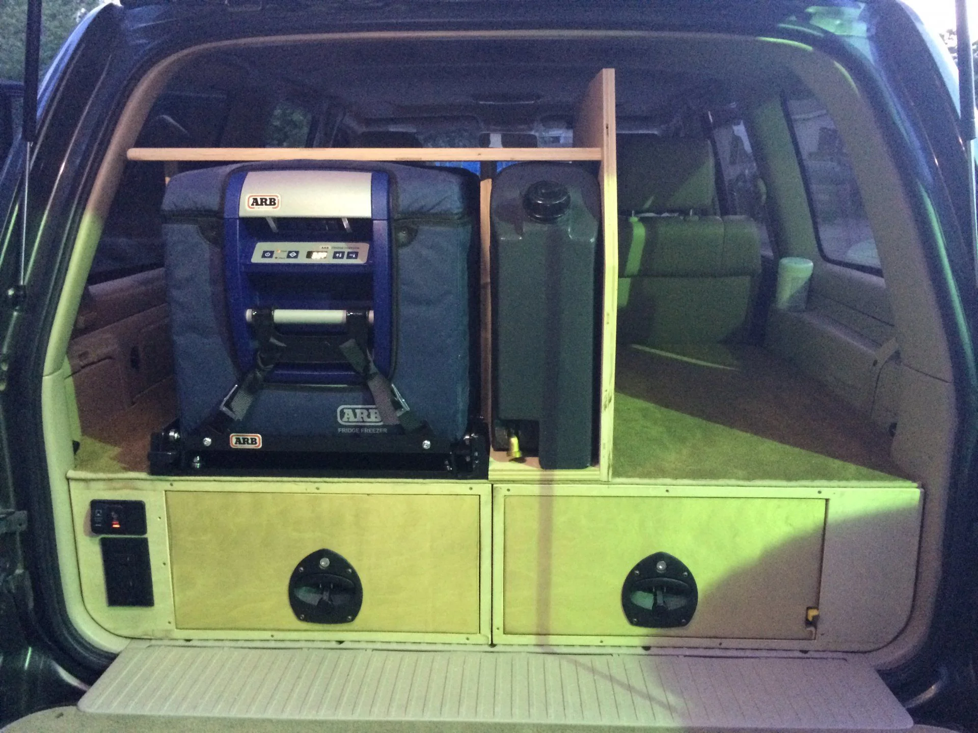

I built this setup for my 100 as a proof in concept and never got around to redoing it. Will build a much nicer version for the 200 here in the shop once things slow down in a few months. We love the water container put the fridge is too high. @ntsaint and the Trekboxx setup have a great fridge height, especially for the 63qt model.

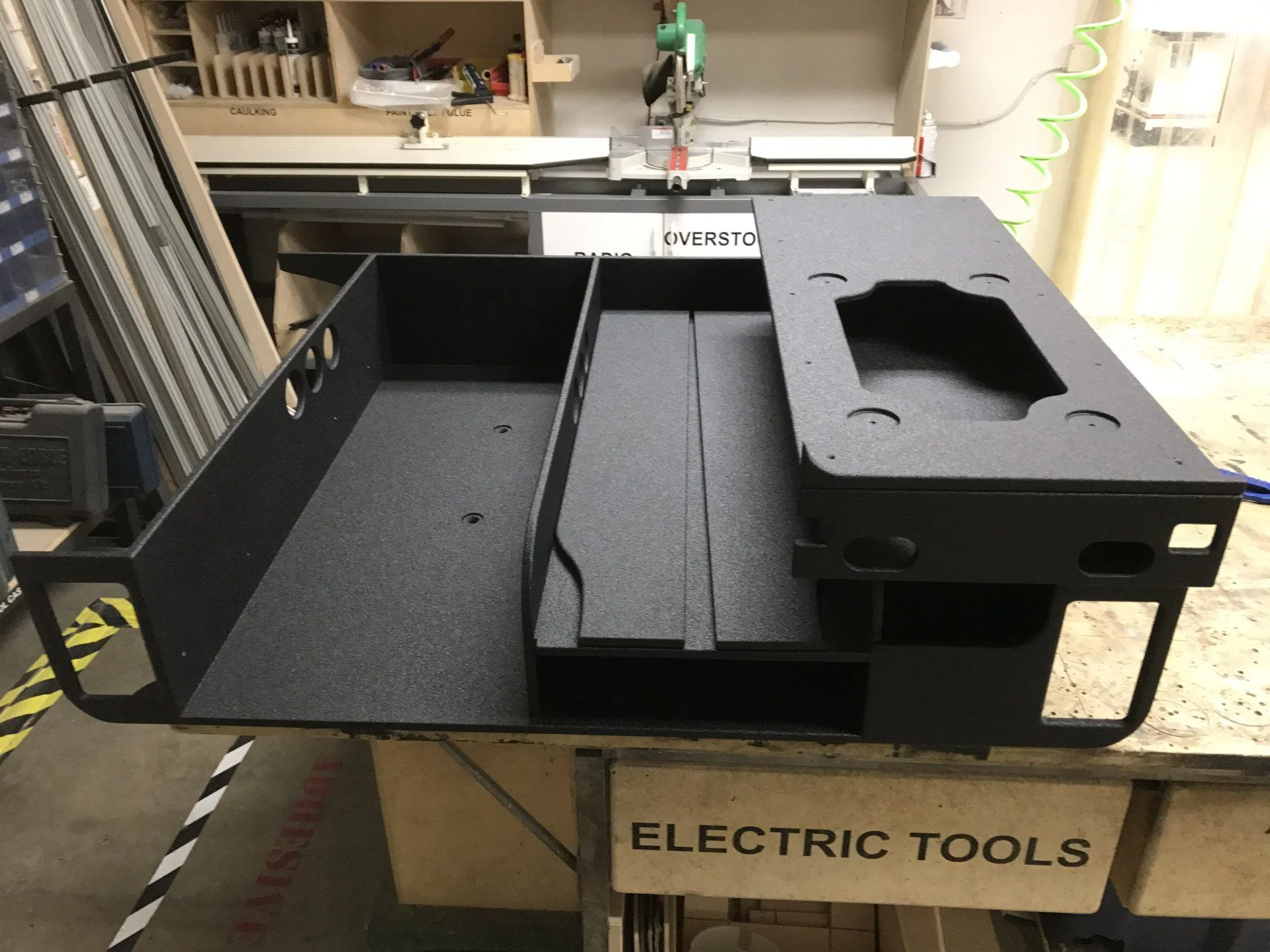

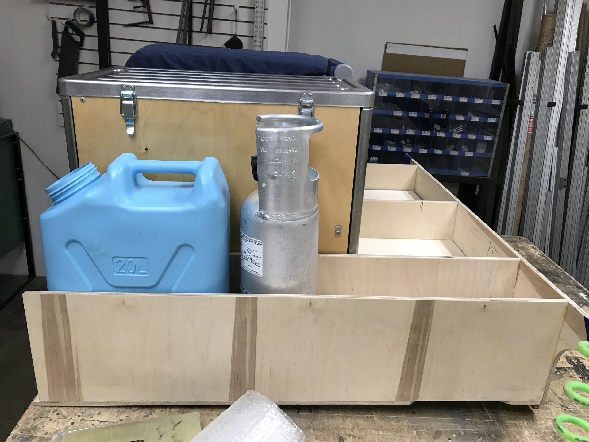

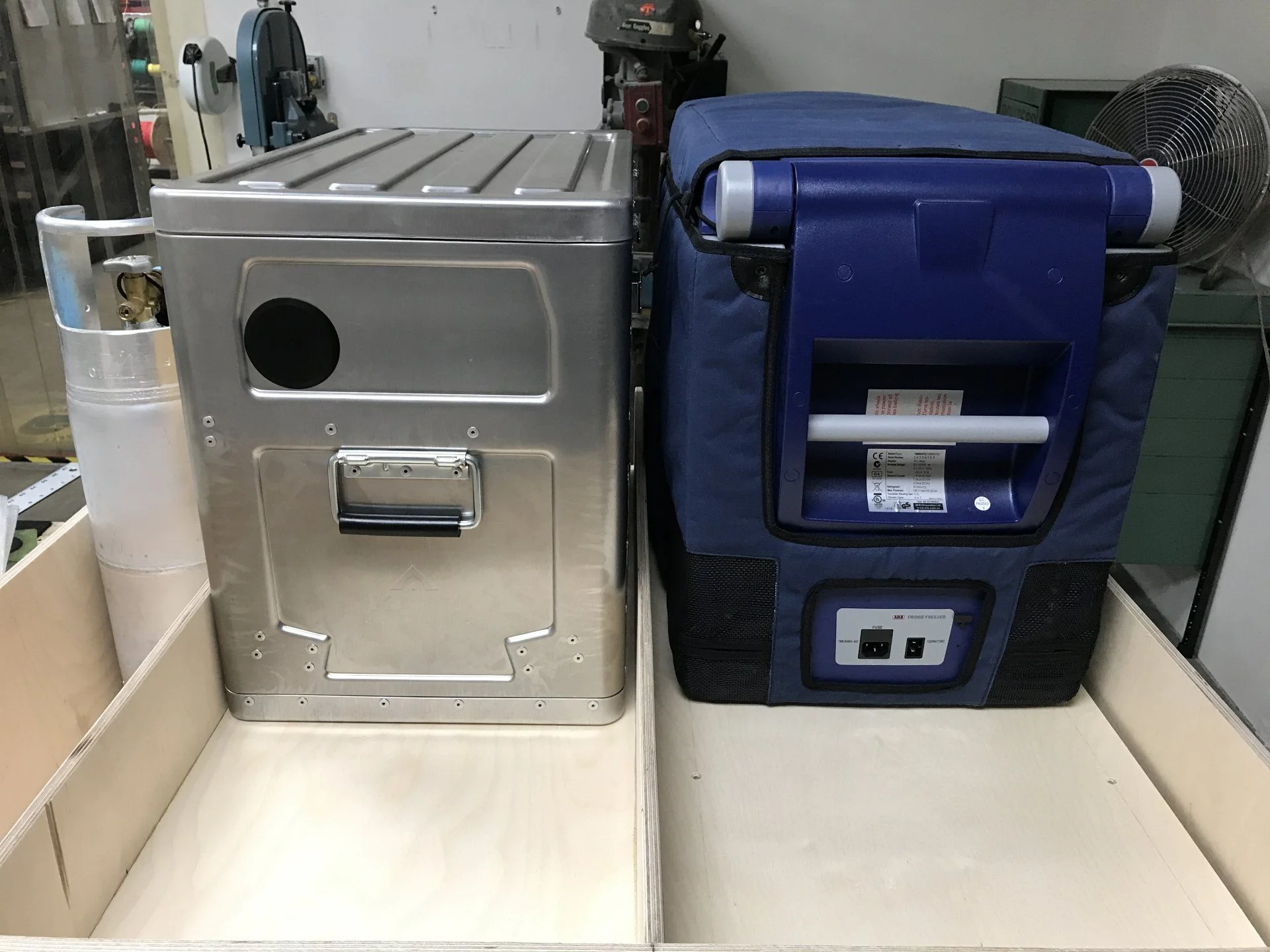

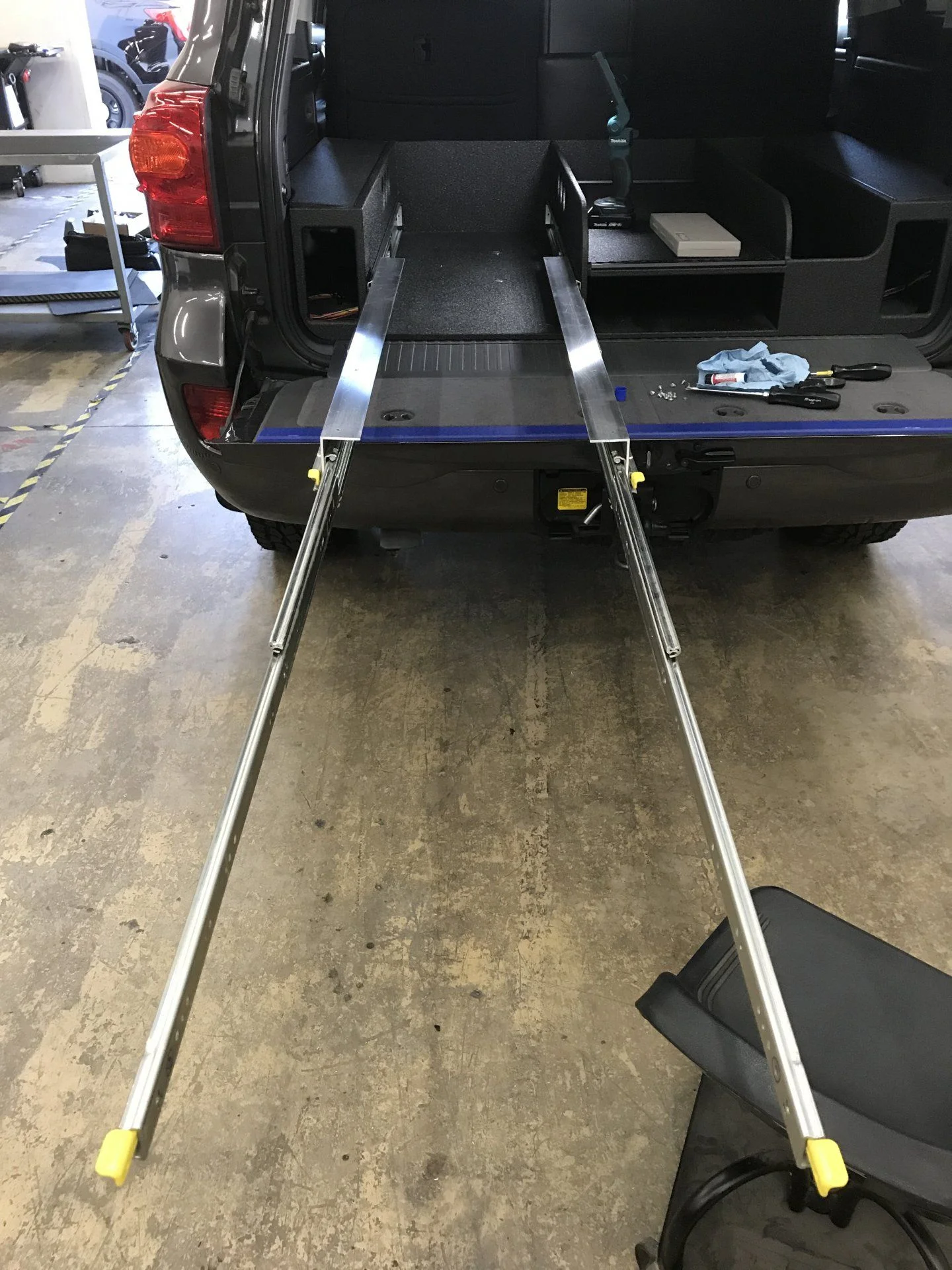

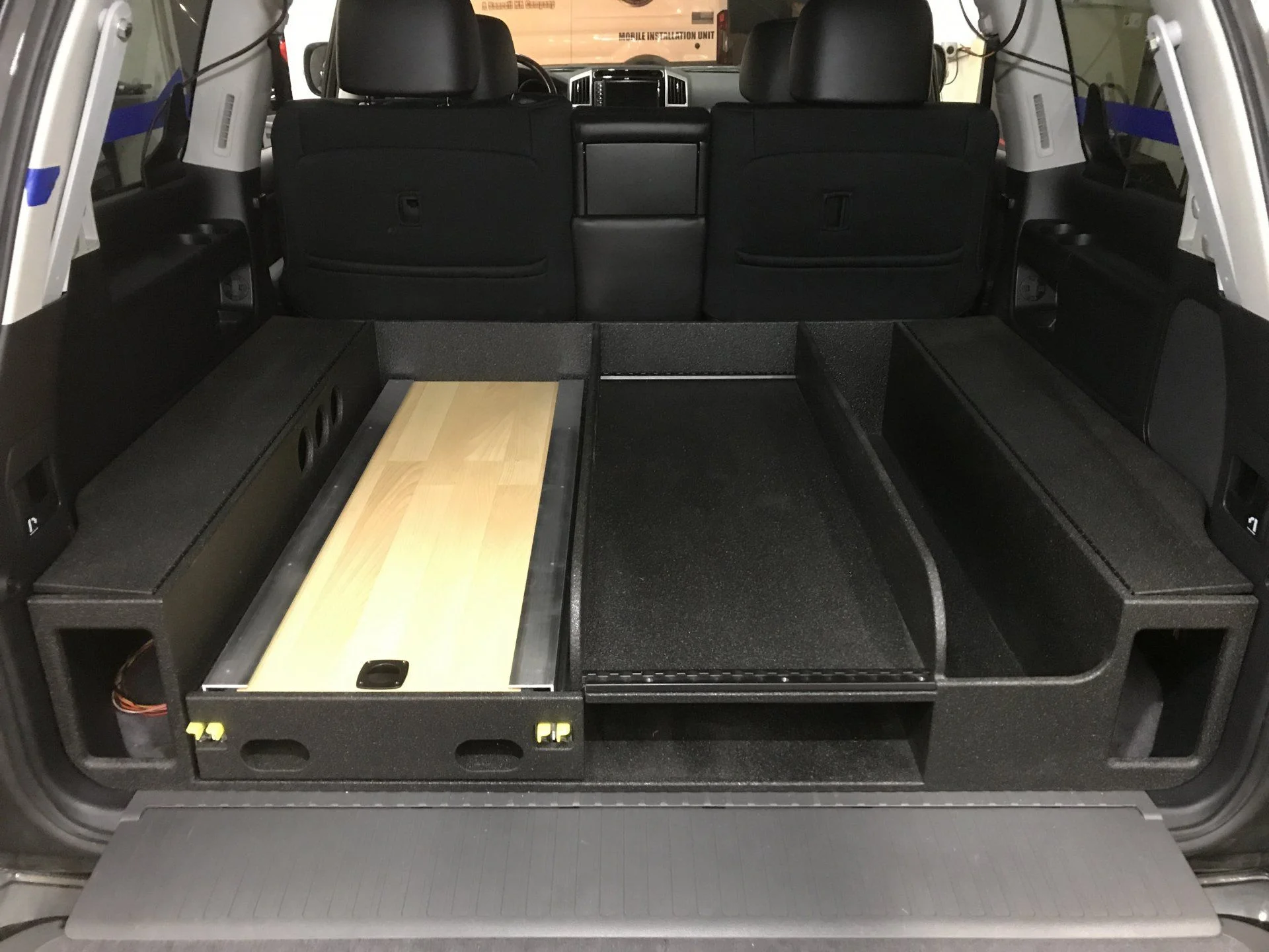

Thanks and well, since you asked... As you can see, the design morphed slightly from concept to reality, but stayed pretty close to the original intent. I just apologize for being so pathetic posting updates:rolleyes:
More...
More...

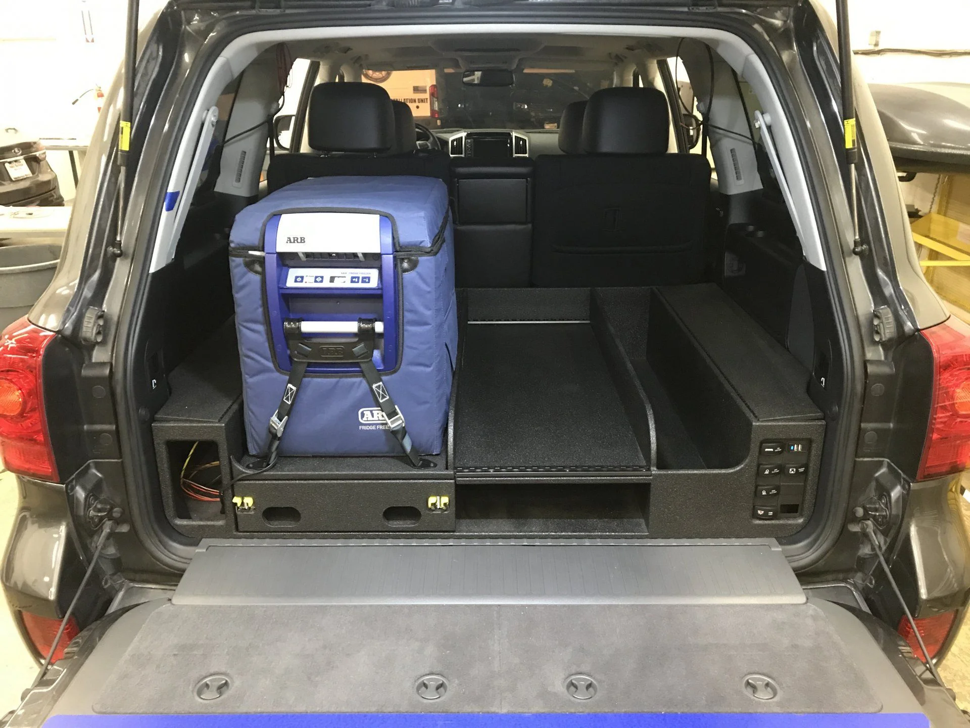

Thanks:D we had the pleasure of taking it out for its maiden voyage last week. Very happy with the functionality of everything. Next up??? Attic:bounce:
Congrats that turned out nice
Really a beautiful build! And some interesting adaptations there I really like, such as the can storage... What would you ballpark the overall time and dollars to build it?

Well done! What's the finish on the system?
Line-X

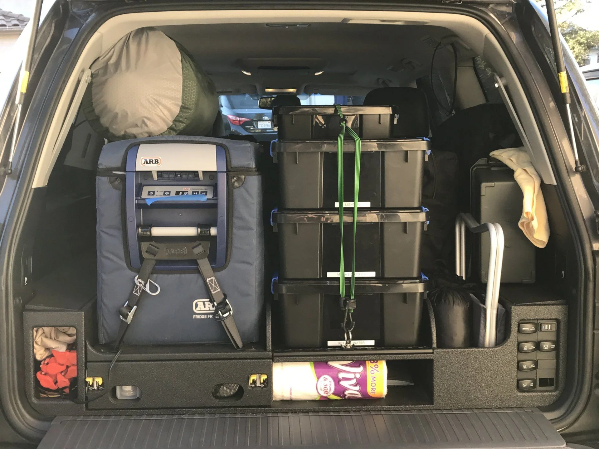

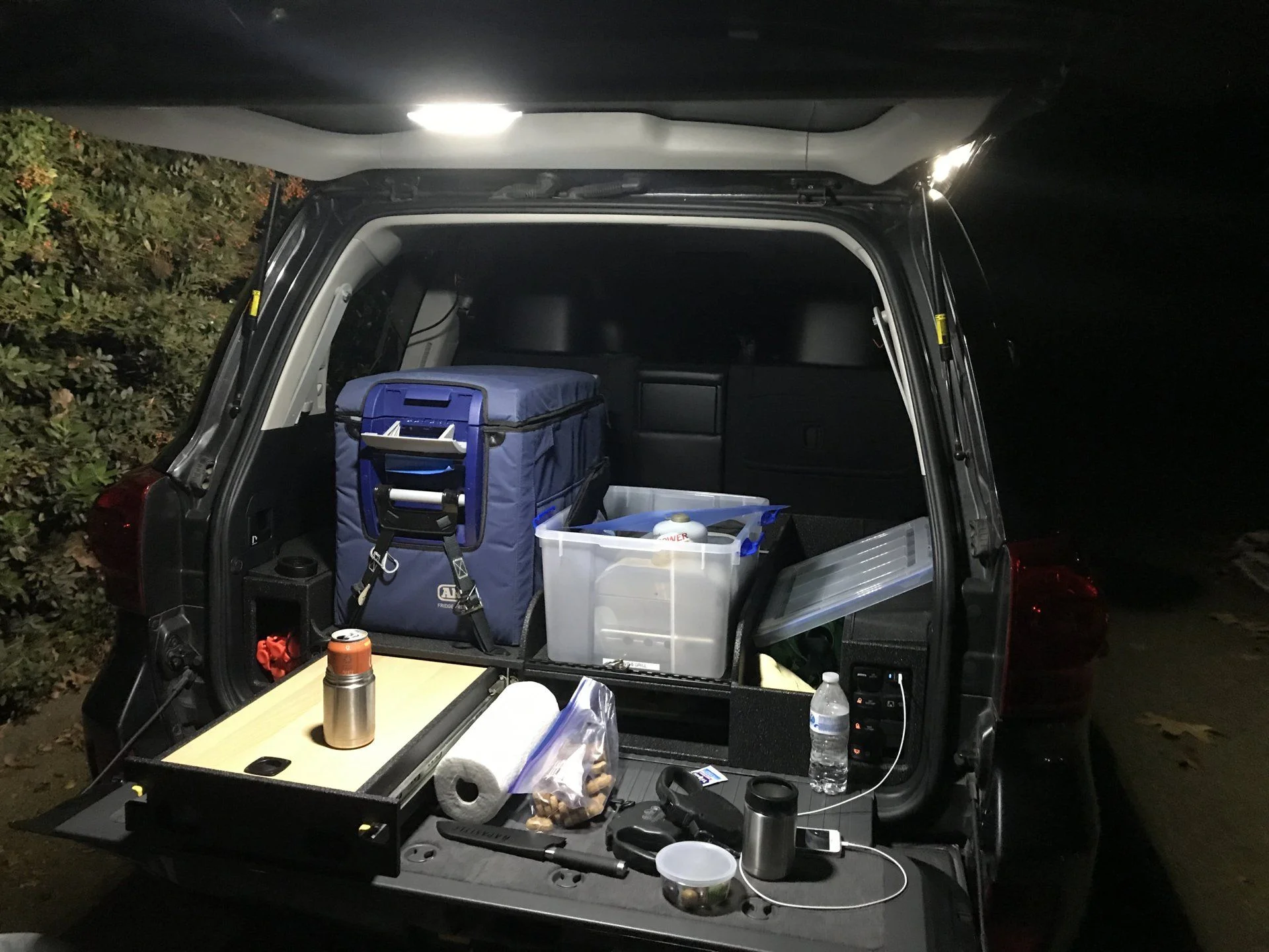

While acknowledging how pathetic I am for not being done with this project yet, yet, yet, here are a couple pics loaded up:D
