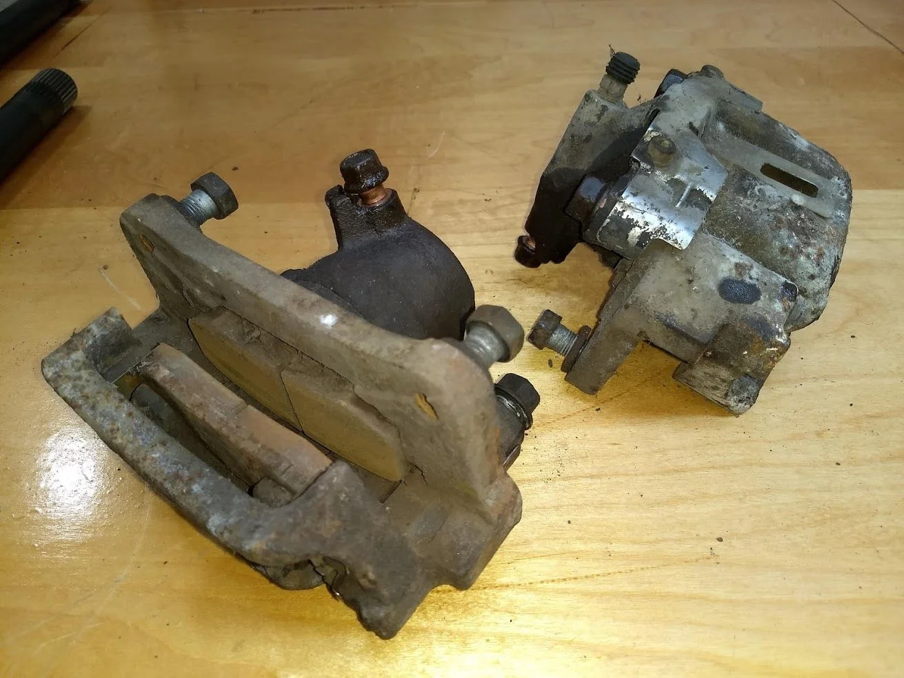

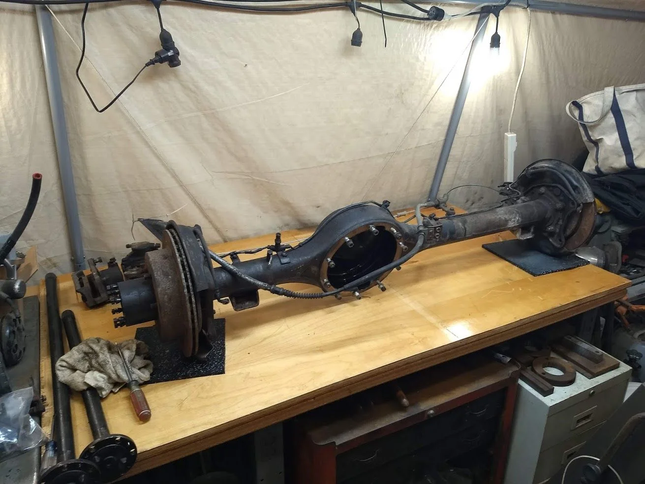

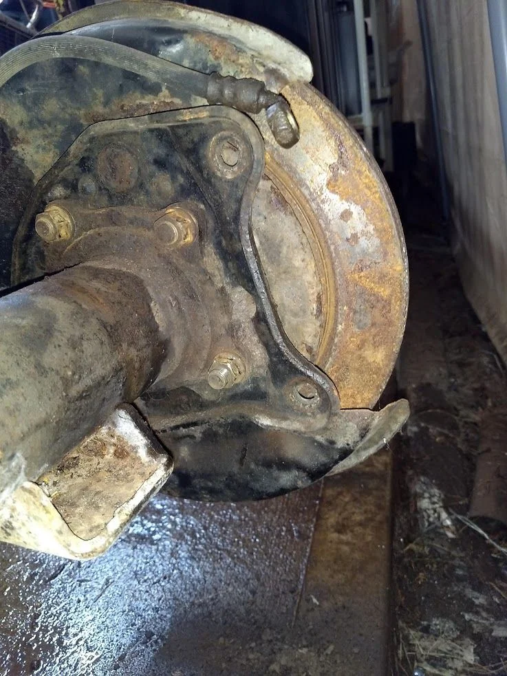

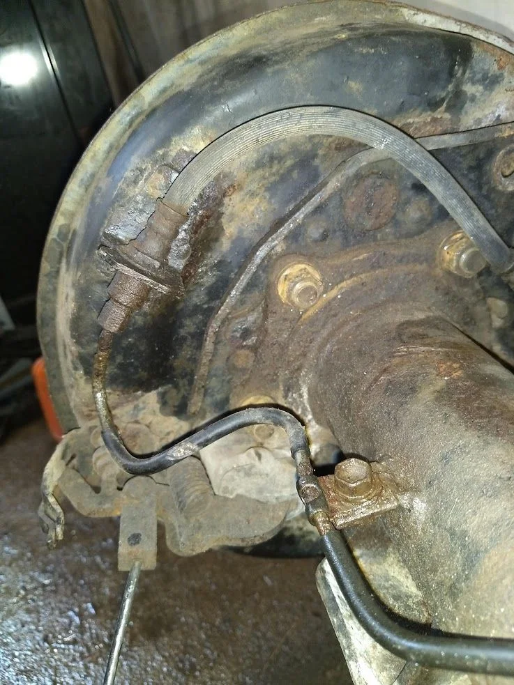

So a few years back I bought this axle and I am finally getting around to cleaning it up and rebuilding it. It will, of course, be far easier to source parts once I am sure what it came out of.
It is a full float 70 series rear with disc brakes (and parking brake)
I'm going to try to dig up the original purchase info but I suspect that is long gone into the interwebs trashbin.
I found this info from @joekatana a while ago... I imagine this is factual?...
"1990 to 1997 from a HZJ73"

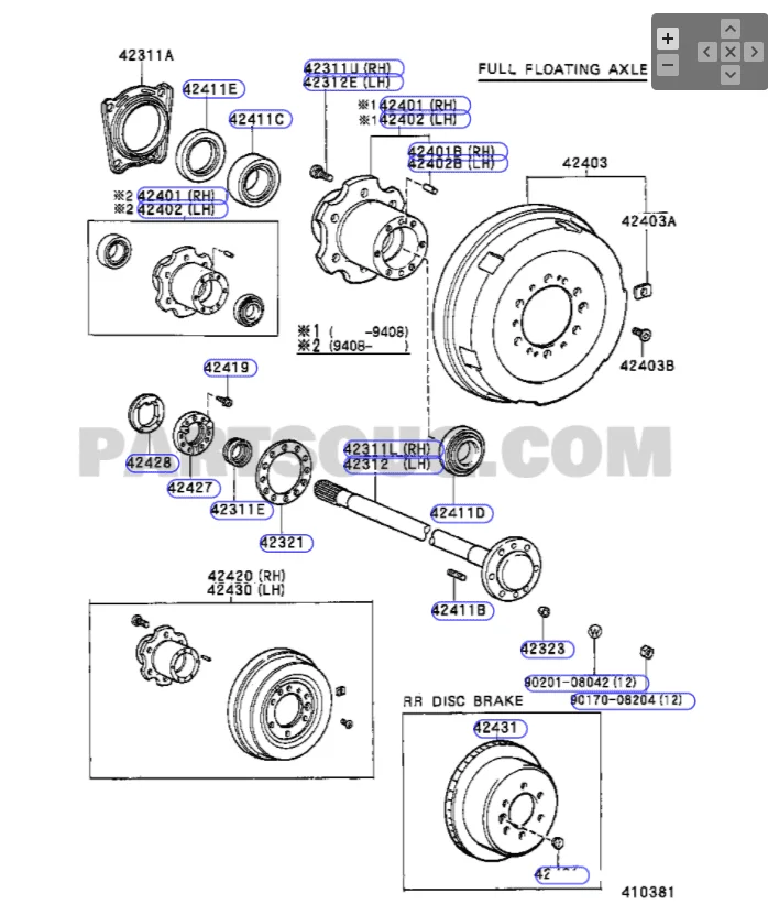

And upon doing the research I should have done in the first place:
this
Maybe this is it:
LAND CRUISER S/T,H/THZJ77HV-MEUFJ75,LJ7#,HZJ7#,PZJ7#,KZJ7#04.1990 - 08.1999ATM,MTM: MANUAL TRANSMISSION,5-S
Hmmm, makes me wonder if it would be possible to adapt those disc parts to an older
BJ74 FF drum rear axle?
That sure is the implication from the drawings, showing the same axle and parts with just the drum vs disc difference....
I was thinking the same thing once I saw the backing plate.
Let me know if you want any measurements while I have this apart.
