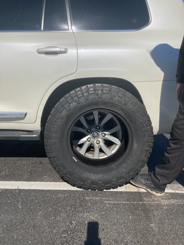

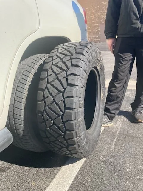

I'd love to see pics of 285/70/R18 set up on LC200
285/70/18 mock up…

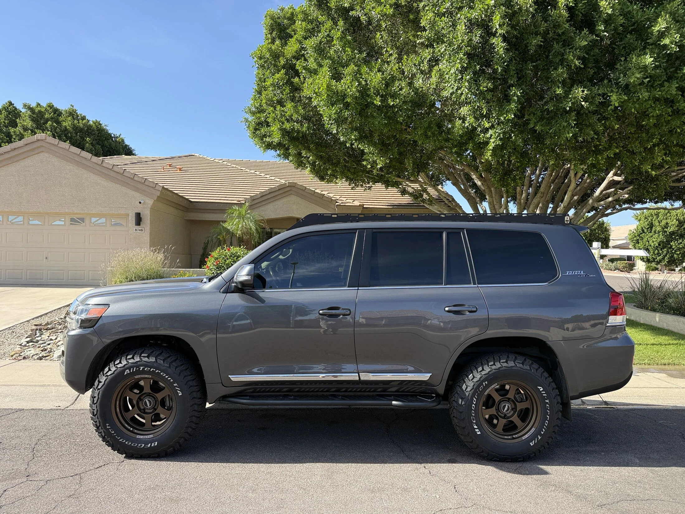

Yep, @kreiten used to run that size on +20 offset wheels. Check out the earlier posts in his build thread. I think he had BFG M/T's because there were very few tires in that size at that time.
My 285/75/R17 are basically identical (within 0.1") so my experience should approximate what you'll find as well if you run factory wheels and 1.25" wheel spacers.
Anyway those will fit the rear wheel well fine, spacers or not. It's only the front where you'll have to do some work

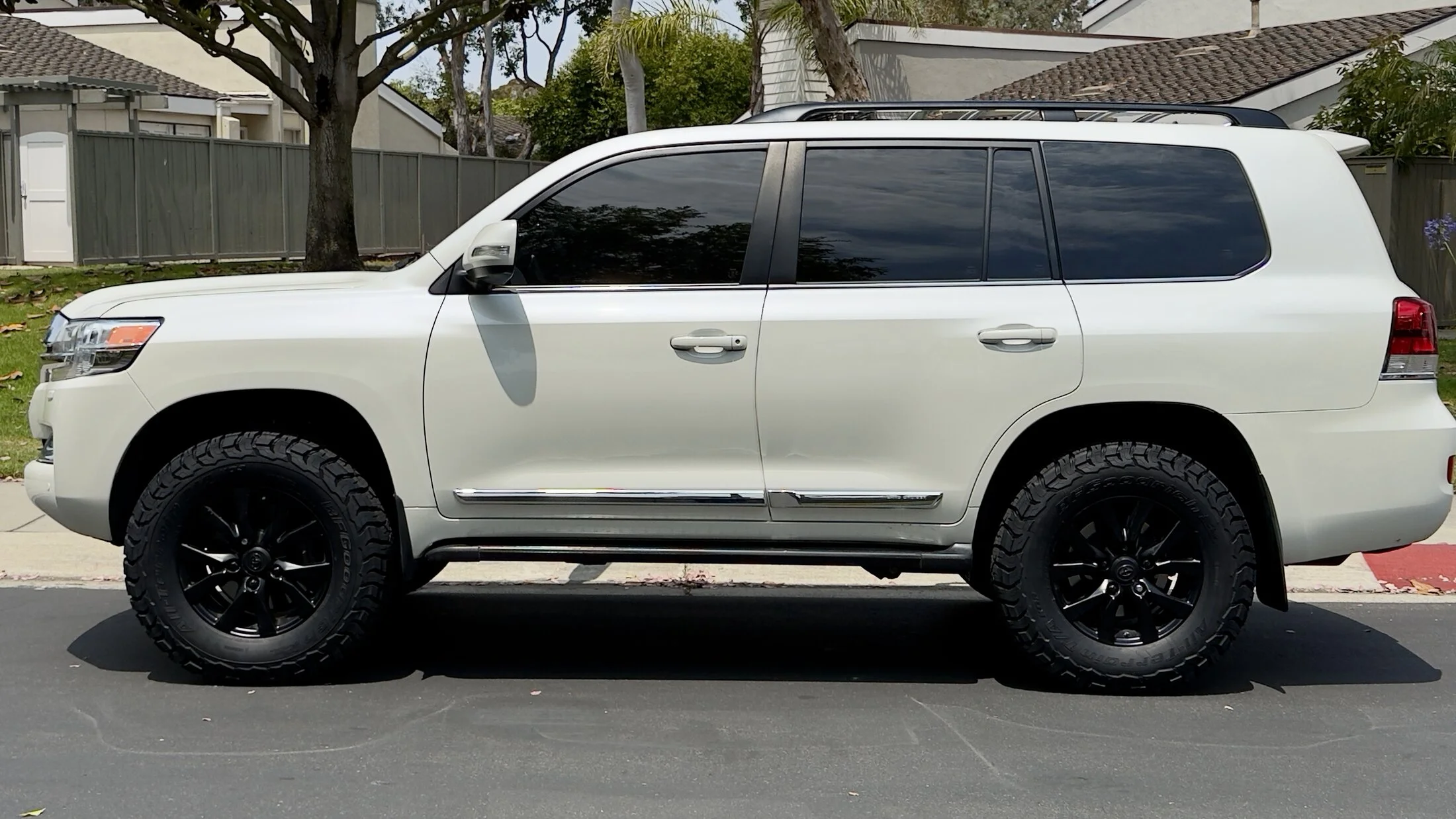

I will be doing that in the next few weeks on my existing stock rims + 2” dobinsons lift + 1.25” spacers + front mud flap delete. Will post pix!
Dust off on this thread: BF Goodrich makes the AT KO3 in 285/70/18
Just got the KO3s... They look much better in person! They are quiet and fit just right (I already had pushed fender liner forward and trimmed mud-flaps a few years ago...)
