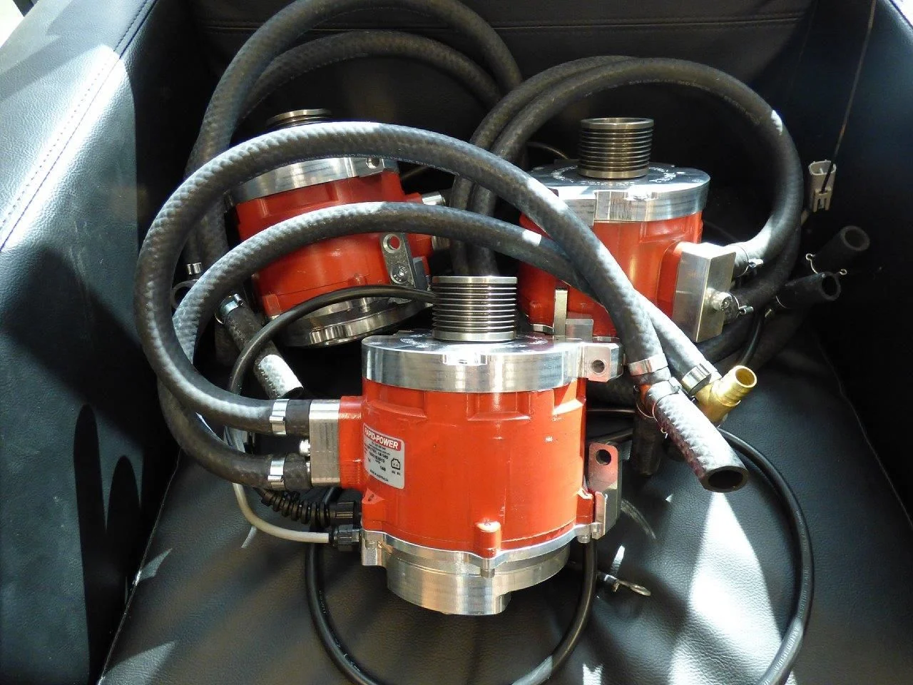

1VD
Sold by Perth Diesel Performance.
No 3UR option that I know of.
Also, they're silly expensive, $1700USD. You can buy a lot of spare alternators for that much.
